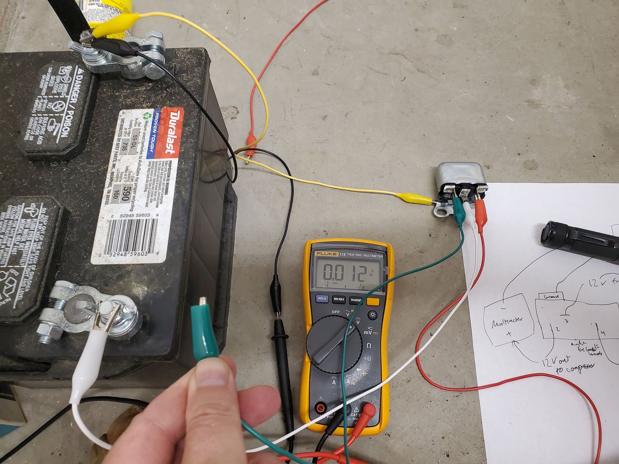

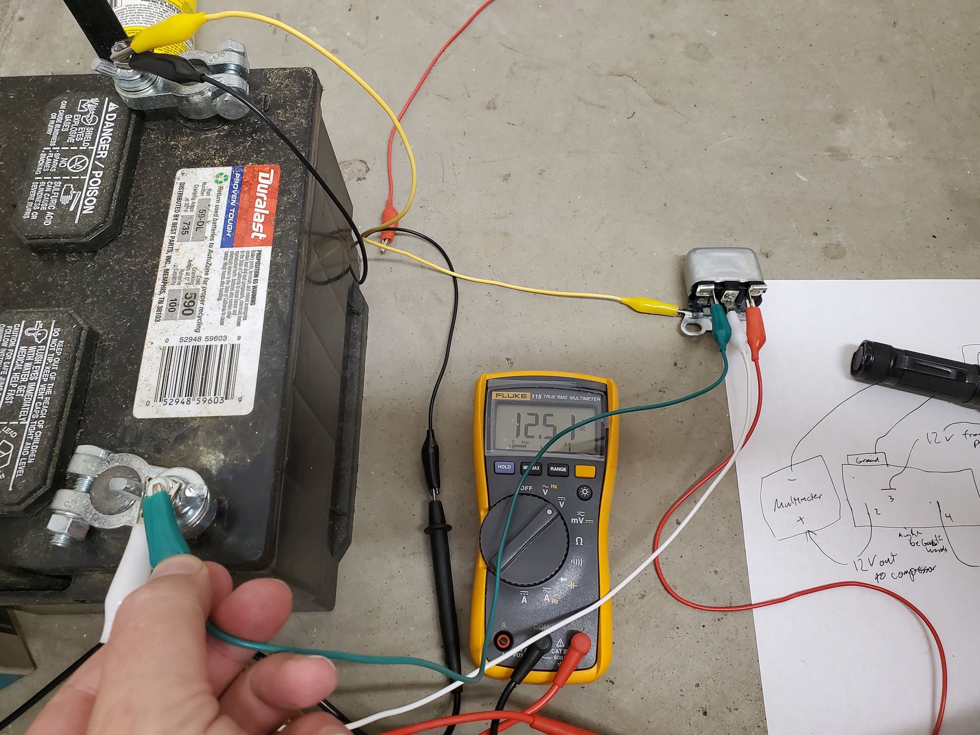

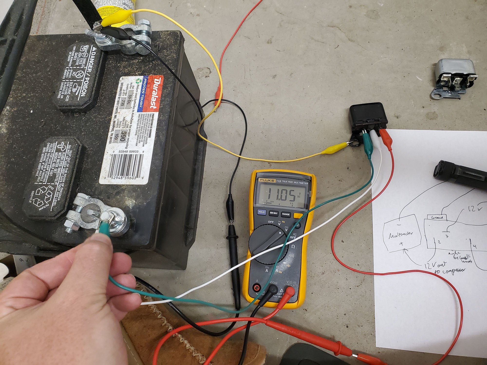

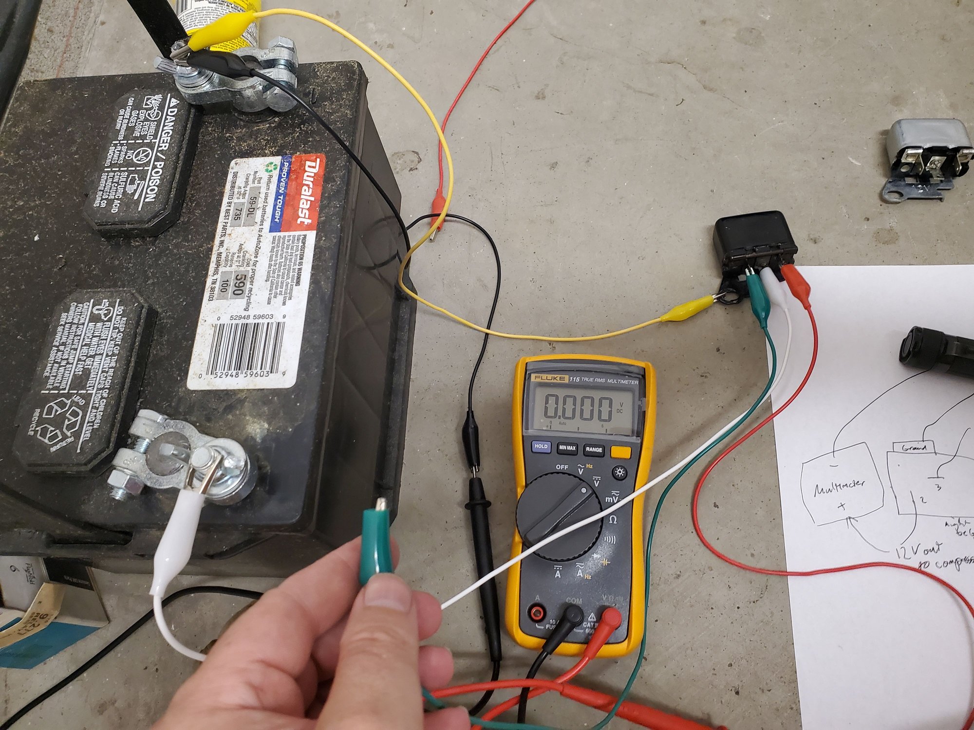

Last fall I ran into an undesirable behavior. In AC cars, from 68-71, Olds decided that there should be AC on in defog and defrost mode. However, the head unit would give power to the clutch for the compressor only in Max and Norm. They fixed it correctly in 72 and made the head unit kick the compressor on in defrost and defog, which annoys me as I go from off to vent in my 72. What they did in 68-71 is, via some electrical magic, latch the power onto the clutch if you engaged the AC compressor in max or norm, and it would stay engaged until you shut the engine ignition off.
This was done with a modified relay. Like the horn, when you complete the 12 volt control circuit, the relay closes its own circuit as long as you keep yours closed. In other words, horn makes noise when you hold button down. Similar for the AC system, you switch on the AC on the dash, it sends power to the relay, which closes a circuit sending bigger current power to the AC clutch, and the AC is on. What they did was use a hold-in relay that, once it is on via your control, it uses the power side to keep your control on, even if you shut if off. It would be like your horn staying on after you hit the button, but at least you can turn the key off on this one. I don't like this because I use the cars primarily for short drives and I will run the AC to make it work, but then I want to shut it off and run heat and dry everything out, and then I want to floor it and I do not need the compressor running the whole rest of the drive.
There's a great writeup to using a normal relay and a vacuum switch to get all the original function. I just want 1967 function in my 68. So, the difference in a hold in relay is an extra link from the output of the power side, back to the control input. Thus, when the relay outputs power, it self powers your input via the extra link. The solution: remove the link. These relays have them on the outside, as you will see. So, I needlessly took the covers off, and had to put them back on. Then I removed the link.
In this first picture, I have the original relay. Yellow and black ground the relay and the multimeter, red is the output to the multimeter (the multimeter is playing the AC clutch here), white is power to the relay on the power side, and green is my switch, touching positive is on, touching nothing is off. Before I have turned the AC on, I have turned the car on, but there is no power to the AC yet. Good. 0V.
Same wire layout, but I now have turned the AC on by touching the positive with the control side of the relay. 11.05 V, I believe someone stupidly painted the entire freaking relay and I have poor contact.
Same wire layout, but notice I have removed the green wire from power. This is analogous to turning the AC off, like going to vent. Note that the multimeter still has voltage. The AC compressor would still turn. This relay is "held in" now.
I have shut the car off by removing the white wire, acting as if the ignition were shut down. The relay unlatches until the next time the control side is energized. If the AC were set to on, and the car started, it would immediately energize and latch. 0V.
Now, I have switched to my new relay. Notice there is no round rod across the top of the relay on this one. I removed it. I could put it back. Same wiring. The car is on, but the AC is not, so the relay has power, but nothing on the control side to close it.
Same wiring, but I have turned the AC on by putting the green wire to positive and putting voltage to the control side. The relay closed, and the multimeter now gets great voltage with this new relay. AC on. 12V.
Same wiring, but I shut off the AC by removing the wire from the positive, so no voltage to the control side. Since this is no longer a hold in relay, the relay opens, the multimeter sees 0V and the AC is off. Off is now off for the AC, even though the car is still on.
Chicken scratch circuit diagram.

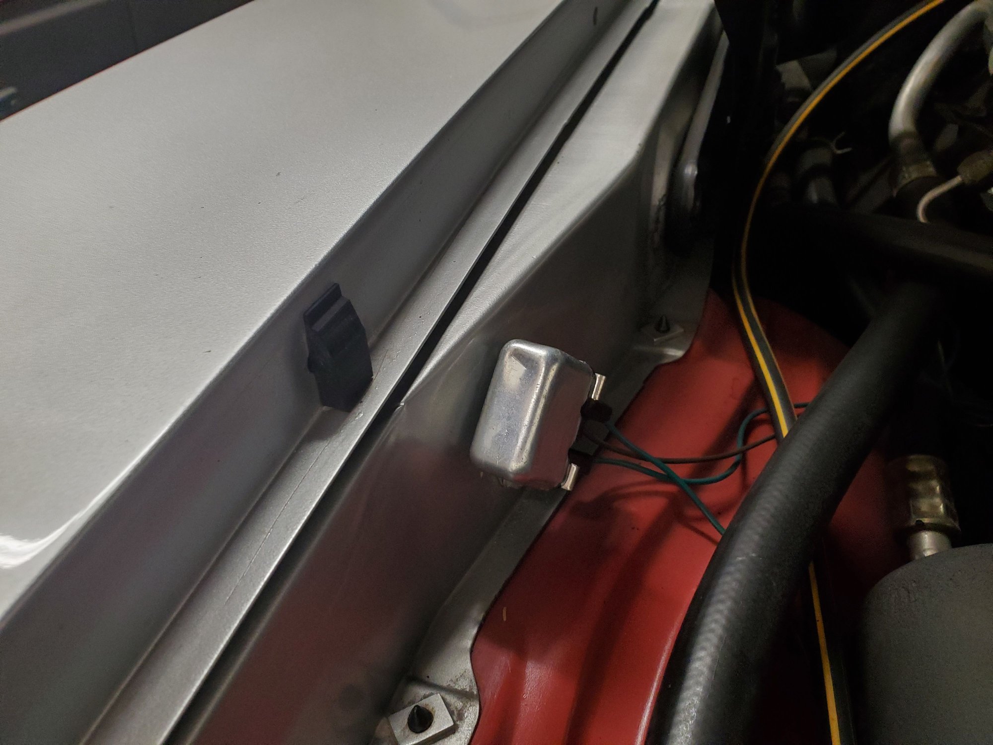

This relay sits on the passenger fender just like the horn relay sits on the driver's. I will keep the other relay with me in case I ever want AC for defrost. This would have to be a summer roadtrip in bad weather, and I just don't see that happening soon with this car. New relay matches the other one in color, too.
