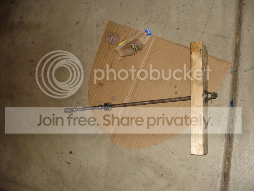

Same here ....as posted here:
https://classicoldsmobile.com/forums...tml#post228384
This turned out to be a colossal waste of time. After spending hours messing with it and getting no where, I gave up and resorted back to my own trusty high-tech custom tool....
click for big...
...It's just a 2ft piece of 1/2" all-thread (rated @ 3200lbs) with various nuts/washers. Note the optional anti scuffing device for protecting the upper shock mount paint (cleverly disguised as a piece of Moog box...). The coupling at the top gets locked by the nut so I can spin the wrench up above the top arm/mounts.
