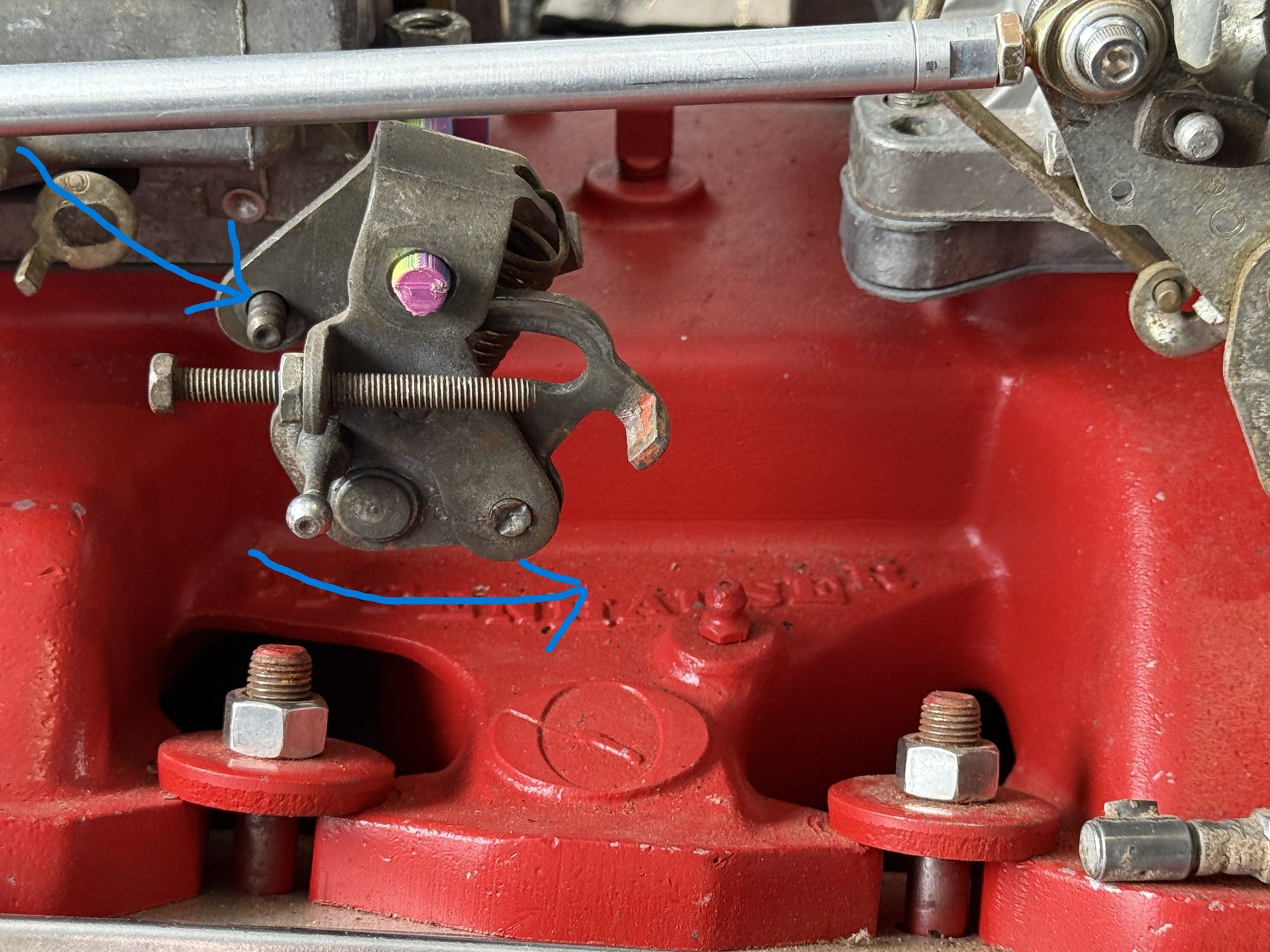

Bellcrank
I just wanted to verify how this bellcrank works. Would I be correct with the top arrow having the carburetor linkage push the bellcrank in that direction?
When does the spring come into play. I'm puzzled by how this works.

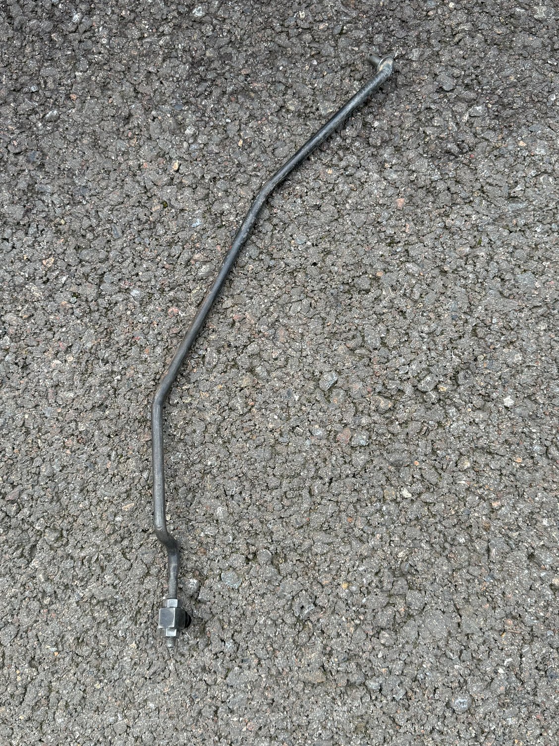

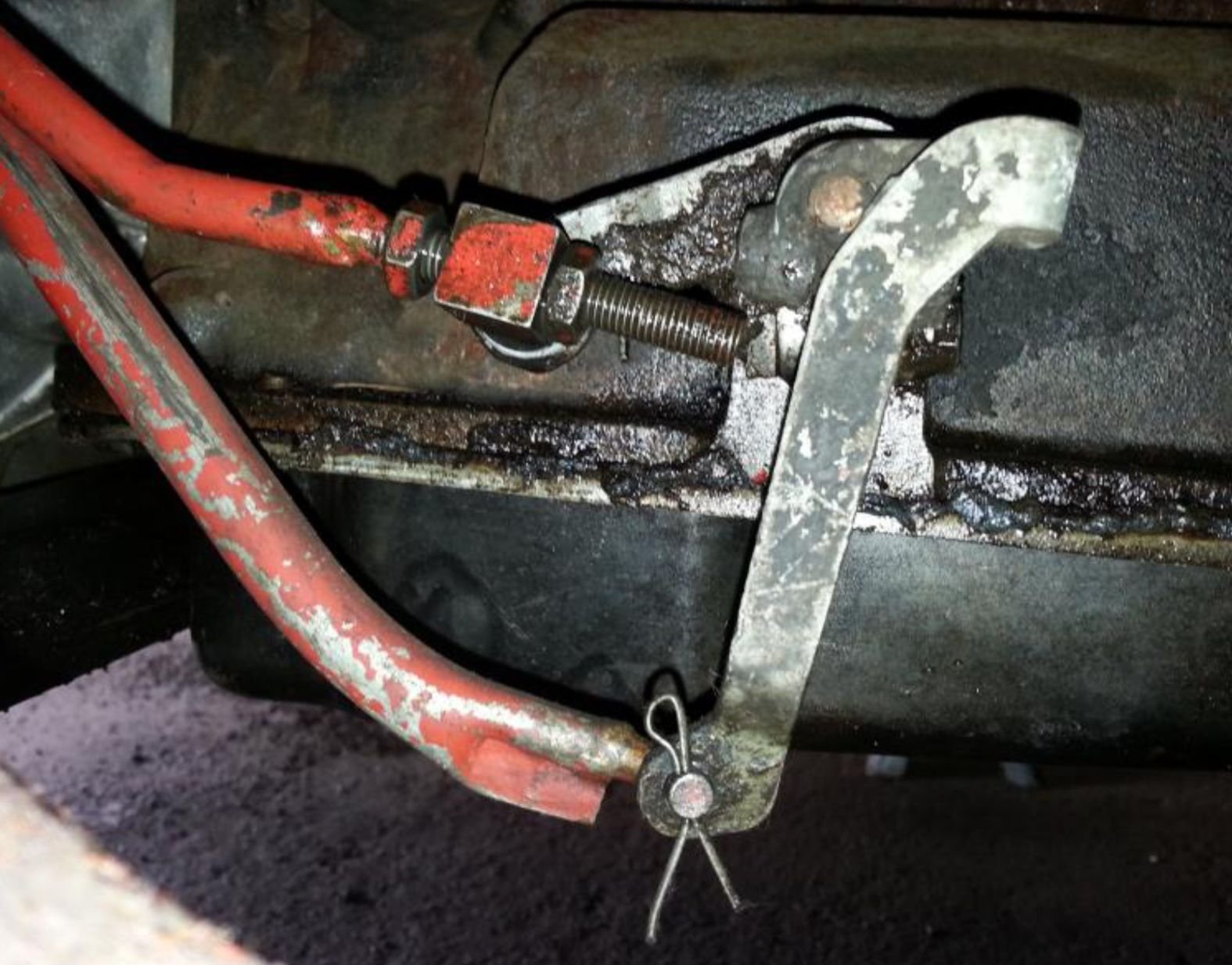

Does this shift linkage look it was modified to fit this transmission? My dad put this together but I don’t know if he modified the shift linkage to fit. I lost the original but I got another shift linkage from someone but it’s not the same.
This is the one I have now. It doesn’t look like the one above had that bend in it.
