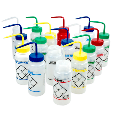

Fuel does evaporate from the carb if the car sits for a while. The E-brock carb on my 62 will go about two-three weeks before too much gas evaporates to start the car. In those cases, I use a solvent wash bottle bottle full of gasoline to fill the float bowls through the vents, at which point the car starts immediately. If you are having a problem overnight, however, this is not the issue.
These particular bottles are made to hold acetone, so gasoline is no problem.

I never thought of using one of those, Joe. That's a really good idea.
Sure beats the 2½ gallon gas jug I usually use (liberally...). Looks so much more... Professional.

The bigger advantage of using a solvent bottle is that you can actually squirt the gas into the float bowl instead of washing all the oil off the cylinder walls when you dump a cup down the carb.
Please show me those vents as I'm about to start up engine after rebuilding it.
