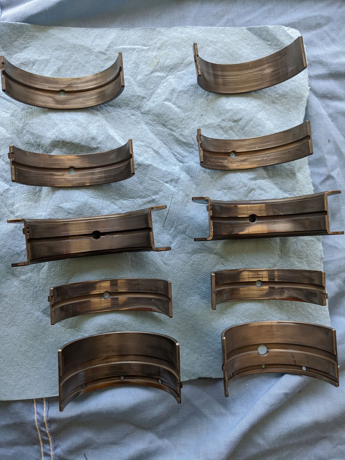

Out of my 1970 442 street/race car over a thousand passes.
Hmm 3,4,5 barley have copper showing.

What do the rod bearings look like?
Old Jul 9, 2020 | 02:53 PM
wr1970's Avatar
Joined: Sep 2013
Posts: 3,645
The rods bearings had no damage lol. I still have them i think maybe I should show what they looked like.VR1 20/50 race oil was used. I just can not wrap my mind around the mains only half of the thrust bearing showed any damage and 4 was minor 5 rear main was also slight. But why these and nothing with 1and 2?

Sorry, I don't have the Mondello book handy anymore..... You said by the book, but, I wish You could mic the main journals and see where 1-5 are in the numbers to see if 3-5 are slightly larger than 1 and 2.
Did you run any oil restrictors anywhere?
I know there are way smarter folks than I who might be able to better read your bearings....

Not necessarily in this order but;
clearances
align hone (And just because they may be in size doesn’t always mean they’re inline).
Balance-my bet is it’s not as close as it needed to be
Hope this helps.

How straight is the crank? Turned correctly and polished? Looks like a big problem with #2 and #4.

He said they were std bearings so it was not turned.
Its kind of hard to really tell because of the lighting in your picture. I think what I thought was wear in the center of the bearings is actually a reflextion. I would say the clearances are pobably close but there is either a problem with the align hone or the balance job or maybe both. Still it did ok for 1000 passes. I bet the wear on the bearings was there almost immediately and then they "clearanced" themselves and stayed that way for the duration.
no wear on one or two three was edge so was four except wider and five was back edge. I am a dunce! That being said I couldn't measure crank because I forgot I installed new bearings when I posted. Does bearing i still have and show them. This was the factory standard crank. I with Mark balance could be off but unfortunately I am leaving it alone. The car will not be raced anymore . I think under normal driving it will last a long time. Jmo
The lighting was bad with reflections. You have to enlarge picture to see the copper.

I would post some HD pictures on Class Racer. They have a solid base of good engine builders with vast experience on the site.
For what was done to the engine, I think 1000 passes is impressive. These engines have a history of self destructing without careful attention to detail.

Passenger side bearings
Old Jul 12, 2020 | 01:17 PM
wr1970's Avatar
Joined: Sep 2013
Posts: 3,645
Drivers side
Old Jul 12, 2020 | 01:21 PM
wr1970's Avatar
Joined: Sep 2013
Posts: 3,645
Scratches from normal wear but nothing you can feel. Except rod bearing #4 in one spot copper showing.

Combination of dirt, possibly inaccurate machine work and setting bearing clearance with plasticguage, this is the end result.

What your seeing here is the rod parting lines pulling in at top dead center, more RPM and it will be worse. The fix for this is oval honing the factory production rods, and of course a lighter piston always helps with this. What kind of RPM did this engine see?

If it was my numbers matching engine I would lean towards having the crank polished by a competent machine shop.
The key being competent. The reason I say this is guys that build performance cars tend to drive them enthusiastically
I have experience with spun bearings, that's why I'm so impressed with your 1000 pass stock rod std crank 455.
Bearings are softer than the crank surface, but I wonder if any damage might have been done to the surface of the crank given the bearing wear?
What does the crank look like?
It's not uncommon to have torsional flex in the Oldsmobile 455 engine block. Typically the average assembly by nature is just very heavy. The cars that these engines go in are heavy as well. What you're seeing is block flex with clearances that are too tight. If you stop the block from flexing, then those clearances that you run.,would be fine for that given HP that you have. A partial fill of the engine block and a mid plate, really makes a difference. It takes the stress off the factory motor mount area. We use the Valvoline VR 10-30 and VR 20-50 in the majority of our engine builds that take place in the shop.
