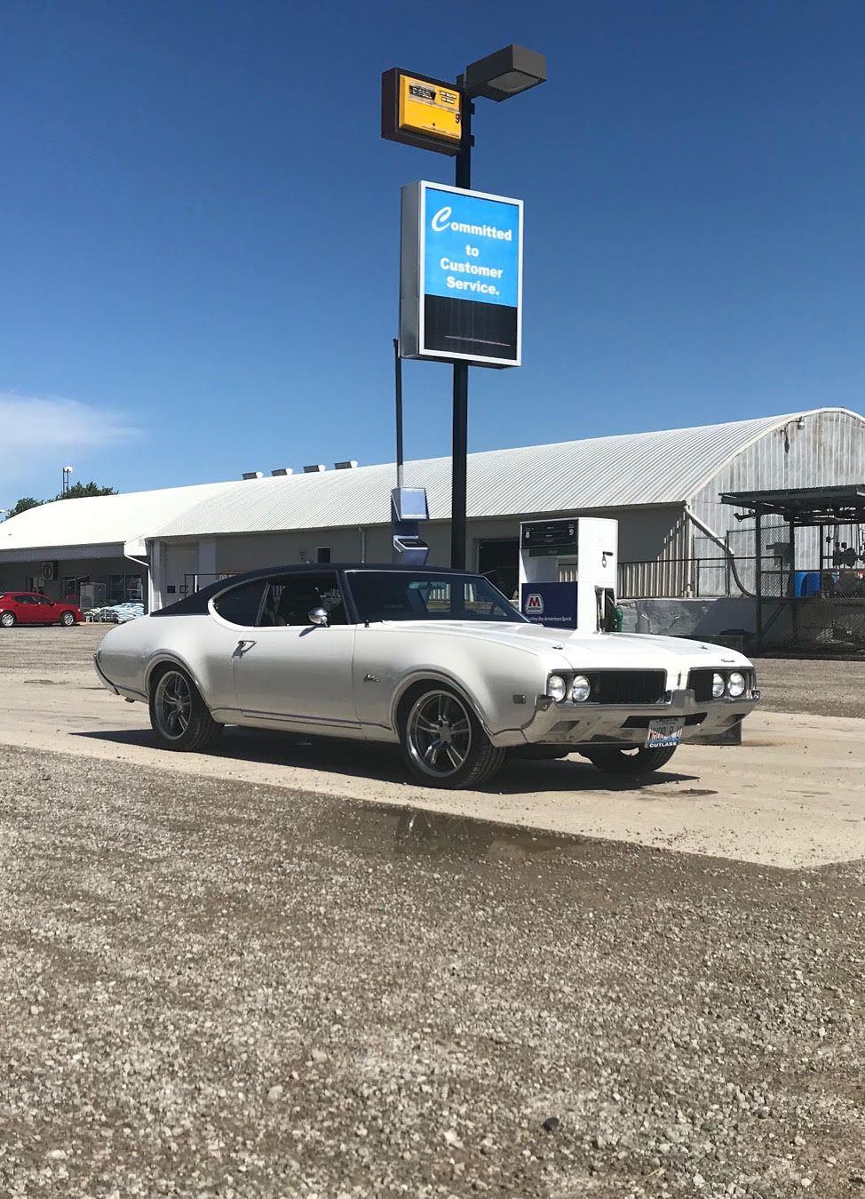

The Bandit U109 is a cast aluminum (not forged) wheel with a smooth lip; in 18x8 is about $300ea. from Summit. It looks a lot like the Olds SSI wheel; I have them on my car and modified the retainers for the SSI center caps to fit. Here's some pics.
Rodney
18x8 245|45R18 on the front and 18x9 285|40R18 on the rear.
The 245|45R18 is about 26.6" tall
Side shot of the center cap
