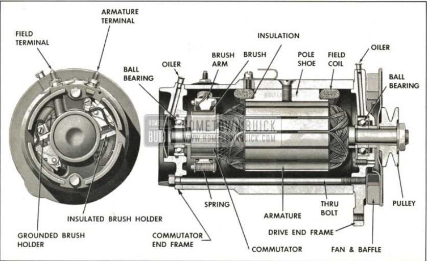

Brushes are generally made from carbon. They are primarily of two types: carbon graphite or lead graphite. Brushes are not magnets. Carbon &/or carbon graphite is not magnetic, lead &/or lead graphite is not magnetic. Carbon &/or carbon graphite, lead &/or lead graphite are excellent conductors of electricity & that is why they are used as the raw material for making brushes.

Simply put, you’re converting mechanical energy (GEN belt turns the GEN armature via the GEN pulley) to electrical energy. Electricity in a GEN is produced when the armature rotates inside the stationary FIELD which surrounds the armature. Think of the commutator as the “collector” of electricity. Notice the brushes must contact the collector (commutator) to transfer (conduct) the electricity to perform electrical work. Notice again two key terminals located on the GEN identified as the A (armature) post and the F (field) post. So the commutator collects electricity and the brushes transfer that electricity. NOTE: The commutator spins at the same RPM as the armature. Therefore, those brushes are key to transferring/conducting electricity.

I have to commend you for making an effort to fix the GEN and desire to want to learn. You should probably take the GEN apart at this point and determine if it is salvageable. The rotating armature may be rubbing against the field plates causing the noise & producing the dust. This may be the result of the bushing &/or the bearing OR both producing an off center wobbling rotation of the armature. The kits do come with a new bushing & bearing. This may address the issue if the armature is still in decent shape. Take the GEN apart & post some pictures, note the amount of play in the armature, wear points on the field shoes, and the bearing & bushing condition. Thanks to Stellar who contacted me regarding your issues. I admire your ability to want to learn and get your feet wet. If unsalvageable that eBay GEN is most likely your next best option.

Generators used to be called Dynamos. I used to listen to Frank Zappa. He had a song called Dinah-Moe Hum. I’ll just grab a cookie on my way out…

Almost forgot. As Stellar mentioned to me the least expensive & easiest repair would be a one wire ALT if you elect to do so.
When Delco went to alternators they called them AC generators and AC dynamo. That is the reason they had a GEN indicator light when there was an alternator in the car.
As far as the generator being salvagable, acording to Frank Zappa, Chances are 50-50.
