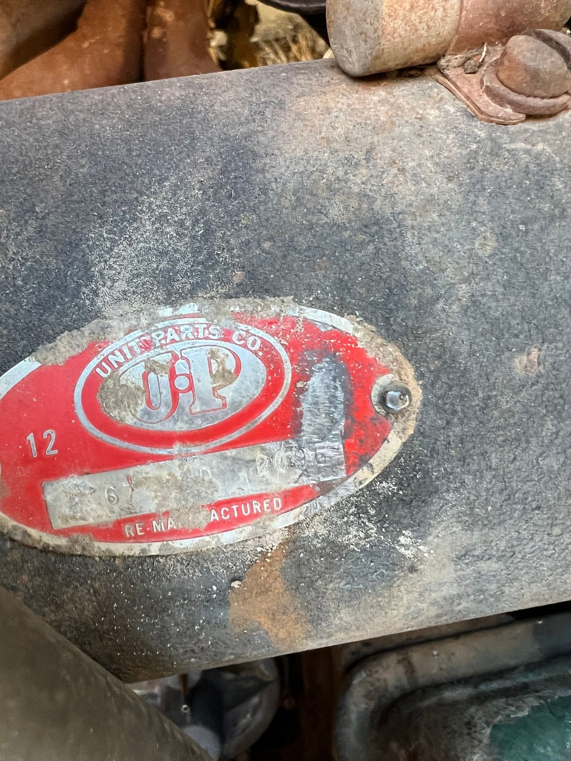

Depends. No definitive way to answer the question based upon smoking alone. Is it a generator or an alternator? What make, model & year vehicle? What model of generator/alternator? Not trying to be flippant, but if it works it works, if it doesn't then we can provide more diagnostics to troubleshoot further.
it’s a 55 olds super 88 and it’s a generator which I opened today and everything looks in tact no broken wires or brushes, anyways I put in an alternator today to see if it would work and it did but then I shut the car off and tried it again and didn’t work. Am I supposed to bypass the regulator cuz the guy at Napa said the alternator I showed them has an internal regulator which I didn’t know. If it’s my voltage regulator that’s the problem, should my original generator still be fine?
A generator does not have an internal VR (Voltage Regulator). If you replaced an original generator with an alternator then you need to be certain of two things: (1) The alternator you install in your car should be an alternator which uses an external VR - just as your original generator was using an external VR. (2) Install the original generator exactly as it was wired using the external VR and see if the generator operates without smoking. If the issue (whatever it was since you haven't said what issue there was to begin) was the VR, the generator might very well still be fine. Reinstall the original generator. Curious how you determined the VR was bad. I'm not quite following.
I guess my basic question is this: Why did you replace the VR?

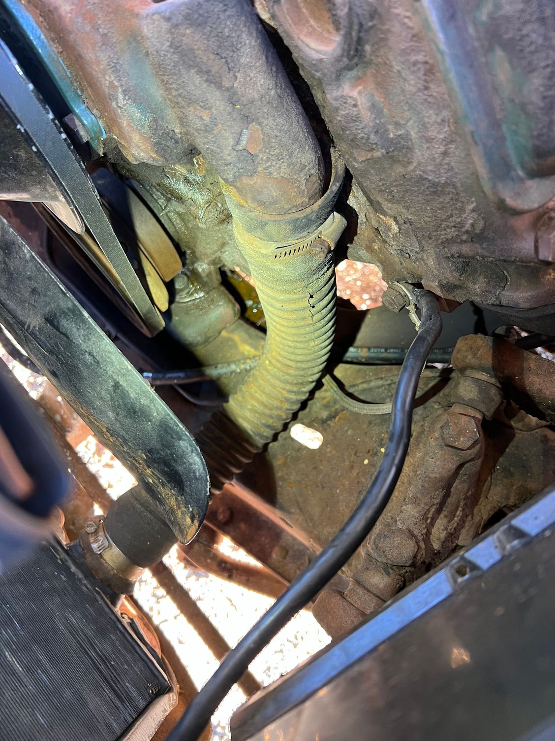

the braided ground isn’t touching anything, it was mounted to a bolt holding the radiator on but I put in a different radiator and never took off the braid ground just left it hanging. Anyways let’s say I remove that braided wire, then should I put my original gen back in and check for bad grounds and bad wires? Like I said after I let it sit for a month without running it then my gen started smoking so something went wrong some where along the line, and I’m trying to figure it out without just going buying new parts I may not need. I did look inside my VR and one of those copper coils has a little burn mark at the end. And I looked under the VR and the two spring coil looking things are in tact but look a little rusty and white like corrosion so I’m not sure, all I know is that everything was fine until starting it up for the first time in a month or so. Could it be the ballast resistor?

Yeah, that braided wire is/was most likely a ground wire to the frame or chassis near the radiator. There is nothing wrong with establishing another ground to the frame or chassis from the block location. Since I'm not clear from your description the exact attachment location, it's most likely a ground from the block to the chassis. Again, there's nothing wrong with that braided wire used as a ground to support electrical ground continuity through the chassis &/or frame of the car (most likely the chassis). Either use it or remove it.
I’ll remove it because when I bought the car it was mounted from the block to the battery tray but that tray is all rusted and it broke off and I tried to replace it but I’ll just remove it most likely
IMO, if that braided (ground) wire was attached to the battery tray, that is the absolute worst place it should have been attached. Not sure why anyone would have done that, honestly. A gazillion issues can develop from a ground wire attached to a battery tray. Honestly, it makes more sense to have a solid ground to chassis and frame. If it were me, I'd install the braided ground strap to the chassis - which is most likely the location near the radiator. Since we haven't discussed other ground attachment points on the car, you need (let's make sure you understand this) a solid ground system on the car:

I understand that and the only one I don’t think I have is one going to the chassis. I do have a small old braided wire going from the block to the frame. I’m not sure why there was one to the battery tray either but it broke off as soon as I touched it and that’s when I put that new braided one on there

From the picture it looks like the cable end is resting on that pad on the block and the terminal is not making good contact with the block. You might want to loosen the bolt and turn the cable downward toward the frame and tighten it back up.
oh yeah your right I didn’t even think of that ok I’ll try that
