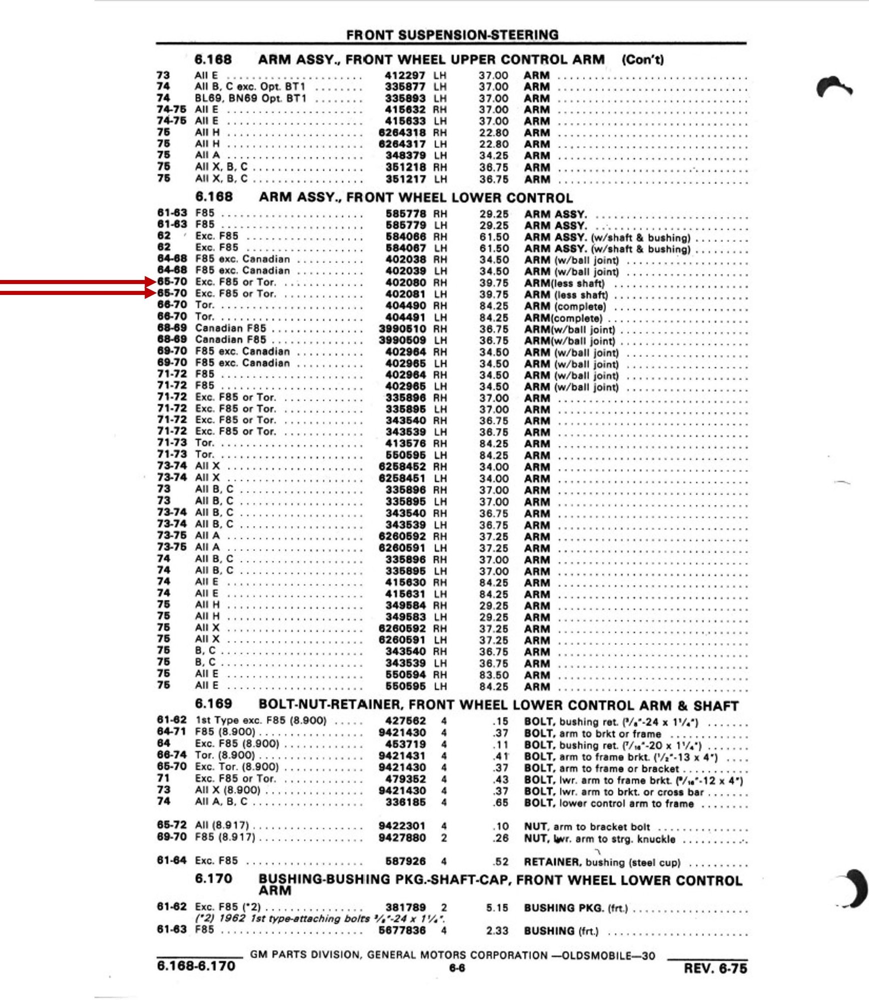

To help expand your search.
The parts book lists the lower control arms as the same from 1965 thru 1970 All except F-85 and Toronado.
The factory part numbers are 402080 (RH) and 402081 (LH)
Thru 1975 - Oldsmobile Chassis and Body Parts Catalog - ClassicOldsmobile.com
You won't find a new one. Good used from another 1965-70 Olds full size is your only option. No, Caprice/Impala parts do not fit. Be aware that the upper ball joints for the 1965-70 full size cars are also very difficult to find new. They are RH/LH.
Originally Posted by Delta88rocket123
Are the control arms from delta/starfire/88/98 interchangable ? i found one used for each model but would like to get the least rusty if they're all the same
Both Charlie & Joe have already addressed your question.
Yes.
