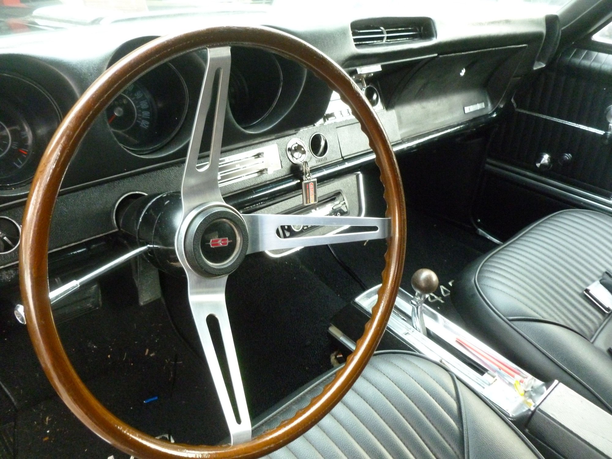

I had my steering gear box restored. Once I got it back and installed it my steering wheel is misaligned. Any thing I can do to correct this?

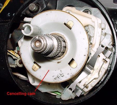

The problem isn't the steering wheel, it's the column clocking. The hub only goes on the column one way. You need to figure out where the column is misaligned. Start by jacking up the front wheels. Count the turns from lock-to-lock, then come back half way. If the front wheels are not straight ahead, the alignment was done incorrectly. You have to shorten and lengthen the two tie rods by an equal amount to center the wheels. Also, with the box centered, the scribe mark on the end of the steering shaft under the horn button should be at the 10 o'clock position. If not, the steering shaft has been installed incorrectly and needs to be corrected. The OEM steering parts only go together one way, using different sized fasteners on the rag joint and keying on the shaft parts. Aftermarket stuff doesn't always have these features.
Note the scribe mark on the end of the shaft.

I kind of thought that I just might have to make some adjustments to the tie rods but I was just not sure. The only thing that changed was the rebuilding of the steering box because prior to it being rebuilt the steering wheel was centered correctly
