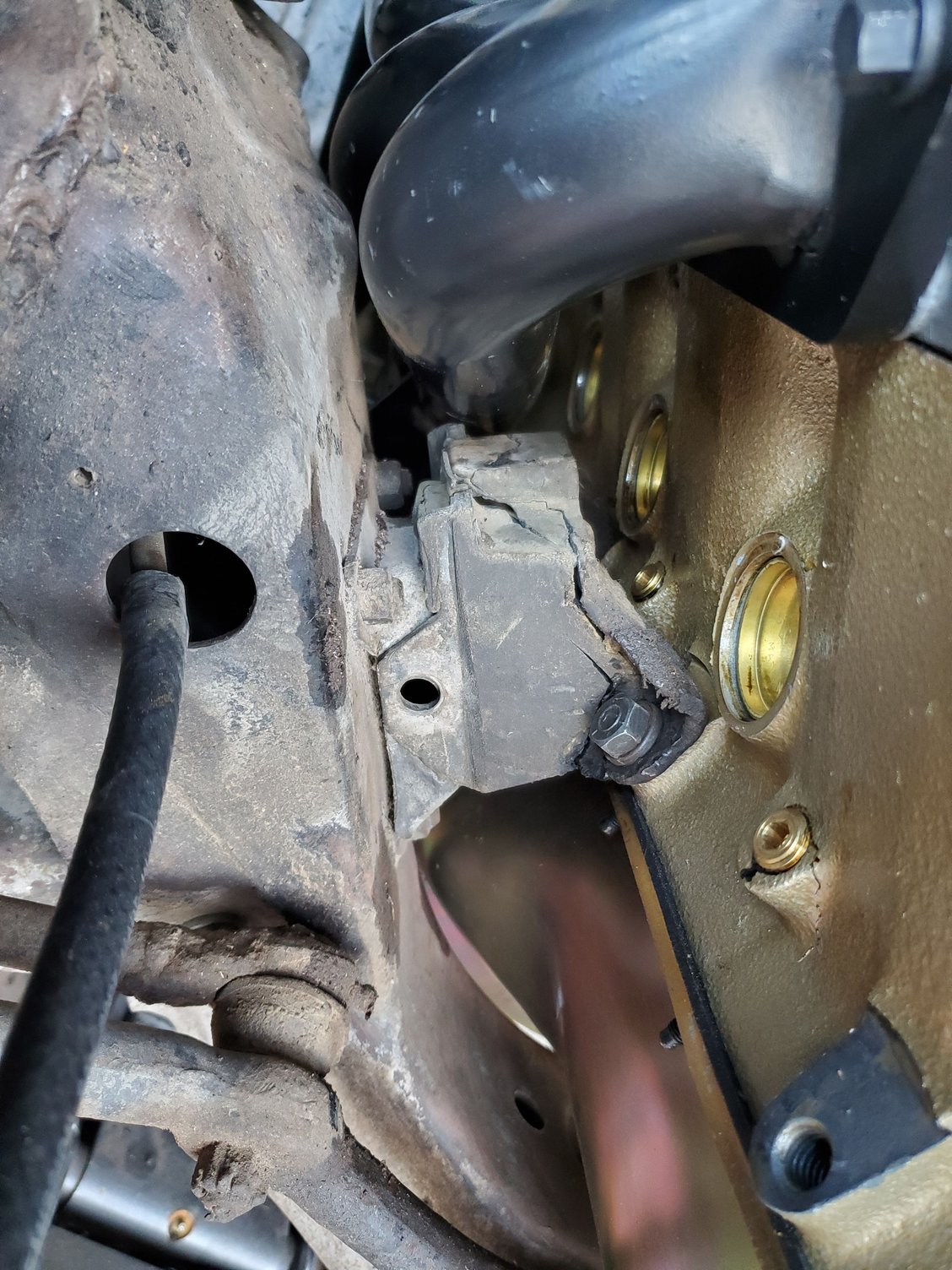

So... while I was trying to install the trans mount and crossmember, I took a pic of the engine mount and noticed something that I did not see until I looked at the photos. It looks like there is a crack around the front drain plug of the block. I will need to pull that plug and verify if it is indeed a crack in the block or if it is a giant paint chip. There should not be any water in the block to freeze and cause it to crack like that. Even if there were some residual water left in it after the dyno run, it has been sitting in my garage for 6 months and New Mexico is DRY! Even anti-freeze coolant will evaporate. Mark, If you're seeing this, any ideas?
Old Jan 4, 2020 | 06:30 PM
  #99
The block is cracked, not a freeze crack as you would see a freeze plug would move. You might want to consider grinding the whole boss flat and tapping for a 9/16 pipe plug, that might work? But again the crack is near the motor mount bolt. At the same time you might want to square up the freeze plugs.
I can also recommend a excellent cast iron welding company, but they have to pre heat the block in a oven to weld it, if needed.

I assume you contacted Mark about it? Looks like the aftermarket plug was over tightened. I like the shouldered factory plug for that reason, unless a huge ratchet or impact is used, never an issue, will only seat so far.

You could also try this:
1. Remove the pipe plug with too much taper
2. Clean all the hi tack off with super tech carb cleaner, this can be bought at Walmart
3. Use a die grinder with a cartridge roll to bring the surface !/2 inch past the crack in all directions down to bare metal
4. Again use super tech carb cleaner to clean the surface and threads, use compressed air to dry, repeat until spotless
5. Clean the oversize brass pipe plug with carb cleaner spotless
6. Screw the over size brass pipe plug back into the cracked block until the crack just opens up, be careful
7. Apply 3M SEAM SEALER into the crack and 1/2 inch past the crack in all directions, build it up
8. Take a non tapered pipe plug, clean it with the carb spray, use compressed to dry
9. Coat the pipe plug with GM SEAM SEALER liberally then screw it in
10. Apply 3M SEAM SEALER in all directions 1/2 past the crack
11. DO NOT ATTEMPT TO USE ANY THING OTHER THAN THE CHEMICALS SUGGESTED
12. Square up all freeze plugs while your in there
This could possibly work, and its the easiest to try. I can supply you with a non tapered pipe plug if needed.
Old Jan 5, 2020 | 06:03 AM
  #102
cutlassefi's Avatar
Posts: 8,472
From: Central Fl
Clean the area with brake clean or similar then see what you really have. Can you feel the “crack” with a fingernail?
That engine was running on the dyno for every bit of 90 minutes or more to map the fuel and spark tables. Never a leak, anywhere at anytime.
Let me know what you find.

The cooling system on the dyno doesn't run at the same pressure the cars cooling system runs at, that extra pressure could cause a problem. Heres an example of a shouldered freeze plug installer.
I know that. But running at temperature the “crack” is going to open up no matter what.
And I’m not sure what a shouldered freeze plug installer has to do with anything at this point.
Old Jan 5, 2020 | 06:58 AM
  #105
VORTECPRO's Avatar
Joined: Aug 2012
Posts: 1,878
From: Thousand Oaks Ca
The installer pictured will help you install the freeze plugs square, this could be a problem under in car operation. If the plug is cocked it isn't sealing with much surface area. I think the crack problem could be made not to leak using my above operation, is it good....no but it might work. You could also do a short block fill, but welding is the best bet, but very involved.

Has anyone suggested brazing ?. Quick easy string enough and its a low heat topical bond . when I skateboarded i used to build grind rails and braze them . held up all the impact my 150 lb body could throw at it.
Also marine JB weld works very well. .

Ouch!!!!! I would find a good welder to weld that

That looks like a crack, to me

The block looked cracked to ME, but when I looked closer it looks like Aviation #3 sealant was used, and it runs like that when not wiped clean? The freeze plugs on the other hand... NO GOOD!
Bernard Mondello Racing Enterprises
I agree with this.
In regard to the freeze plug, I take pride in the little things as well. If you could see all of them you would notice the part numbers on the plugs all face the same way and so on. Maybe it got bumped during crating etc but an easy fix nonetheless.
It does look like Hi Tack on the top, but the bottom looks like a crack, simple enough for the owner to get under there with a rag and carb cleaner. All the freeze plugs look cocked to me, maybe he can take a better picture.
We have a winner! When I went to take a better close-up picture I wiped around the plug and it was indeed a bit of sealant that was stringing down the block. It wasn't a run or a drip, more like a string as if someone had touched the sealant and then pulled away and the stringing sealant then fell down against the engine without sticking. The camera angle of the first photo surely did look like a crack though. Scared the **** outa me for sure. Here are some better pics.

One would think when was on the dyno it would be leaking and would of been caught then.
Wire brush it clean and find out, how I found a crack in a 394 I was trying to save.
The motor mount, looks like its cracked or separating. Or am I seeing things?

Never mind. lol
Glad to hear its a false alarm!!!!!
The motor mount is cracked but I have new ones to install. I need to get the trans mount squared away before I install the new engine mounts though. Don't want to be jacking up the engine with nothing holding the back end. My car is a 67 base model convertible and doesn't have the extended frame mounts for the trans crossmember so I need to add them. Once the trans is mounted I can jack the engine up and not worry about it sliding under the car while I change out the engine mounts.

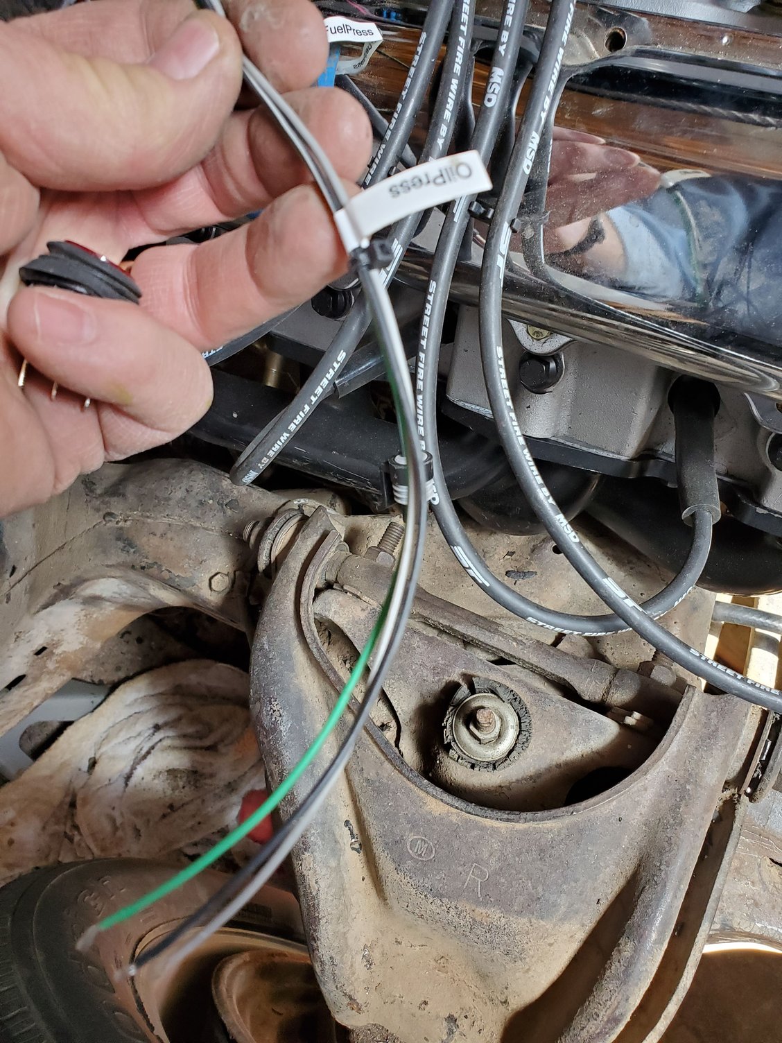

I have been working on getting the wiring harness installed so I though I would show a little of the progress.

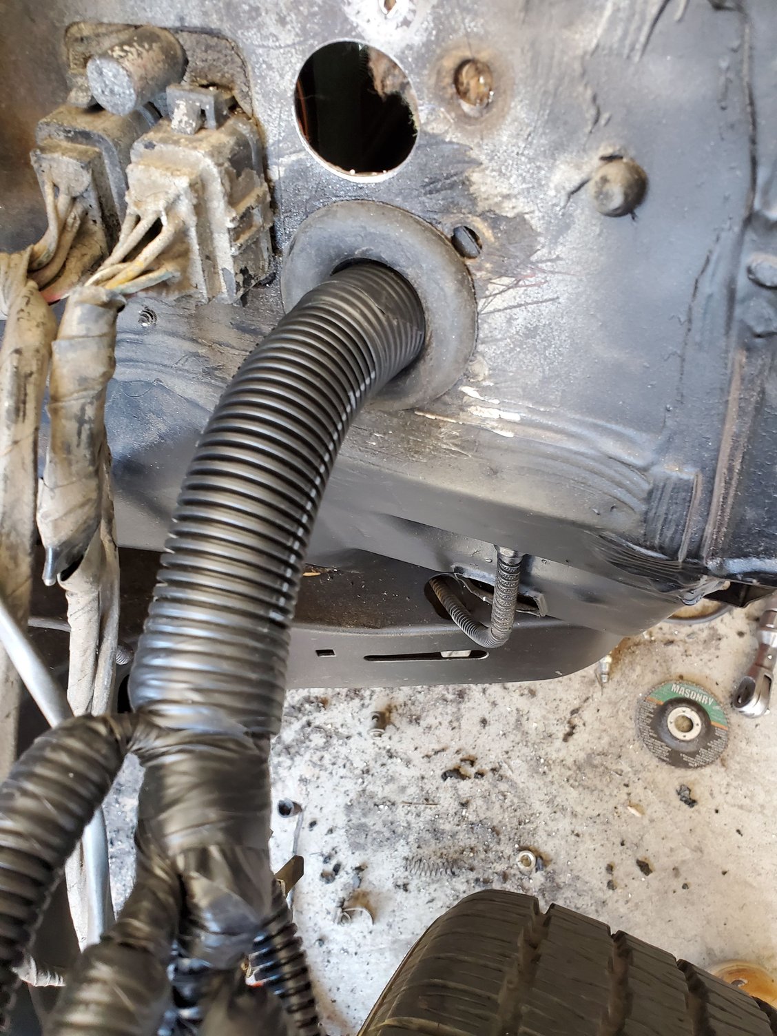

I needed to put a hole in the firewall for the new engine harness and I wanted to try and keep it looking like it belongs there. Not really, but it makes me feel better to think that way. I started by enlarging the existing hole for the convertible top power feed. Sorry for the poor quality of this pic, I forgot to take a pic of the grommet or hole before I started.
I used two holesaws together to cut it large enough for the new harness grommet. I made a test hole in cardboard to find the right size saw. I won't bore you with all of the pics of that, but it woked out in the end and then I had to make another hole for the original grommet.
Old Apr 12, 2020 | 08:31 PM
