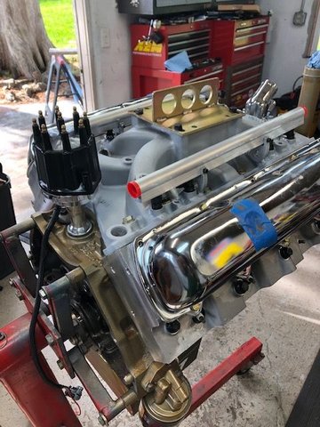

Back to the engine. Like I told Mark, I'm like a kid waiting on Christmas and wanting to shake the boxes while waiting on this engine.
I have a few more pictures to keep me going.
The rotating assembly is in.
The oil pump is installed.
The pan fits.
Waiting on the cam...
Kid! Christmas!

Here are the latest pics I have. I've been trying to convince Mark that there is a lot more engine **** available than just the finished views. There is fun to be had in the undressed state.
Just waiting on the dyno results and shipping. Being a little non-PC, I'm like Bill Cosby in his "200 Miles an hour" skit. Like a kid waiting for Christmas...

I bet that’s going to be a lot of fun to sit behind!!

Agreed! Looking forward to the results.

I think we are all a bit jelly.

lookin good !
I hope the 3 row rad with narrower tanks keep that bad boy cool. The circulation around the inner trans cooler could be marginal with a narrow tank. Is the trans cooler a 1 rib or 2 or 3 ? Most BB, HD, rads had 3 rib inner rad coolers . Are you considering running an auxiliary trans cooler or heat sink cooler as well.
I hope it works out OK .
