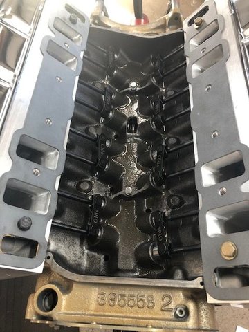

More engine **** from Mark! Just a few peaks up the skirt...

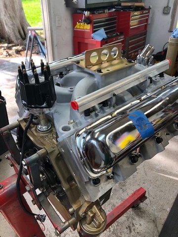

She's on the dyno!!! Is it rude to say that I sported a chubby after seeing these pics? Test results late today or Monday. The suspense is extreme to say the least.

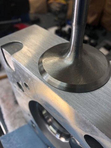

What size valves are in those Procomp's? Looks like a nice big, back cut intake valve.

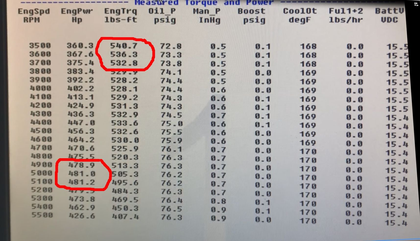

Initial Dyno results...
Corrected...

Actually peak tq is at 4400. You always throw out the first few numbers.
HP dropped off bigtime in the end because it hit the rev limiter. You can hear it in the video if Dailey wants to post it.
31* of timing and a conservative air fuel. There's probably more in it but no need to stretch it. It hit the numbers I promised. And pulling almost an inch of vacuum with a 950cfm throttle body, go figure. Who says a 950 is too big!

I was expecting peak hp at 5800-5900 rpm not 5100. Is the resultant peak a function of the stroke, the cam profile or both?

Respectfully I have another question. How is it possible have more TQ @ the HP peak? I have never seen anything like this, can anyone answer this? Just trying to learn here.

Thank you. These new cranks have really awakened the ole’ Small Block Olds in my opinion.
Peak power actually occurred at about 5400 or so. That’s a by product of the wide lobe sep for the most part. The RPM counter on the dyno doesn’t quite match what the ECU is seeing. It’s off by about 200rpm or so. This has been verified by multiple different ECU’s on this dyno.
I was actually expecting a bit more hp but was very happy with the torque and where it occurred. Should be a fun drive, even at 6000’ and above.

Originally Posted by cjsdad
I dont really care what VP is asking. Even if the dyno results verify something for him or not, I'm still taking the engine.
Now if VP wants to further discuss the aspects of dyno results with Mark, he can do it in his own thread.
Put-r-ther!!!!
I feel bad for Mark having to deal with guys like VP, especially when he doesn't need to waist his time commenting back to those posts. Mark is very much respected here on CO,
he goes out of his way to help so many guys here. He's an honest straight shooter and backs up his promises. You guys in the U.S.A are very lucky to have such an honest dedicated Oldsmobile engine builder!
We need to clone him and get one of him up to Canada haha.
Eric

Impressive numbers! However, I was kind of expecting higher #s w/ the alum heads on this build. These are similar #s to your earlier stroker SBO build with iron heads (I realize that one had TBI vs. this one has MPFI). Were the cams similar, or is the cam in this one milder offsetting any advantage of the alum heads? Not trying to be critical, both builds put up stout numbers. Just trying to learn here so I can plan out my build. Thanks.
I'm sure this engine could generate a great deal more HP and torque but I wanted it to be completely streetable. It will probably never see a race strip so "mild mannered" is the word of the day for this one. I live at 7,000 ft. elevation and I can drive 20 minutes in either direction and be at 10,000 ft. or 4,500 ft. so I wanted something that can adjust to atmospheric conditions quickly. MPFI is what I wanted. Like I said though, probably a lot more in this combo I just didn't want more.
