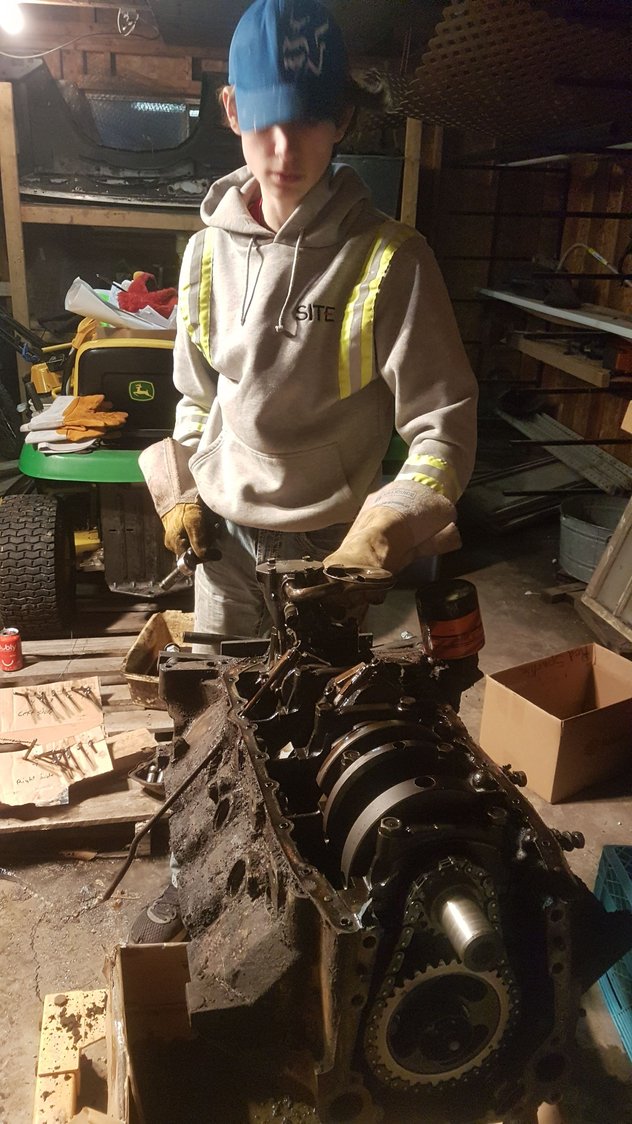

Well the heart of Kelvin's 442 is on the stand.
Dropping weight tomorrow. Pulling out the 7a's and removing valves/springs. Sending them in Thursday for magnafluxing.
Kyle's77cutlass is offline

Day 2 of stripping the block.
The little man even came out to join in pulling pistons.
Old April 10th, 2019, 09:42 PM
  #38
Chevy budget Olds powered
coppercutlass's Avatar
Join Date: Jul 2011
Location: Elgin, Illinois
Posts: 8,630
Great memories right there.
coppercutlass is offline
