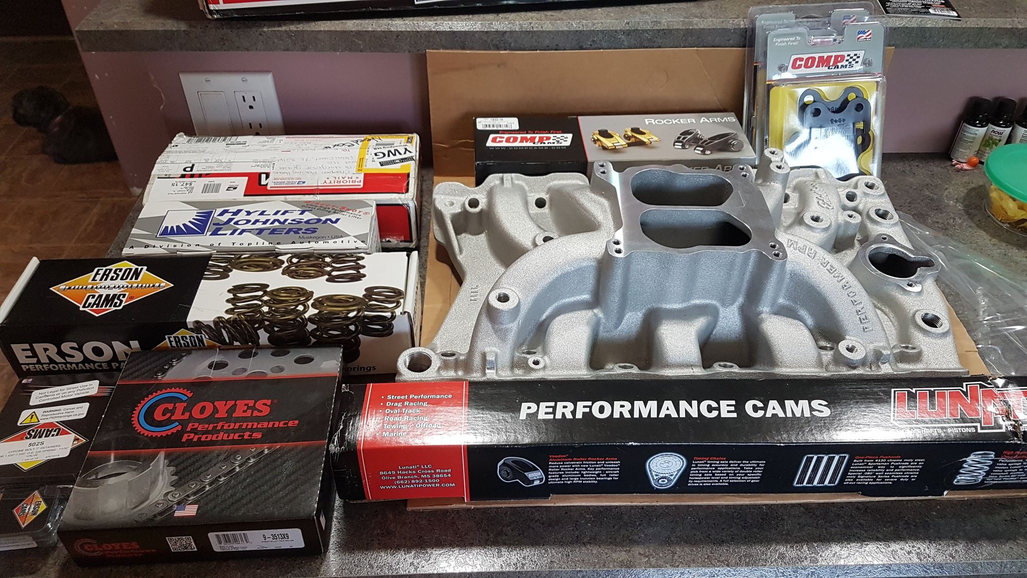

Parts are coming together. Now to port match intake
