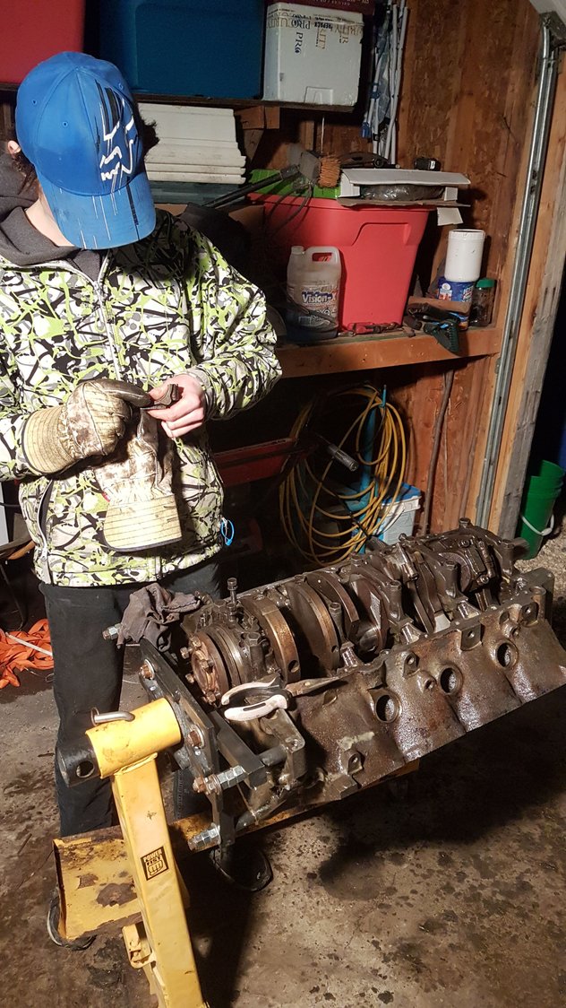

Well another good day on the block. She had a shower now off in the tub. Started removing valves from my 7a heads, finish the other tomorrow and clean them up. Surprisingly I didnt feel much play in the guides. Call the shop, confirming the block is coming next week

Before the block went for a soak
1st hours of cleaning
2nd hour of cleaning
3rd hour of cleaning
4th hour of cleaning
24 hours later from cleaning
After 24 hours of soaking, took her to the car wash and sprayed the block. Turned out well.
Soak again till tonight and,dry it up and oil the block to prevent flash rust. Install the crank and pistons, ship her to Winnipeg Monday/Tuesday

Gave Kelvin a crash course on removing valves.
Reinstalled crank
Put pistons back in, block is ready ready to send to the shop.

Another good day on the block.
Finished its bath and shower, sprayed it with fluid film to prevent flash rust. Crank, rods and pistons all back in and ready to send to the shop.
Heads soaking tonight, hope to be ready for magnafluxing Monday/Tuesday
