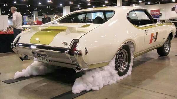

I can only assume it is for a stripe job. Regardless of how you do it, the Cameo white followed by H/O gold usually netted you something that looked a lot like this:
