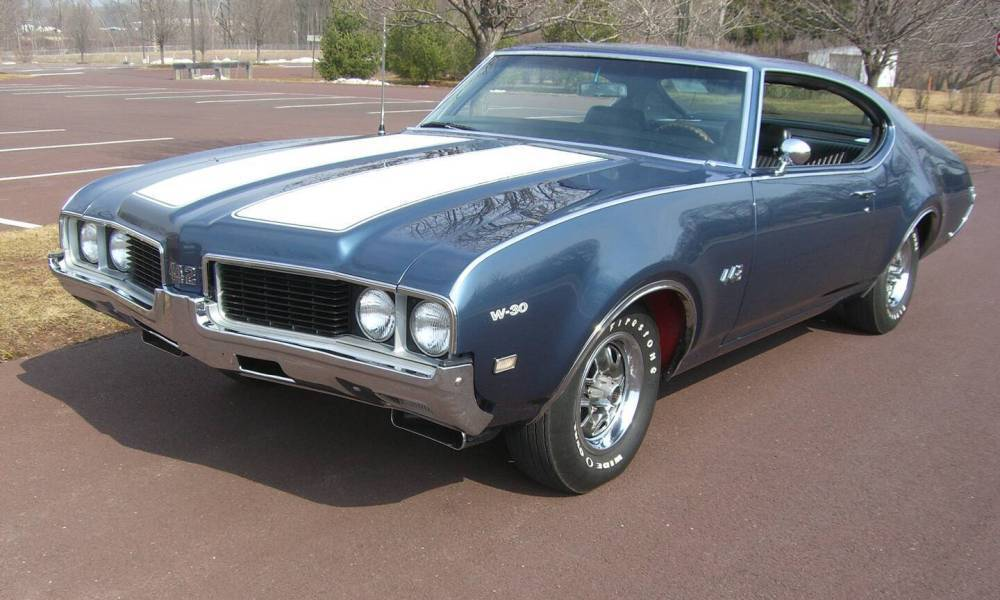

A 1969 442 would have come with the RPO Y73 GT Paint Stripe as standard equipment. This is the double pinstripe that outlines the raised areas on the hood. The RPO W42 Dual Stripe Hood was the optional wide stripes on the hood that were standard on the W-30, W-31, and W-32. Of course, today, any 69 442 that doesn't have a repro 70 fiberglass hood has had the W42 stripes added.
RPO Y73:
RPO W42 (ignore the location of the obviously non-factory W-30 decal...):
And just for grins, this is the opening line in the Barret Jackson description of that "W-30" pictured above...
(emphasis added)
Originally Posted by Barrett Jackson
A true well restored 1969 Oldsmobile 442 W-30...
(emphasis added)
