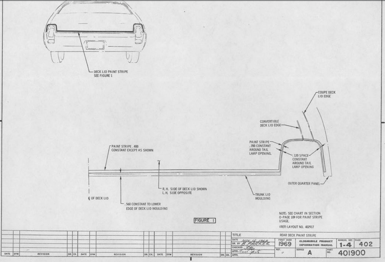

  2. No, the 442 didn't have the gawdy Chevelle stripes on the deck lid. It did have thin reveal stripes around the tail lights and along the bottom of the deck lid though.

From the 1969 Cutlass Assembly Manual, here are the options for stripes on your car as per factory

See the middle diagram on my post
