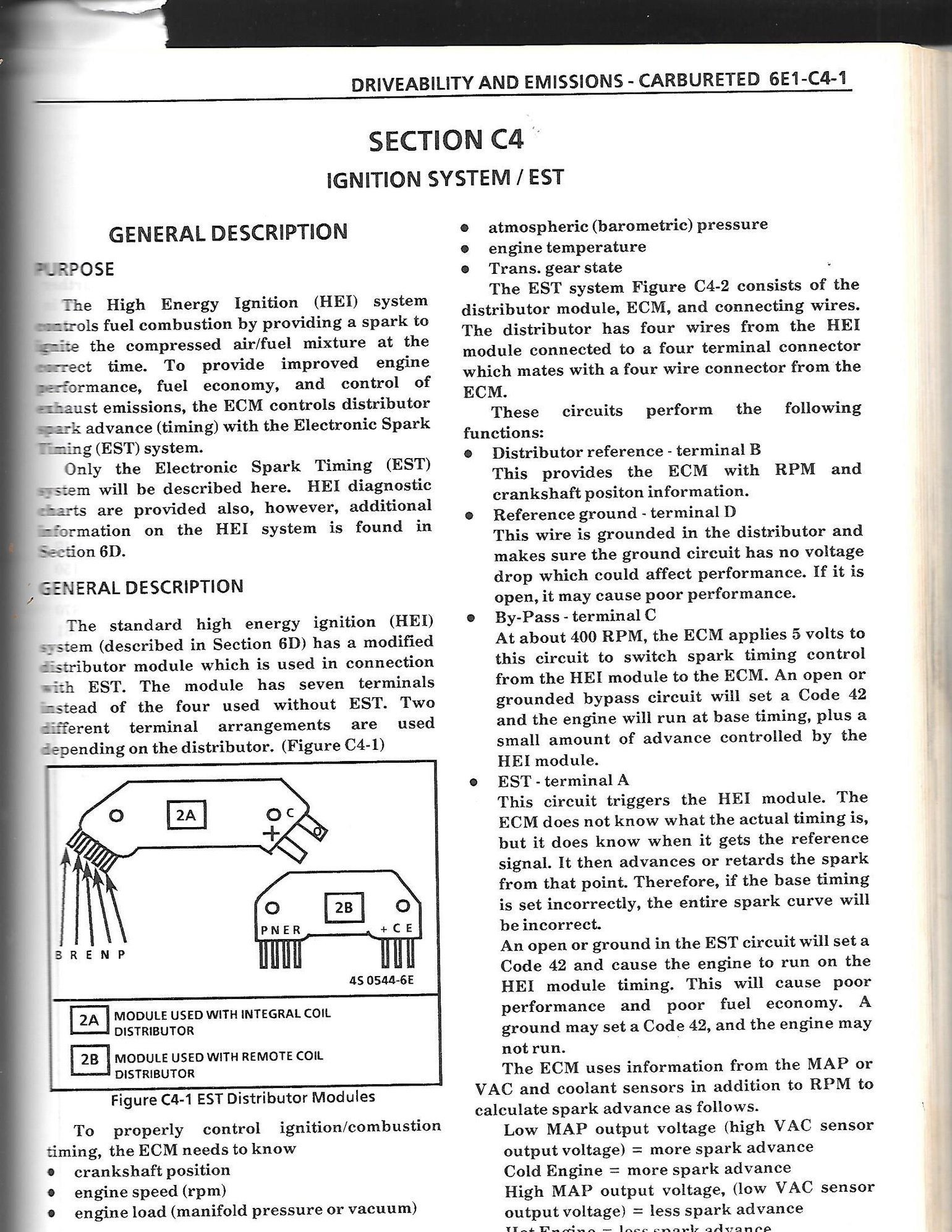

Old Oct 5, 2025 | 12:03 PM
  #45
Posts: 15,407
Originally Posted by synoptic12
from what I've read the air/fuel is calculated with the HEI Ignition Module, 'no'?
No. The ignition module just provides spark and has nothing to do with air/fuel. Air/fuel is the carburetor’s function.
Regarding the ignition timing and the module: the ignition module generates a spark in response to a trigger event. ‘When” the trigger event occurs is related to the ignition timing setting. So you need to ensure the timing is set correctly so the spark occurs at the appropriate point.

Old Oct 5, 2025 | 02:02 PM
  #47
Posts: 15,407
All of that is correct. This is the part that relates to the initial timing setting:
  • Signal Reception: The magnetic pickup coil inside the distributor sends a signal (a saw-tooth sine wave) to the module as the distributor shaft rotates.
“When” the signal from the magnetic pickup coil is generated varies depending upon the initial ignition timing. One component is fixed on the distributor housing and another rotates with the distributor shaft. This is how the spark timing’s relation to the piston position in the cylinder can be “advanced” or “retarded”. Rotate the distributor housing one direction and the timing is increased, and rotate the housing the opposite direction and the timing is decreased.
