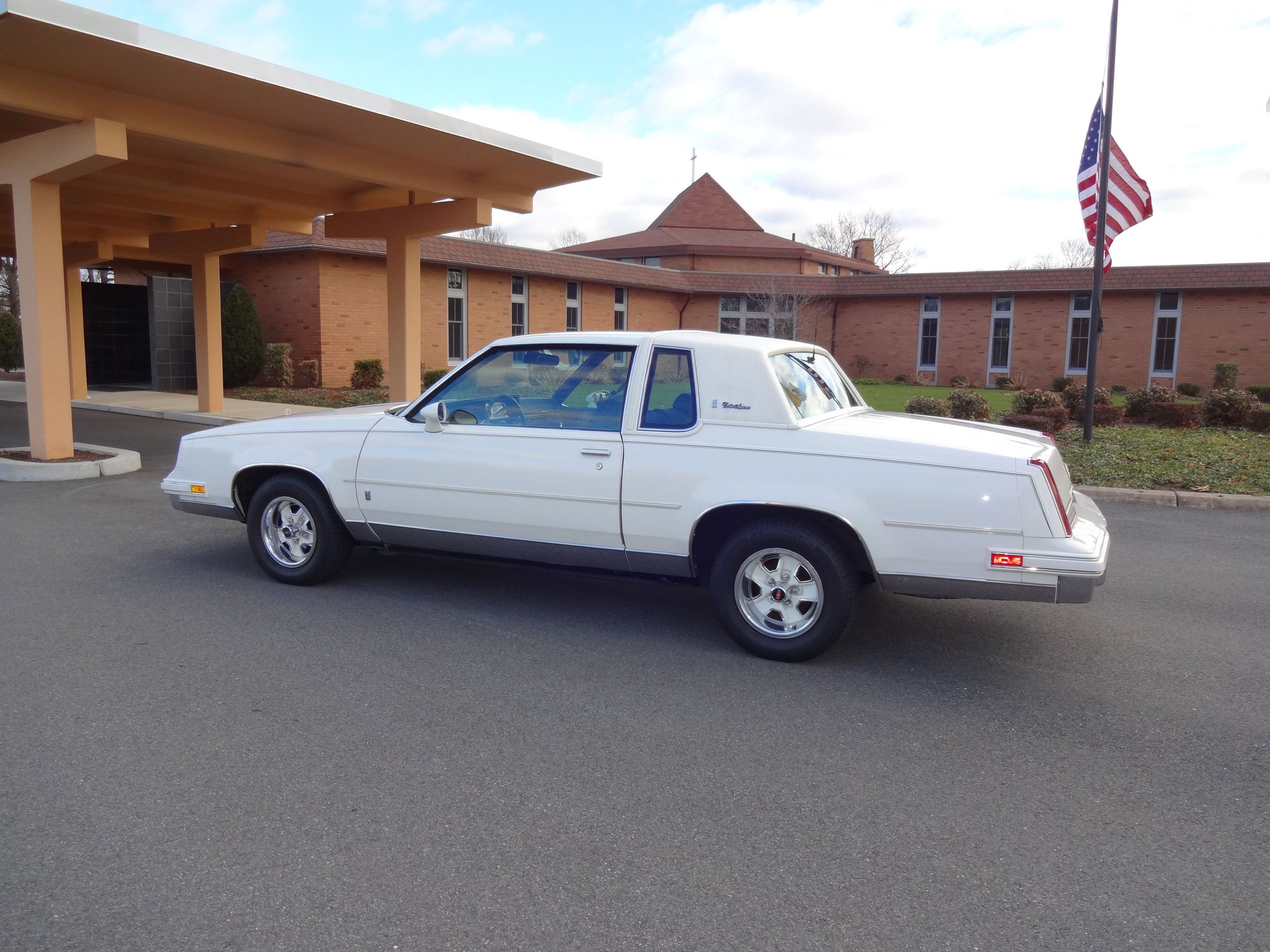

Seeking assistance relating to HEI Ignition coils for a 1986 Oldsmobile Cutlass Supreme Brougham, Vin Y, 5.0 Liter (307). As many know, most manufacturers parts are sourced out to China which I despise. I've looked at numerous HEI coils and all of them have varying degrees of issues. I'm not looking into upgraded HEI Coils such as Accel, MSD, or any other. My motor is stock so I'm looking to basically keep an O.E.M. stance with the HEI Ignition coil. After researching HEI coils for my car I found the NGK 49031 to be superior to the rest: Delphi- Made in China, Duralast- Made in China. Standard is supposedly made in Poland as I have used their parts prior (EGR Valve) - Made in Mexico (Very Good). I'm getting spark from my O.E.M. AC Delco as the coil has no issues (40 years old) and still good. However, looking for a spare and NGK seems to fit the bill. NGK provides a three year warranty (36,000 miles). I would very much appreciate any and all opinions adjoined to the above content.
1986 Oldsmobile Cutlass Supreme Brougham 5.0 Liter (307) Vin Y
