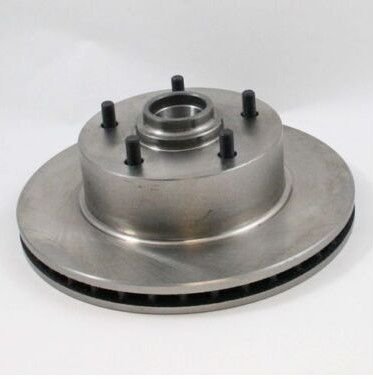

What I'm finding on-line for replacement parts is a hub rotor assembly (pictured below). I'm not confident this is 100% correct until I can get someone to validate. The CSM is sorta ambiguous, but then again I'm looking for a hub separate from a rotor, so I'm not real keen on what I'm viewing honestly.

Norm, I believe that the disc & hub are one piece. I did not have to do brake work on either of the two '71 Supremes that I had,so I can't say what they had, but other GM cars, a '79 Toro & a '98 Lumina, on which I replaced the fronts rotors and pads were one piece. They were also front drivers, but i think they are the same. A quick look at two 1970-77 Olds service manuals that I have (Chiltons & Motor) were of no help.

Dan - Thanks for the input. I've resolved my initial question - yes, it's a hub + rotor assembly. Yes, I'd need sufficient room to use the nut splitter - not 100% sure I have the wiggle room.
