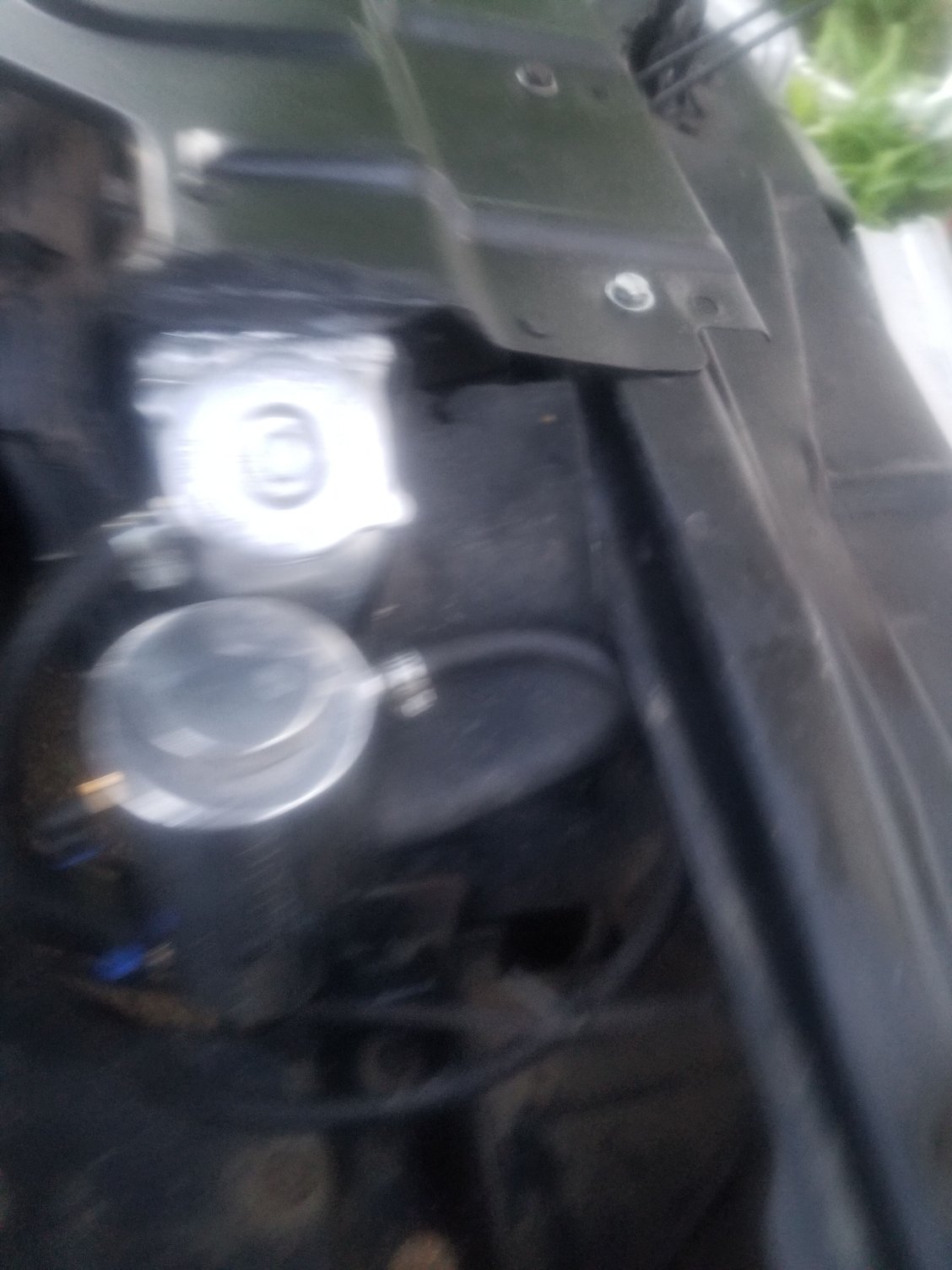

Hmm..so no need to be concerned at the moment (aside from the obvious coolant hitting the ground), correct?
How hard is it to add an overflow?
Old Nov 5, 2022 | 12:28 PM
  #289
Posts: 15,394
An aftermarket setup is simple. Just get the overflow tank (there are many styles to choose from, everything from factory reproductions to basic tanks) and a return style radiator cap.
I have this style Dorman tank on my car. It's available from most auto parts stores, Amazon, Summit, etc.
