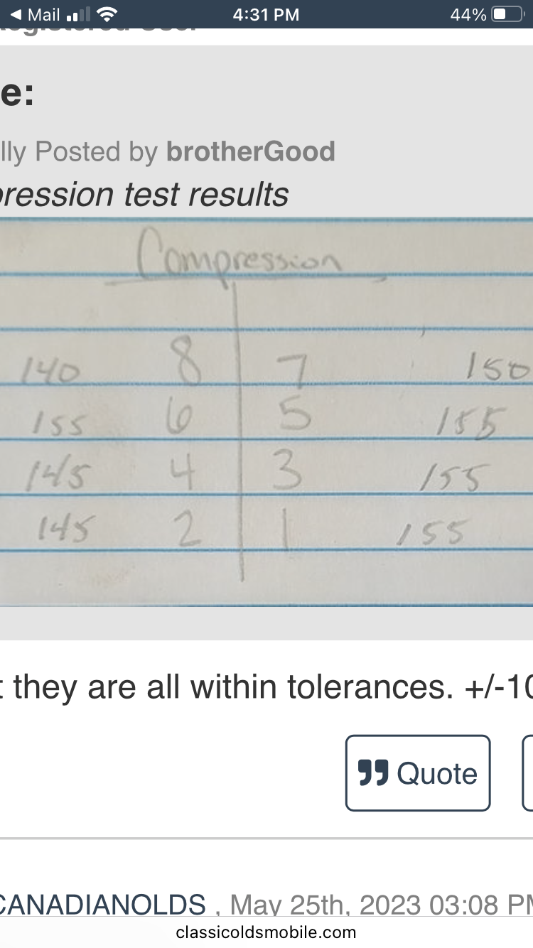

Compression test results
Not good. A low of 140 on a fresh build on one ? Even 155 is low to me for a performance build
I’ll bet that cam is in retarded
At least they are all within tolerances. +/-10%.
on a fresh build they should all be the same

Posts: 16,688
... and closer to 175.
Yes they should at least be close but you’ll have chambers that are different sizes, one head may have been surfaced more than the other etc. And I’m sure he didn’t cc anywhere near all of them.

From: OH
Not that it matters, but Im fairly certain both sleeved cylinders are on this side. While A. It shouldn't effect compression and B. It'd only be the two so I'm not sure why 3 of the 4 are lower on that side.

From: Buffalo NY
Were ALL of the plugs removed while doing the test? Was the battery getting weak? Was it on a charger? Did all of the cylinders "pump" the exact same number of times? Might be time for a leakdown test.

From: OH
Yes.
Didn't seem to be cranking any slower
No.
Counted 5 revolutions each time.
not in my world…even a good old running never apart factory engine is within a couple pounds of each other from what I’ve seen
But this has been apart, and had a valve job done, etc.
that amount of difference on a fresh build is totally unacceptable to me…I’m not being picky.
that’s absolutely crap work if engines come out like that. that’s worse than 60’s assembly line engines
Agreed. But at this point nobody knows why, and that’s the issue.

here’s my guess on what’s wrong and why it’s idle vac is low.
the cam is in retarded.
second problem, when the deck was cut, it wasn’t cut the same on each side, or front to back.
the crank psi gets progressively lower on each bank from front to back , with the exception of #6 which
they are all evenly down, side to side, front to back..that’s a dead give away of incorrect machining …the crank psi drops front to back
i put money on the front deck being cut more on the front, both sides, and less on the right bank

My fix, if this is the problem.
pull the heads…check piston deck numbers. If they are out of whack. Cut the heads to get the cyl CC the same on all 8
correct the cam ..I would still put it in 6 ahead with a 102 int cl

Should have ditched the pos when he saw this.

Had it not been the original engine, I probably wouldn't have even bought the car.
