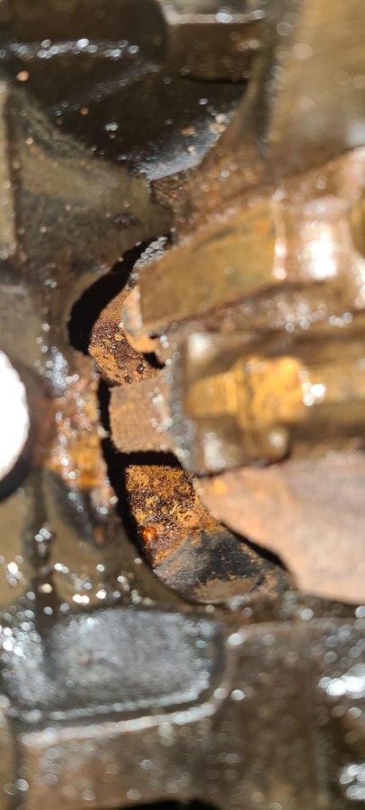

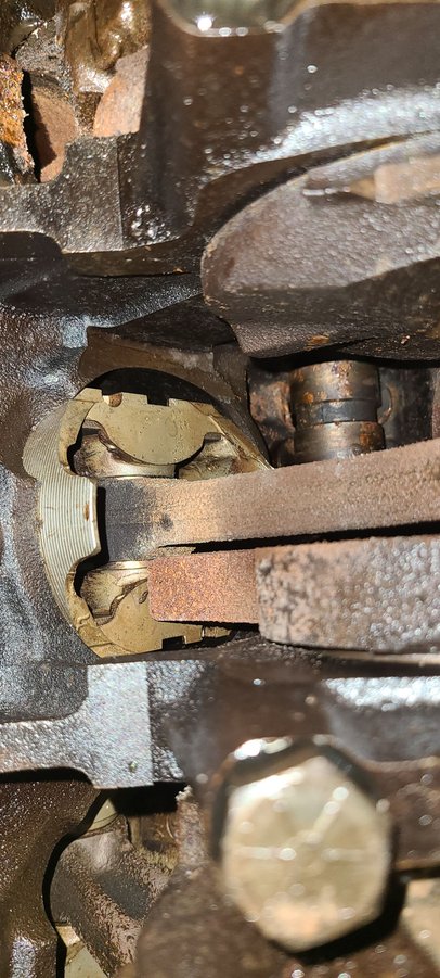

Bummer! That's a scary sight under the skin .
Old Apr 17, 2021 | 06:16 PM
  #42
brotherGood's Avatar
Joined: Apr 2021
Posts: 1,380
From: OH
Yeah..the pissed off gearhead in me is saying either walk away, or try to see if it can be saved. At the end of the day though, it's going to need a lot more machine work than my budget had allowed. I could continue as planned and just utilize the down time to focus on other areas of the car while saving up for machining..because I do understand it's a numbers matching car that deserves better than its had the last decade plus, but its still a big chunk that I didn't expect to be spending.
That's even IF it can be saved via sleeving it.

I kind of agree. Listen, when it comes to muscle cars I'm definitely an originalist, so it pains me to say this, but it really sounds like the universe is telling you to dump in a 455 and be done with it.

It looks really scary. But who knows? After an acid bath, maybe it's workable (fingers crossed).

I would be VERY surprised if you can get the pistons out without breaking them. Not that they would be worth anything other than scrap metal, I bet the engine would clean up with a overbore.
It’s a good thing there was antifreeze in the cooling system, chances are you don’t have to worry about cracked blocks from freezing.

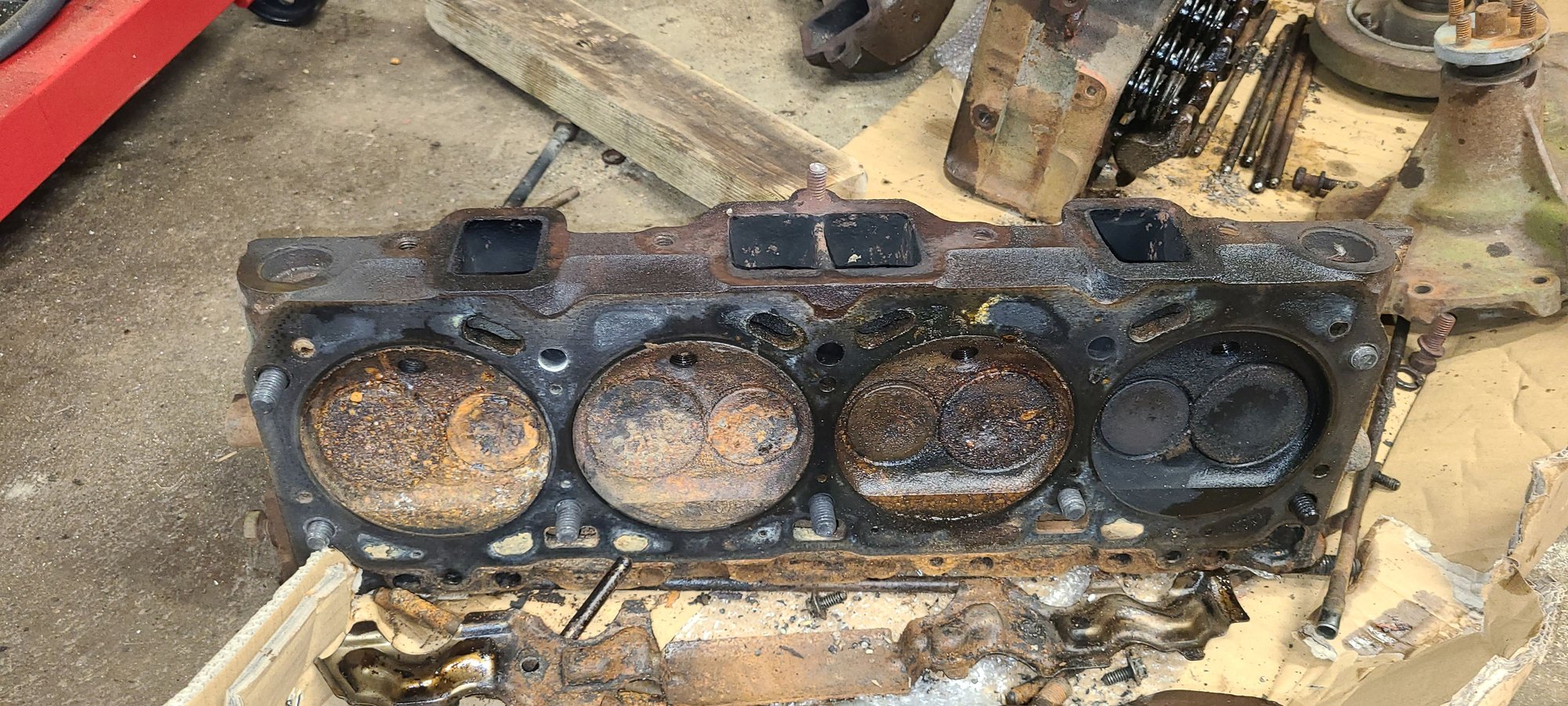

Just went out and flipped it over and pulled the pan. It looks much better than the lifter valley does. There is some scaling on the rods and crank, pistons look pretty decent. There are some portions of the cylinder walls that you can still see crosshatch, but then another that looks pretty gross. Didn't see anything cracked, but once we get the stamps back over here we'll mark rods and caps, and try to get the pistons out.
Also grabbed a couple shots of the underside of the head, showing the valves.

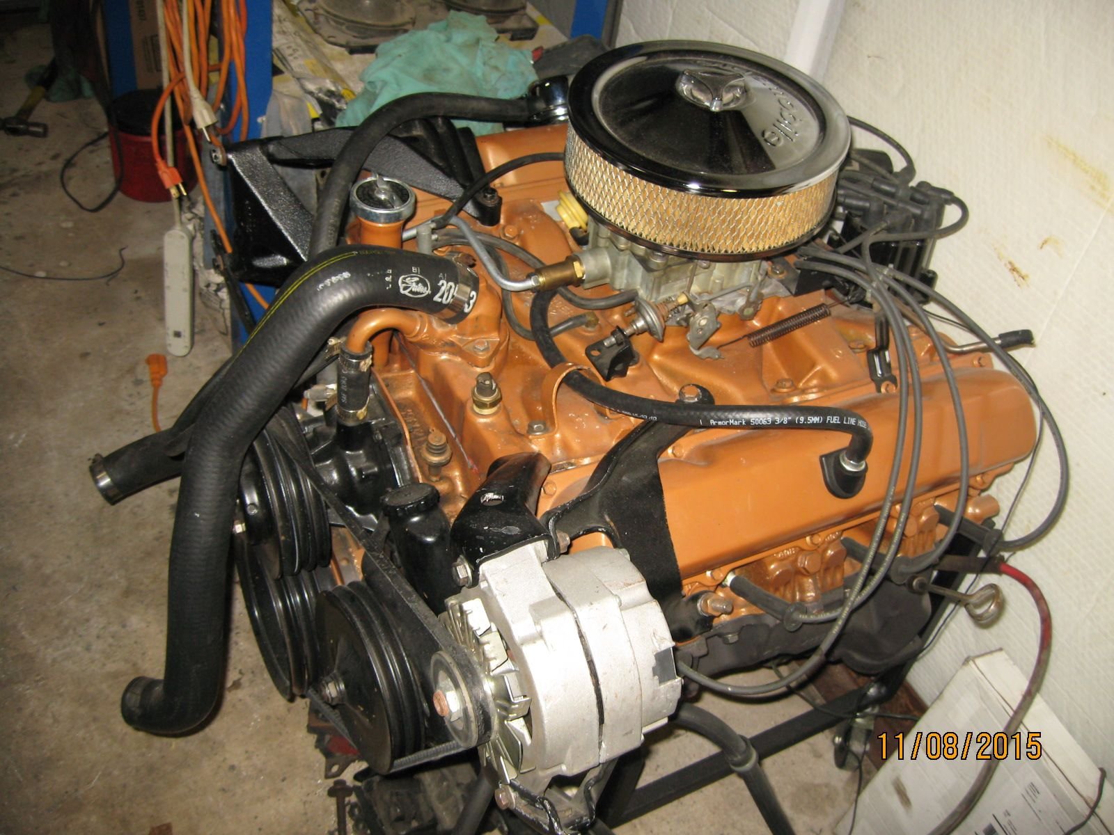

Put a 455 in it. Paint it Oldsmobile 400 gold.
Bronze. Don't ask me how I know this.
Did the same thing for my 69 442. I used a J intake and a 251 carb as well.
So am I not the only one with this idea? Nice.
Mothball that 400 for later. 455 it. 455 it. 455 it. Paint it bronze.

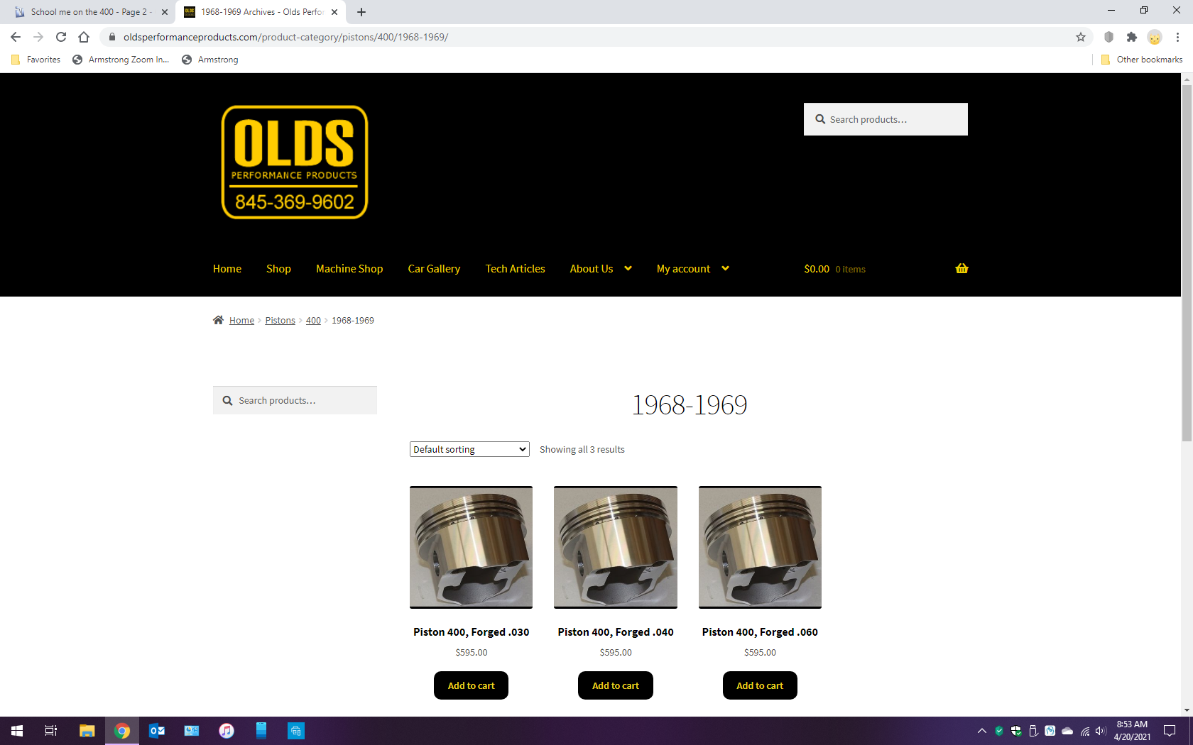

Might as well get started sourcing pistons now. When I was building my G-block, the only 0.030 ones available were cast aluminum from Egge. Hopefully for you, things have changed by now.

I heard (earlier on this thread actually) that small block Mopar pistons work well. Once I know for sure what I'll be looking at (size wise) I'll track all that down for sure.
