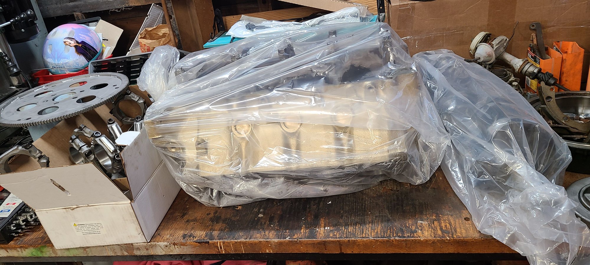

Old Mar 4, 2022 | 02:30 AM
  #187
brotherGood's Avatar
Joined: Apr 2021
Posts: 1,378
From: OH
Heads are back..so I'm officially done with the machine shop.
Gonna try to get the axle back in the car this weekend, and focus on taking inventory to make sure I have what I need, and get it all together to make sure it all gets to the assembly shop..ha
Old Mar 4, 2022 | 06:45 AM
  #188
BackInTheGame's Avatar
Posts: 2,471
From: Colorado - Front Range
Awesome! This has been following along - thanks for sharing with us!
