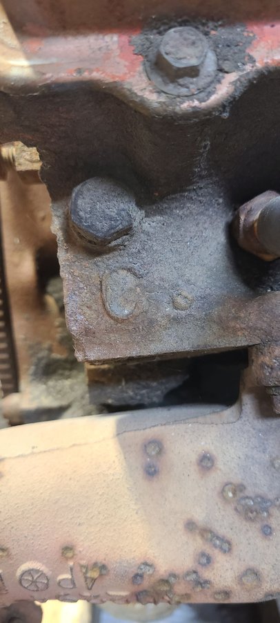

Went out when I got home and snapped a couple pictures. Grabbed the VIN off the block, gonna have to check out the car when he gets back from vacation.

Also, the Vin had 39Z..based on above, is this a different production facility?
Old Apr 12, 2021 | 09:28 PM
hurst68olds's Avatar
Joined: Dec 2010
Posts: 1,580
From: Las Vegas, NV
3 = Oldsmobile
9 = 1969
Z = Fremont, CA assembly plant
Old Apr 12, 2021 | 09:35 PM
Posts: 9,477
Yes, Fremont, California.

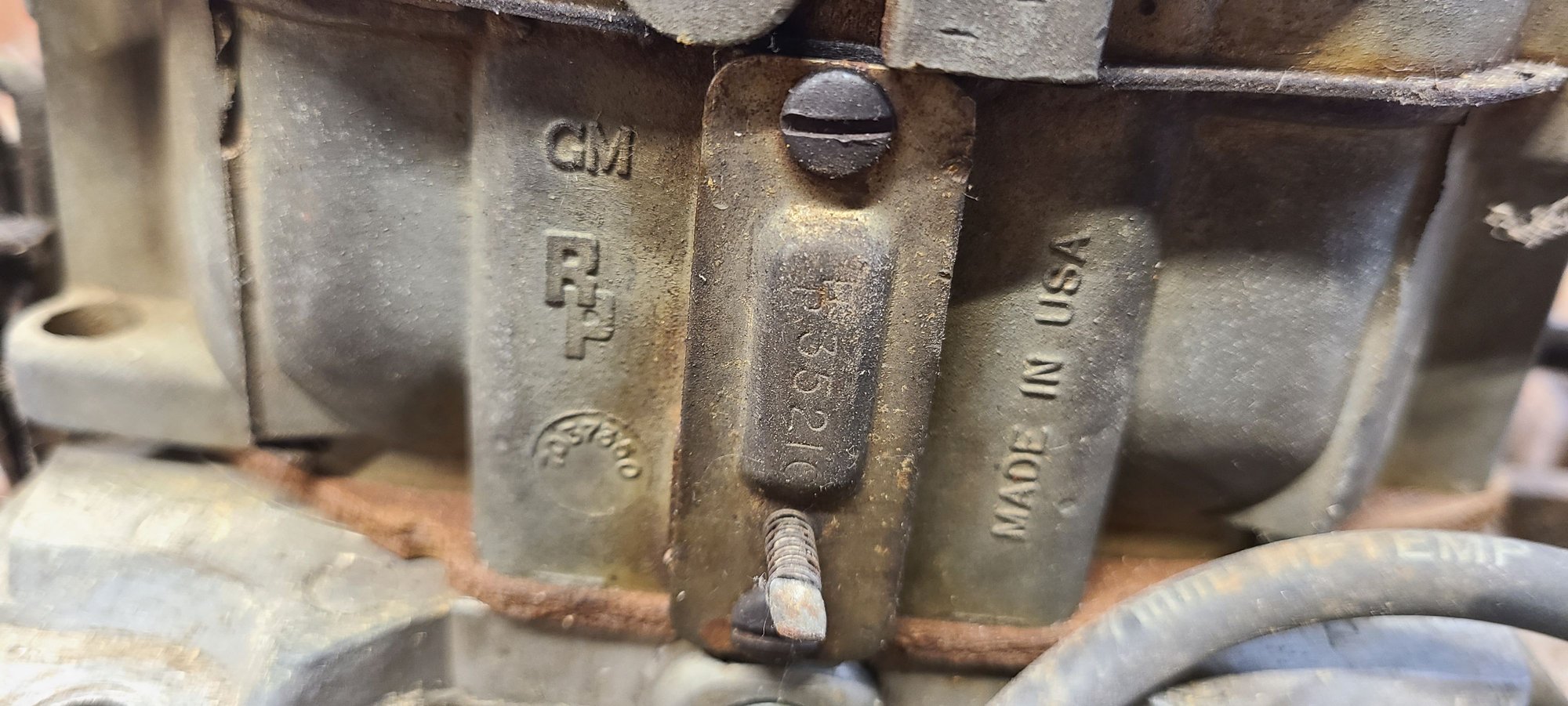

I did run the numbers on the carb last night, it is coded for the same car..Ill need to figure out the date code and compare that to the car once I get more info on it.
The correct carb would be 7029251, which was used on every 1969 Olds big block (400s and 455s) with AT except the W30. It's pretty common.

Forgot I had these..ha

That's a service replacement carburetor built the 6th day of 1972
Oh, okay. Well, I'll feel less bad about sticking something I'm more familiar with on it then..
Its been a while since I messed with date codes on a Qjet, so I couldn't remember which one I needed to look at. Nothing against a replacement though, as I'll probably still keep it for whenever I sell the car. (Again, assuming things don't change and I'm able to buy it)

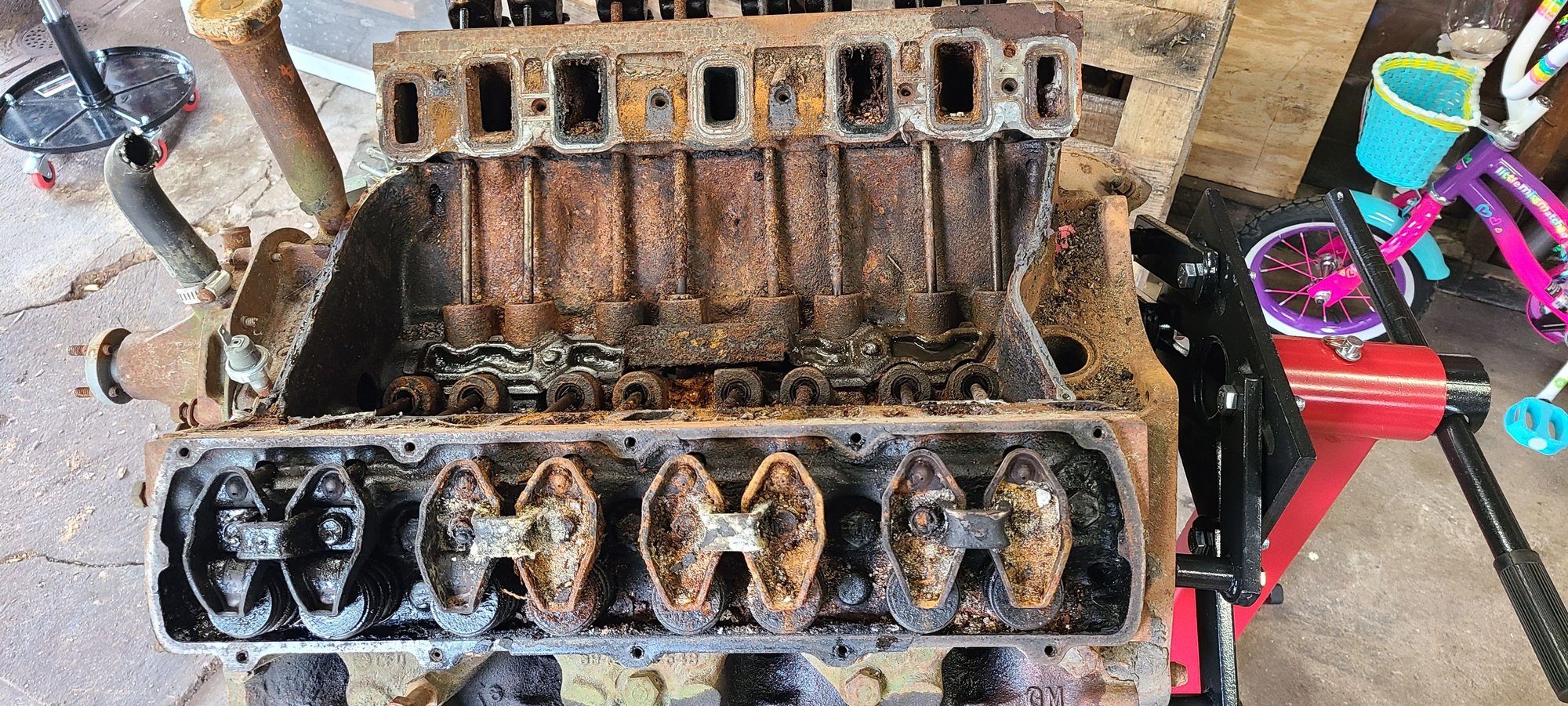

Not good. Can't get it to spin, so I went ahead and pulled valve covers and intake...this could be a sign as to why it won't spin.

Drivers side head is off.

Well that is downright ugly.
