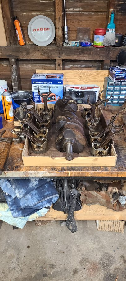

Went out this evening, was able to get the crank to lift on both ends (engine upside down) and very slightly turn using the nut for the balancer. Naturally, it seems to still be stuck due to the 2 pistons that I cannot get to the rod bolts. The next plan is to slowly soak all pistons and remove them leaving only the 2 that are still bolted in, and the 1 that has the crank in the wall.
I'm really hoping I can get it torn down by Saturday so I can get it out of the middle of the floor, for when the car arrives, but I also don't want to rush it and create more work or expense in the process.
Also, it's quite the task trying to position to pound out cylinders with the crank still in the way.

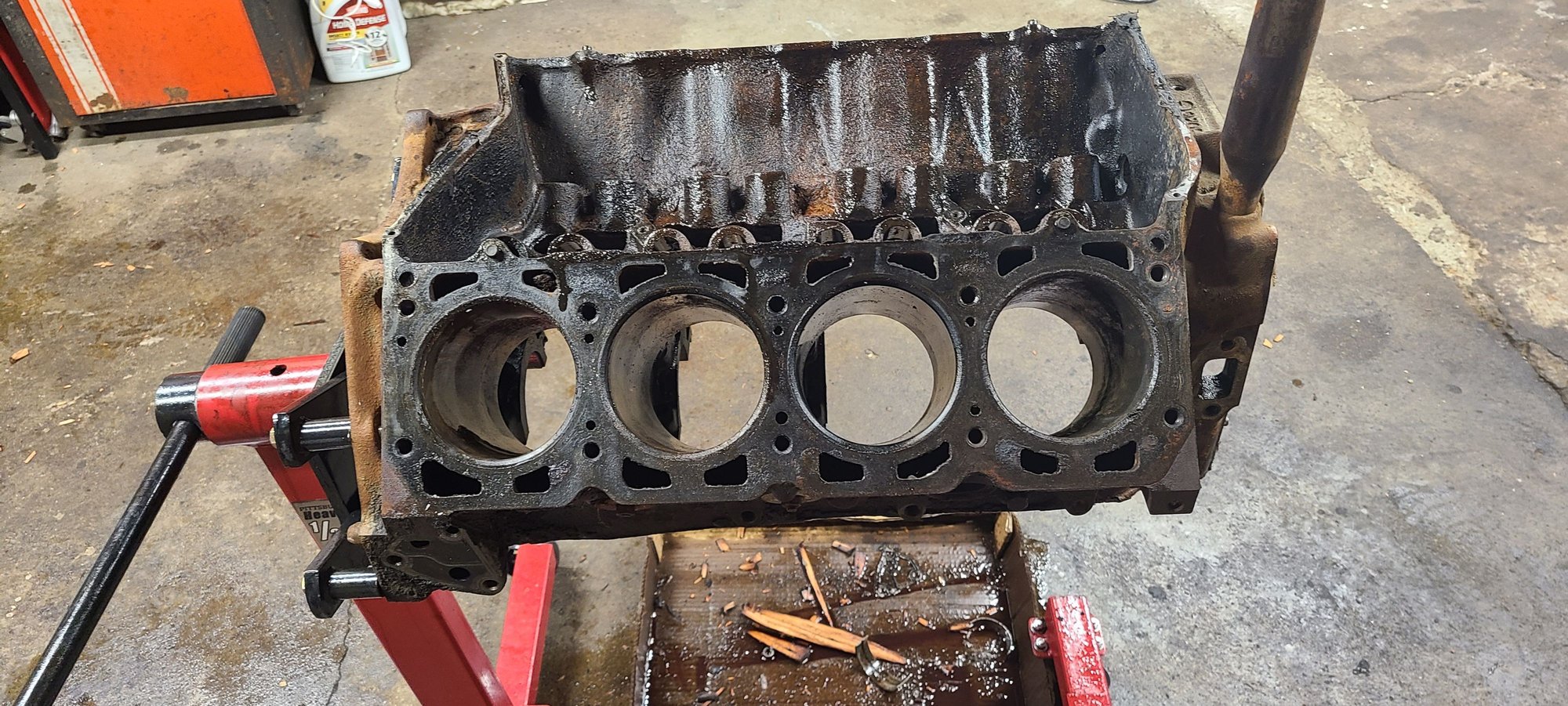

Well..they're all out. Gonna need a couple pistons after all, but the bores actually look pretty good considering how they looked when pulling the heads off.
Now, next step is the machine shop to see if there's any more damage or if a cleaning (and one sleeve) is it. Still kinda torn on potentially boring it out since I'm already there, but I know I've got a lot to learn still.

As far as what's visible, I'm feeling pretty good about it..but then again, I know there's a lot more to it.
I'm gonna probably give it a week or two to start combing through the car when it gets home, then go ahead and drop the block off (probably heads as well). When I spoke to the machine shop, they said they had a 6 week lead time on work being done, but if I'm going to need to do a lot more to the car than anticipated, I may hold off for a bit and continue to research and prepare.
