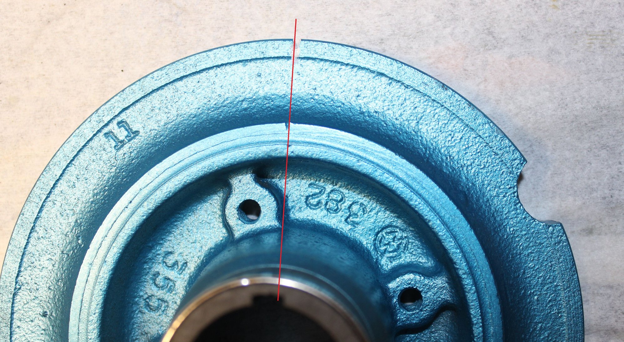

Check your harmonic balancer. The timing mark should align with the keyway in the center of the balancer.
If it's off substantially then your balancer may have slipped.

It was a brand new balancer when assembled. I have heard the new balancers are questionable, so I won't necessarily rule that out (meaning, they don't line up correctly even when new)

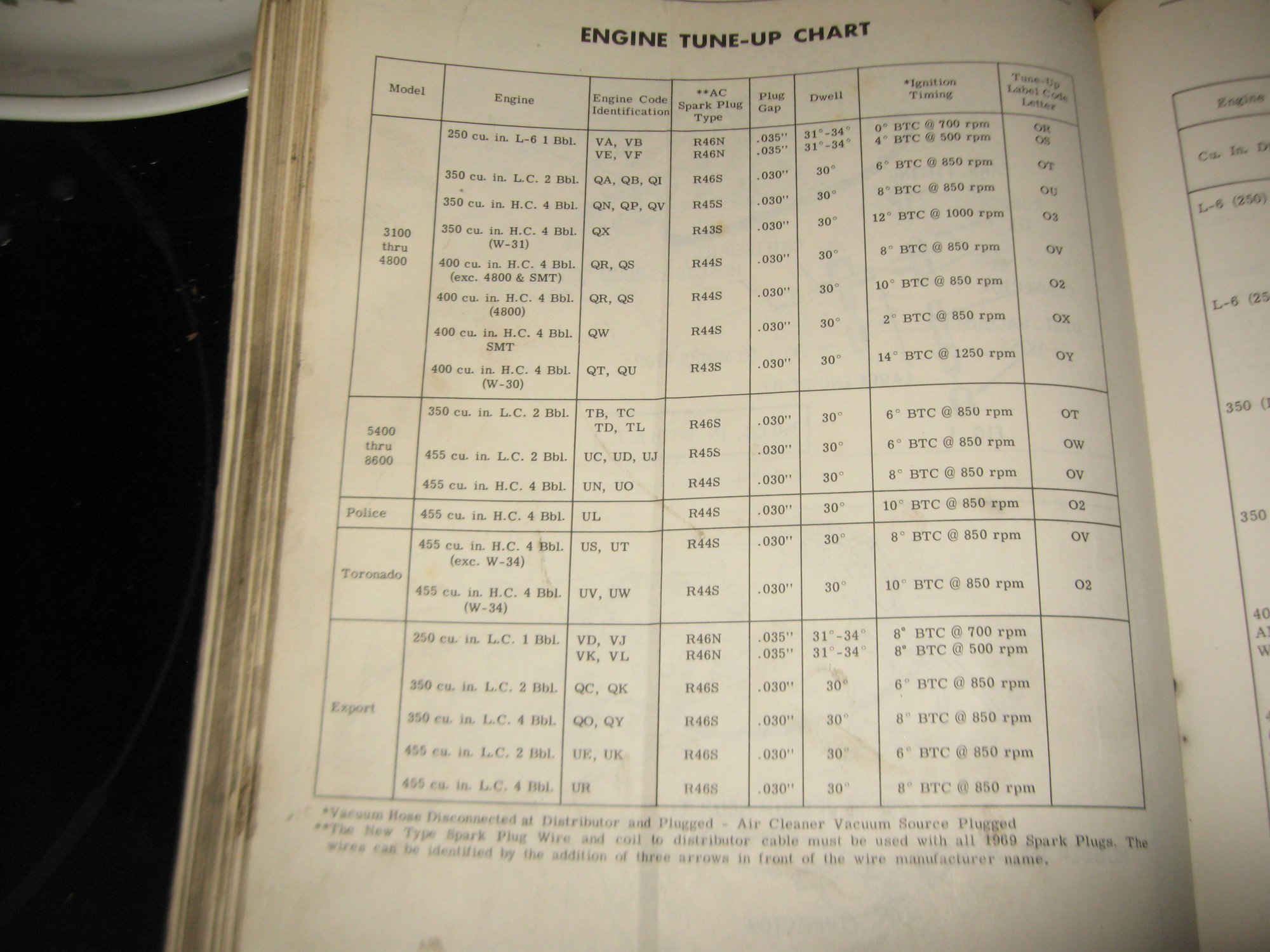

Not for nothing but those are pretty cold plugs. Factory called for R44's that are difficult to find but R45's may be just the ticket. Continued good luck. The car looks great.
Really? I thought factory were 43S..to which I can't run the S due to it being too long

Correct, the plugs should be the R44S. From the 69 CSM. I don't recall them being longer or shorter for the resistor plug though.

I would stay with the R43. To my mind, it's better to go a step colder than a step hotter as long as your ignition has enough spark to keep 'em clean. FWIW, I think Adam sold me the last R44S in captivity a couple years back.

I was curious, so I had to check. It seems these are all the same length. R43S, R44S, 44S, and R45S. Not sure why you would get piston interference.
Taking a 2nd look, the R43 S IS a tad shorter, so there ya go. Back to good luck with it all.
the suffixes on AC plugs have to do with the length, thread size, etc of the plug. The number is just a heat range.
So if the number changes but the suffix doesn't they should be approximately the same size and depth into the combustion chamber.
44 plugs were the older version that did not have an extended center electrode. At some point they figured out that extending the electrode and porcelain further into the combustion chamber would improve flame travel and help keep the plug cleaner. So they added the S suffix which were extended center electrode plugs. ie. 44S.
As all the 330, 400, 425, 455 engines used the S plug, it is puzzling that the piston is hitting his plugs and closing them. As this is purely mechanical, either he has stock rods and crank but his piston dome height is unusually high. Or he has non-stock rods (perhaps crank) and/or pistons that mess up the height of the pistons. Or he had the deck and/or the heads machined so extensively that the non-stock pistons protrude into the combustion chamber. Clearly a not well thought out build.
