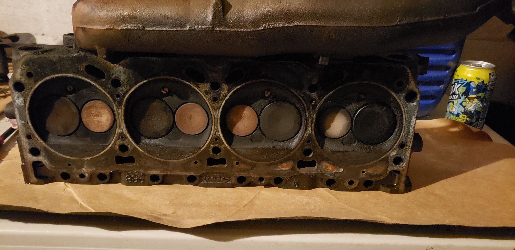

Going to test with liquid but already you can see the carbon creeping into the seat.

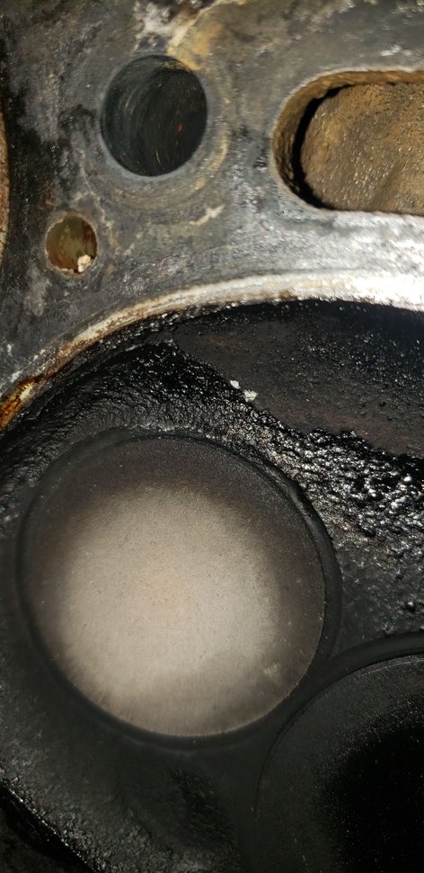

Carbon on pistons
Does anyone know a good trick to clean the tips of the pistons without getting gunk on that top compression ring? I just finished the cleaning for the head gasket on the drivers side.
Does anyone know a good trick to clean the tops of the pistons without getting gunk on those top compression rings? I just finished the cleaning for the head gasket on the drivers side.
Old Nov 16, 2024 | 02:04 PM
  #92
OLDSter Ralph's Avatar
Posts: 5,215
From: St. Paul Minnesota
What did you use on the head gasket surface to "clean" it ?
Old Nov 16, 2024 | 02:51 PM
  #93
Sugar Bear's Avatar
Posts: 4,098
Is the piston in cylinder #5 chipped/gouged? How was #5 compression?
No thats just carbon buildup that is peeling off. It somewhat has been since I opened it up. I assume that's happening because of the oil I coated the cylinder walls with. The compression was 30 but the exhaust valve is very obviously burned. You can see it in a few pics I posed earlier. If you mean that little notch on the left side of the pistons, thats supposed to be there on the factory pistons.

Old Nov 18, 2024 | 02:07 PM
  #96
CANADIANOLDS's Avatar
Joined: Sep 2013
Posts: 2,924
Was the factory steel shim gasket on it?
If it was, you should try to find one original gasket to put back on. If you go with the typical fel pro ones , you’ll see a 10 to 20 lbs compression less than the other bank.
to leak check the valves you pour the fluid in from the port side, not the camber side. Face exhaust ports up and fill to just above top of valve or half fill the port. if you don’t get leakage on that bad cylinder, then it’s probably a stuck ring. you’ll be in the same situation after the valve job
if that exhaust valve was sealing ok after testing and actually looking at the valve seat and valve face. You shouldn’t even put the head back on.

Hi so here I'll put these up again for reference. So you can see both the exhaust and intake valves on the affected cylinder are very different in color than all the rest. Even the valves on the other head look like these left three. I haven't preformed the leak test yet. I got covid for the first time.
See here the carbon is building up right in the seat. So this is just going to be as close to stock build. Are you saying its not necessary to plane the bottom of the head? Because if not than I won't. Yes they were the factory steel gaskets, they weren't in terrible shape either. Also I tried to see if I could fit the thinnest feeler guage past the rings and I could not.
Old Nov 19, 2024 | 03:32 PM
  #98
Joined: Sep 2013
Posts: 2,924
Originally Posted by Slick66
Hi so here Ill put these up again for reference. So you can see both the exhaust and intake valves on the affected cylinder are very different in color than all the rest. Even the valves on the other head look like these left three. I havent preformed the leak test yet. I got covid for the first time.
See here the carbon is building up right in the seat. So this is just going to be as close to stock build. Are you saying its not necessary to plane the bottom of the head? Because if not than I wont. Yes they were the factory steel gaskets, they werent in terrible shape either. Also I tried to see if I could fit the thinnest feeler guage past the rings and I could not.
you need to pull the valve to check the seat in the head and the valve to see the condition and if it’s burnt
stop trying to guess by the colour..pop the valve out. but first pour fluid in the port. the heads may not need surfacing…don’t do what you did to the block, to the heads…that’s gonna kill the seal. that chamber is oil soaked, not gas/carbon.
steel shim gaskets can be reused..I’ve done it many times. clean the surfaces first and then spray both sides with Permatex ultra copper

Ok yes I'll test them, remove the valves and then look at the seats. I can't reuse the existing head gaskets, they were both stuck and both have rips in them now from when I took them off plus they got bent pretty good. What do you use to clean the heads them with? Do you think there will be any trouble now with the seal to the block?
