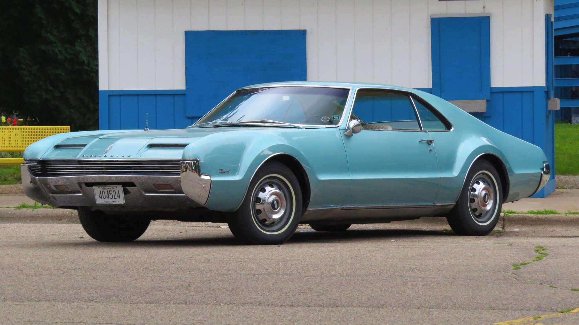

Originally Posted by Slick66
Ahhh beautiful! Love the tires. Love that you kept the rims the way they are. Drums stop this car just fine! Color looks origional too. Sorry it has 92000. I got it at 89000, drove it just about every day. I think majorly its running so poorly because the exhaust valve is damaged. I have a friend with an emaculate '69 442 with a mildly built 455 in it. He's suggesting we take off the heads. How many psi does your compression read? Do you have any problems running 93 octane?
That is my Toronado DeLux, It has been repainted GM paint code K, Oldsmobile color "Ocean Mist". It has 99,900 miles and the engine has never been touched. I found no reason to do a compression test because it runs so good. I run 93 "Non Oxygenated" fuel. It gets about 12-13 mpg.
The transmission has been overhauled and a Tran-Go shift kit installed. The transmission had slippage issues when I bought it.
Tires are Milestar MST P235/75/R15 White Wall tires (6 months old). They are 40,000 mile tire. White wall tires in that size are scarce. I got them through Discount Tires.
The drum brakes work just fine, the car will cruise at 75 MPH on the freeway. It doesn't over heat when cruising very slowly at just above an idle. In fact it has never got hot.

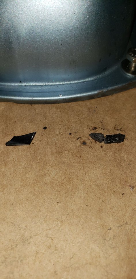

Hey guys, so I have decided to take the heads off to get them done. The chassis service manual shows different specs for 425 heads. I belive my engine has the 39 degree lifter bank angle. They are B heads. As far as removal and instalation, is everything procedurally and spec wise the same as the other 425's? Is there anything I would need to tell the machine shop that would be specific to Toro heads? Also on both driver and passenger side closest to the rear, I found these pieces of rubber in the oil ports. Has anyone seen this before and could maybe tell me what they think these pieces are from? Greatly appreciated thank you.
Old Sep 29, 2024 | 07:29 PM
  #68
Sugar Bear's Avatar
Posts: 4,098
Most likely they are pieces of old valve seals.
Thanks Sugar Bear, I was hoping someone would say just that.
When I took the valve covers off my '66 Toro to replace the valve cover gaskets I found a few pieces just like that. The consensus on here was valve seals.
Thanks ourkid2000, that's what I was hoping they were.
