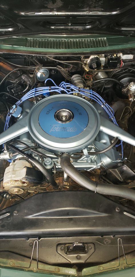

Here she is by the way

Nice looking ride...!

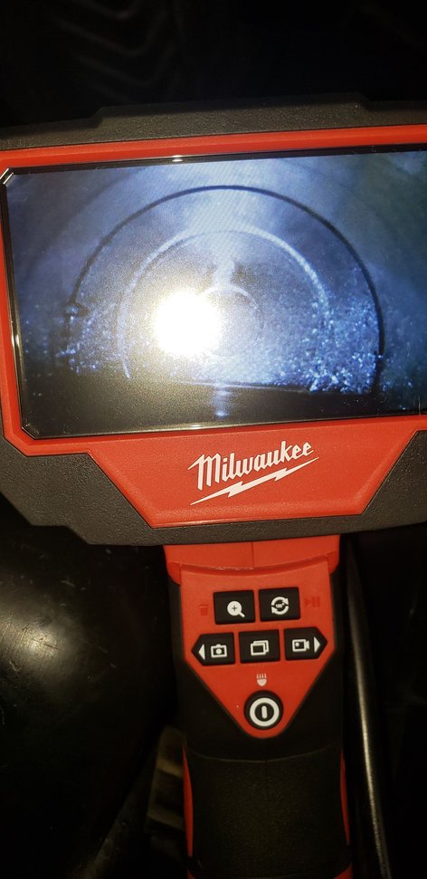

Was re-reading post #7 again, often problems are where the last work was done. Check the wiring on the primary on the coil to confirm that the - goes to the distributor/black wire. Wires from the ignition switch and the starter go to the coil +. Check that the secondary/high voltage coil wire ends are making good contact, try another coil secondary/high voltage wire if you have one. Often problems are where the last work was done.
About rebuilding the current engine, I agree with doing that vs. another engine. 39 degree camshaft and .921 lifters may be harder to find, other than that it's pretty straight forward.
Cylinder wall scoring was mentioned in another post. Do you have pics?

Scoring too difficult to even see in the borescope screen through a camera

So they are there belive it or not. You just can't really see them through the phone camera. They are pretty light there is one line resembling a bit of a heavier scuff.

Hard to tell from the pics, from them it looks very minor...
Is the top of the piston pitted or is that just the picture quality?

it looks to me like an even glazing of carbon. There have been times where some of that has been missing and exposed the piston. From what I've seen of that the metal looks in good shape. This is why even though I have such immense blowby, I'm wondering if something other than rings has any conceivable way to contribute to it.

Have you actually diagnosed why you have low cylinder pressure in one cylinder / Until you zero in on the problem, you are just guessing. Do you have stuck rings or leaking valves ? How many thousand miles on the engine ?
As far as "advertised compression ratio", actual compression ratio's are generally lower (almost always). Unless you can tell us how far the piston sits down in the bore, and what the combustion chamber volume is, you're just guessing.
Olds engines are very rugged. Take the car to a competent mechanic and fix the problem. You may not need a complete overhaul.

Cracked blocks/heads etc. aren't that common. Symptom are overheating, white smoke from the exhaust and coolant loss both externally and/or internally.
From a cracked casting perspective my $ is on it's fine.
