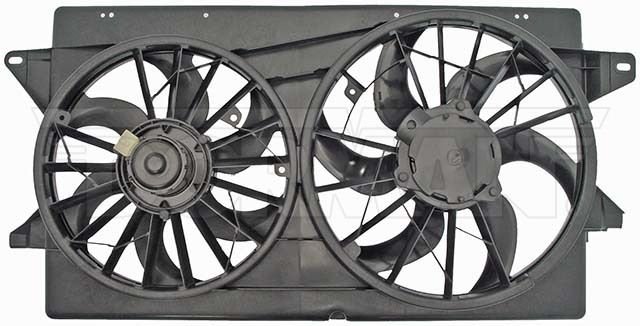

The Dorman 2000 Ford Windstar dual electric fan for $100 seems like a good deal & it supposedly fits in the factory place with very little modifications. Specs shows it pulls 4,500 cfm and each fan pulls around 25 amps.

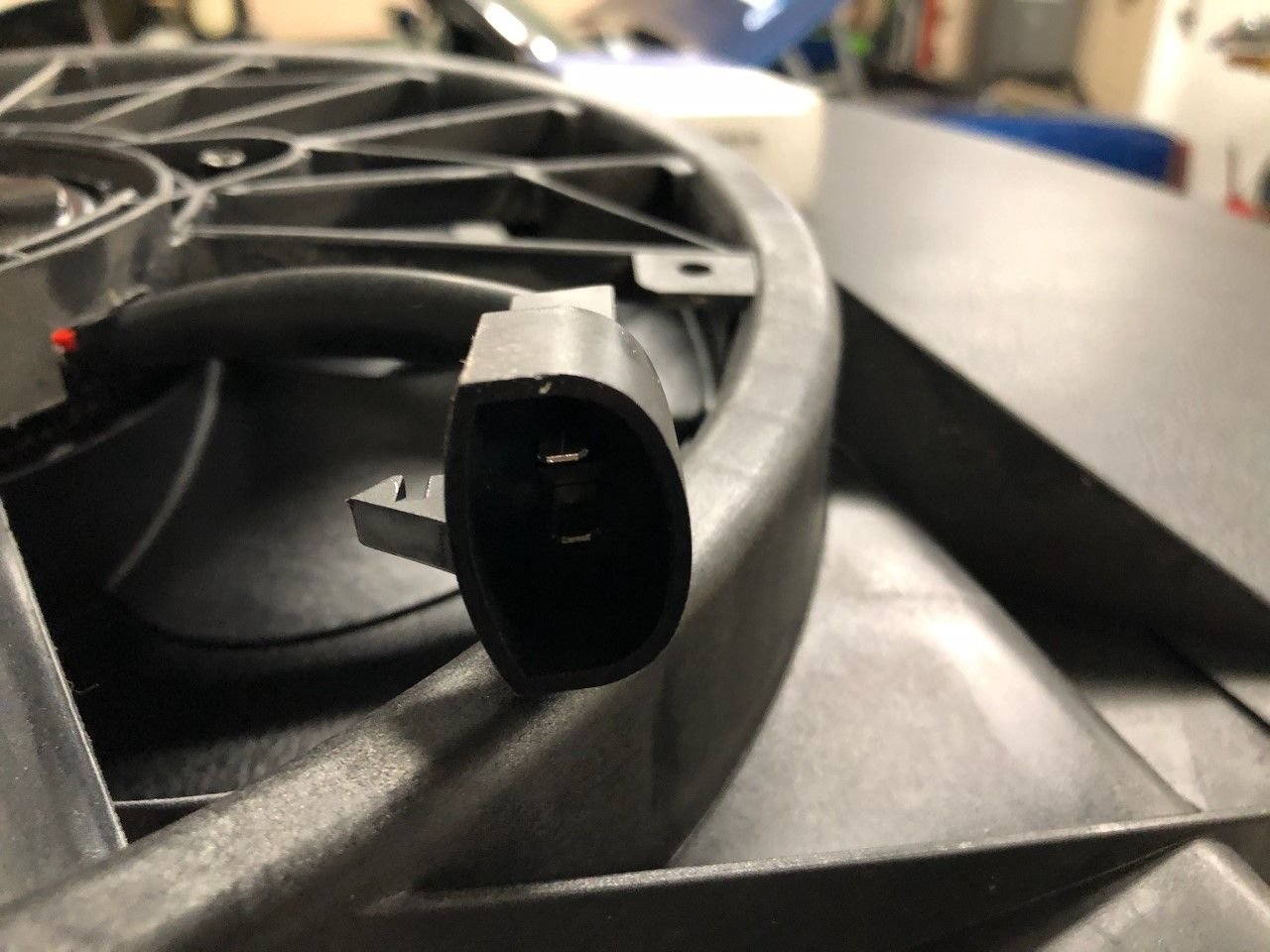

I got the Dorman Ford Windstar fan. It comes with one 3 prong and one 2 prong fan connection. Any info on how this wires up using the Davies Craig Digital Thermatic Fan Switch?
Old May 21, 2021 | 01:58 PM
pettrix's Avatar
Joined: Aug 2018
Posts: 1,098
From: Utah
I think I figured it out. The 3 pin is just an extra pin for the AC control but it is not used on applications like ours. It's just 2 pins (positive, negative) for each fan.
Will wire each fan to the Davies Control unit and done. Using 8 or 10 gauge wire from fan to Davies relay.
According to specs, each fan uses approximately 22-25 amps.

Are those 2 speed fans? If so, I bet one pin is a common ground, one pin is the low speed, the remaining pin high?
Old May 21, 2021 | 06:37 PM
pettrix's Avatar
Joined: Aug 2018
Posts: 1,098
From: Utah
No, they are single speed.
I believe the 3rd pin is for factory AC

Those really are great fans. I have them on my 71 with a Champion 2 row rafiator and it stays dead nuts on the 180 t-stat no matter the conditions. I have the 2nd fan set to come on at 205 and I am guessing it works but has never triggered in the 4 or so years I have driven the setup.

The fan hits the lower radiator hose. Would have to cut the fan housing to make it fit.
Are the push through zip ties an acceptable way to mount the fan to the radiator?

Those push thru zip ties will eventually destroy your radiator. That’s too much weight, with too much vibration on the radiator core.

I was thinking of using JB Weld to epoxy a bolt onto the radiator and using it as a mounting stud on the solid part of the radiator. Then using the mounting stud on the fan to run a nut/washer to tighten it down to the radiator.

The windstar fans have 4 mounting pads on the outside. Make some brackets out of flat stock and bend them to fit so you can mount the fans to the radiator support. As far as the lower hose you will need to cut the shroud around the hose outlet a little. Pretty minor fabrication but easily doable without many tools.
