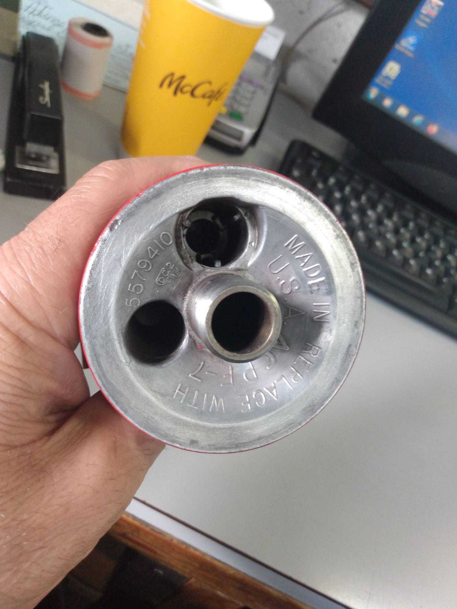

Just had to share some of the stuff I see in this crazy business. I am "fixing" a supposedly "just rebuilt" 425 for a customer. I am getting close to done and asked him to bring me the oil filter adapter so I could bolt it on.

No bypass valve for the filter. Without it the oil was just coming in one hole and going right back without going through the filter

This is what it should look like.

And the return valve removal was a good way to let a good engine destroy itself.

Oh and actual thread topic? It never ceases to amaze me at the lack of soul or caring when shops and supposed engine builders pull. Don't give a "care".
