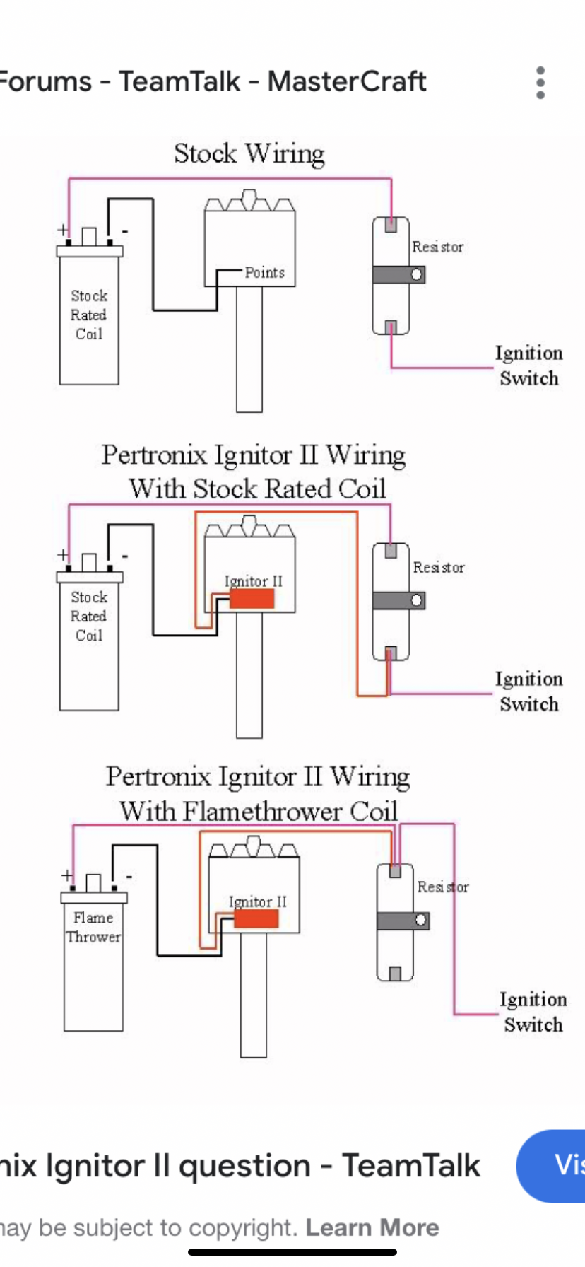

It works the same as points. It has the wire to the negative side of the coil and the power feed & 12V bypass to the positive side of the coil. It's the best simplest bolt in ignition I have ever used. Why anybody would use a Pertronix when you have this module that requires absolutely no cutting or splicing wires or the need for a ballast resistor.
https://wiringharness.com/breakerless-se-ignition
there is no need for a ballast resistor when using the Pertronix module…don’t know where you got that from. if a stock coil has one, and you install the Pertronix with a stock coil, you leave the coil and resistor as it is. new high output coils don’t need a resistor so they get used without one when it’s used with the pertronix
there is no cutting and splicing of wires. each wire goes to a connection point where there already is a connection.

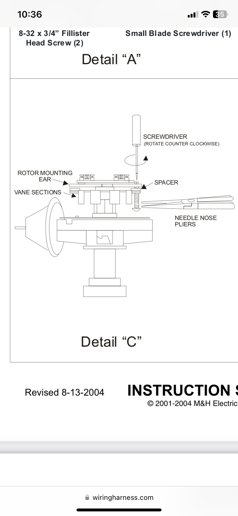

the pertonix is simpler and easier to install because there is no special rotor mods needed like the M&H .
the pertonix is simpler and easier to install because there is no special rotor needed like the M&H .
I have never used a Pertronix but years ago I saw one that required the use of a ballast resistor. I've never had to use any special or different rotor button with the M&H module.
you have to modify your existing rotor mount for the reluctor. It has to be exact or your window openings in the wheel could cause a difference in spark timing to each plug. There’s spacers to adjust the spacing. Rotor needs some mods too

you have to modify your existing rotor mount for the reluctor. It has to exact or your window openings in the wheel could cause a difference in spark timing to each plug. There’s spacers to adjust the spacing
It has been a while since I used one and didn't remember that. I stand corrected.
