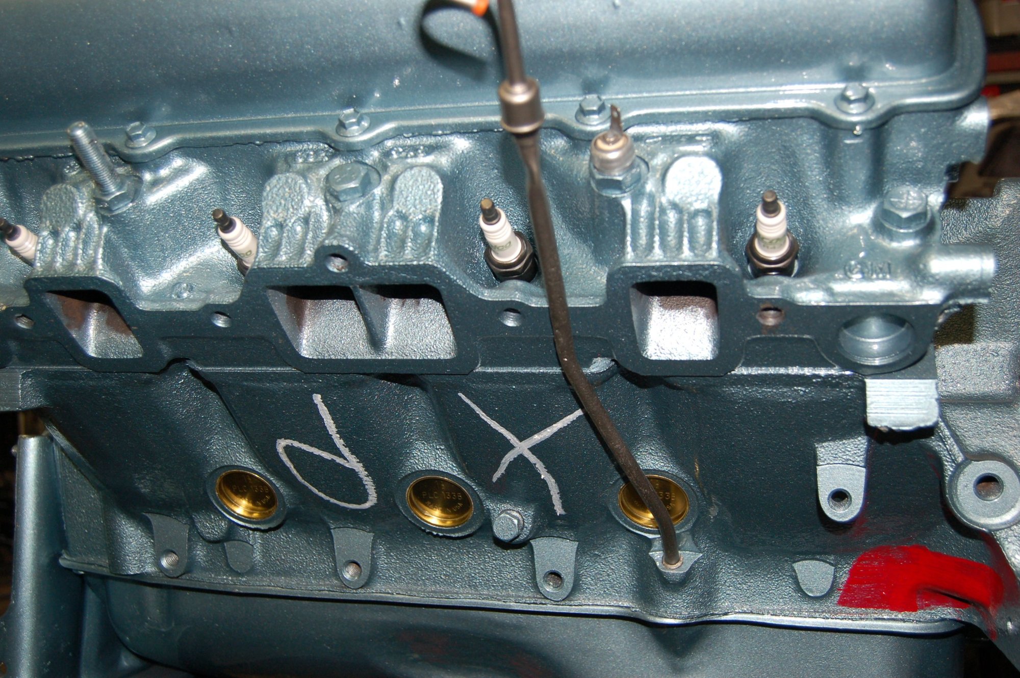

Originally Posted by halfmoontrail
More questions:
*The Toro 455 still has its starter, is the configuration okay for the A-body?
*Oil dipstick and tube configuration on the Toro 455 okay for the A-body with my W/Z exhaust manifolds?
The dipstick will be fine.

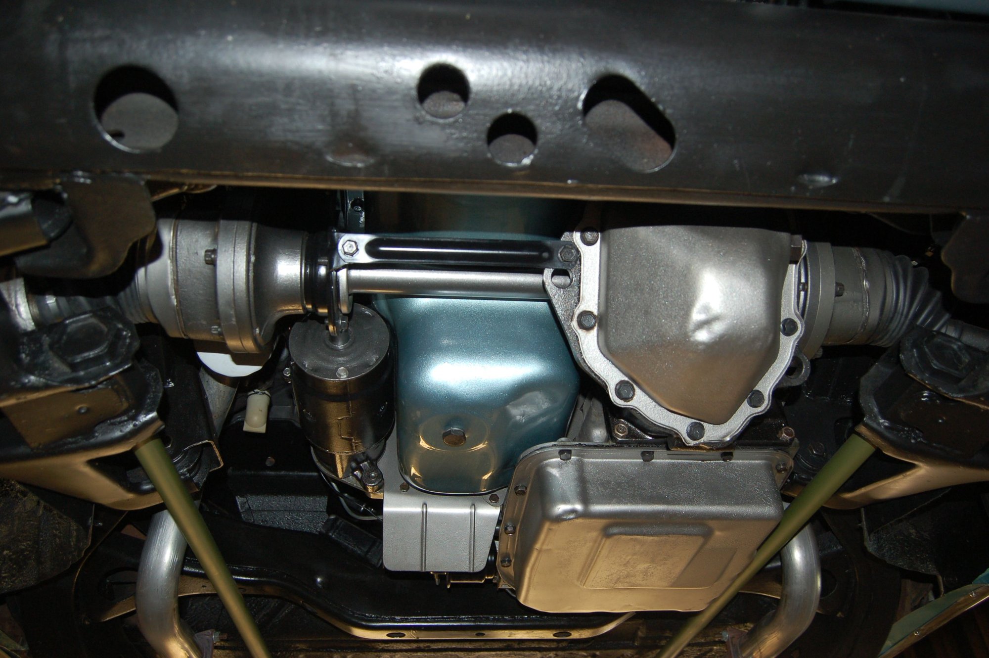

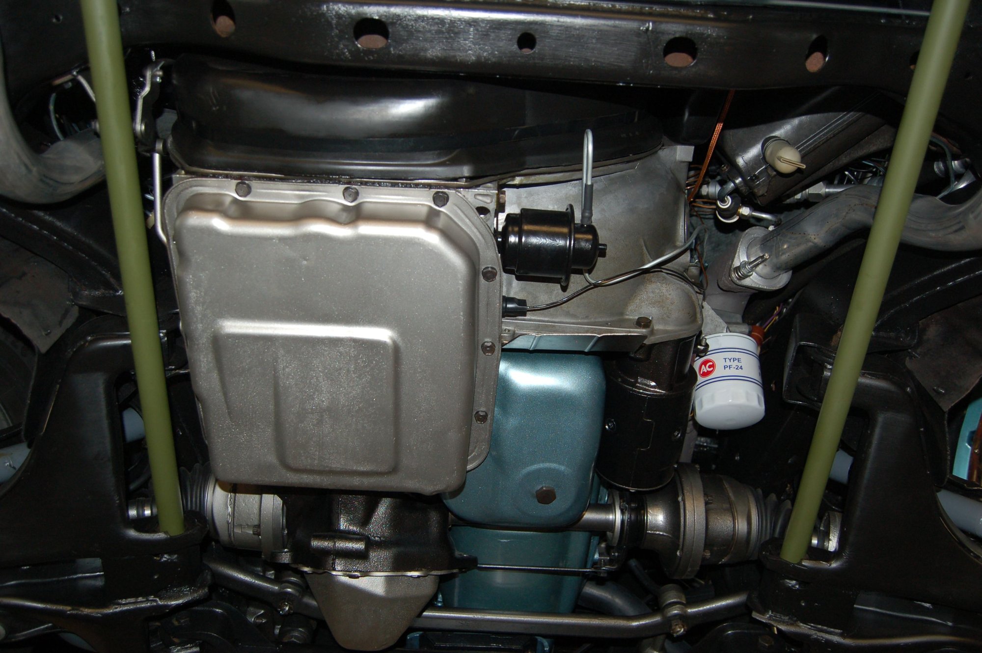

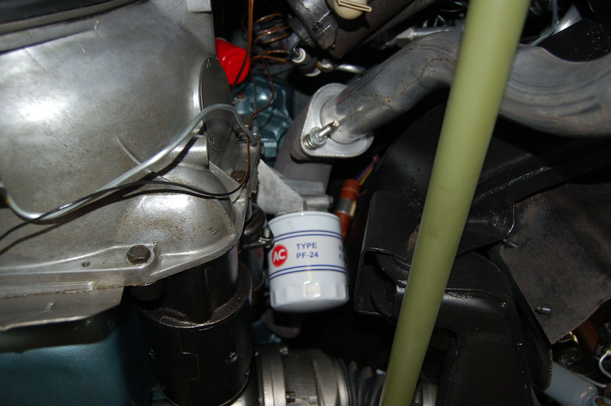

The Toro starter bolts to the Toro trans, not the motor. So, no it will not work on a RWD bellhousing. You can swap the Toro and Cutlass starter nose cones to use the larger Toro starter windings with the cutlass nose though. Use the oil filter adapter from the 350.
Toronado Starter mounting:
Old Nov 10, 2024 | 04:20 PM
Posts: 50,768
1. Yes, the adapter off of any RWD Olds motor.
2. The Toro starter bolts to the Toro trans, so it won't work in the RWD configuration, HOWEVER, you can swap the nose piece from the 350 starter onto the Toro starter. Of course, that's pretty much a starter teardown, so you MIGHTASWELL install a new starter drive, solenoid, and brushes while you're at it.
3. Depends on if both engines are A/C or not.
4. Toro pump and pickup are different from RWD. The dipstick is the same on Toro and other BBOs, but the tube is Toro-unique.
Old Nov 10, 2024 | 04:35 PM
Loaded68W34's Avatar
Joined: Jul 2020
Posts: 1,938
From: Pennsylvania
Yes, I forgot about the bends that jog the Toro tube forward vs. a straighter tube on other models.
Non Toro:
(I couldn't find one with just the tube before I put on the manifold)
Toro:
I think the Toro tube will still fit with the W & Z manifolds, but you will have try it to be sure.
