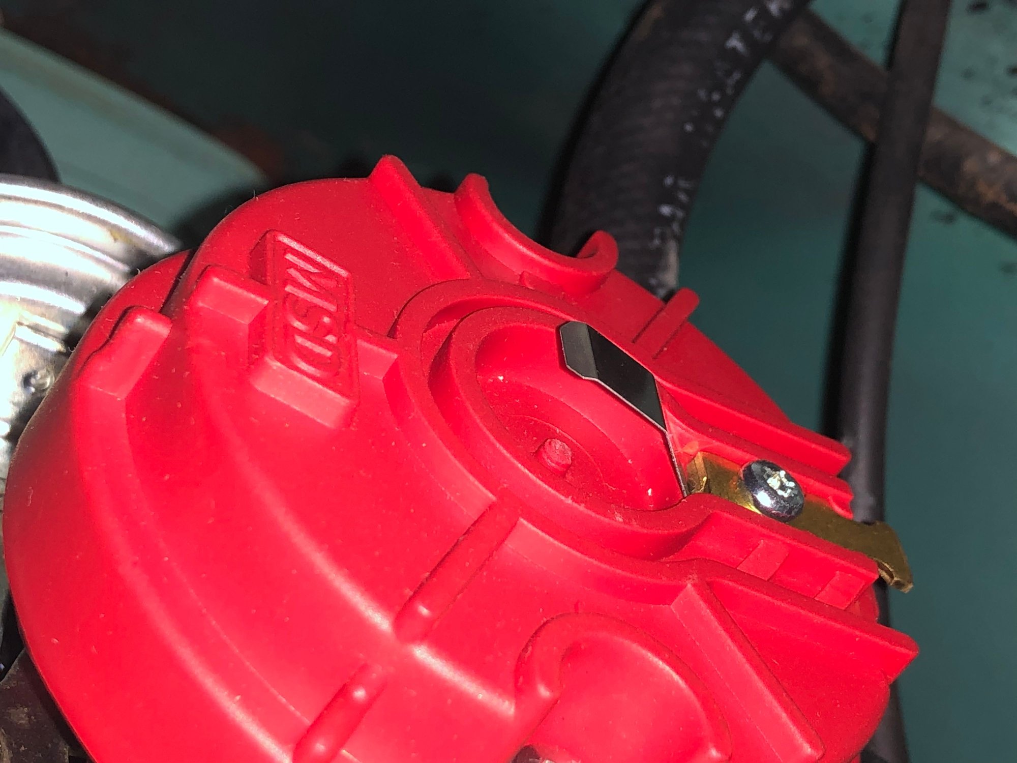

Hi there,
can you tell me is this distributor electronic ignition?
Thank you.

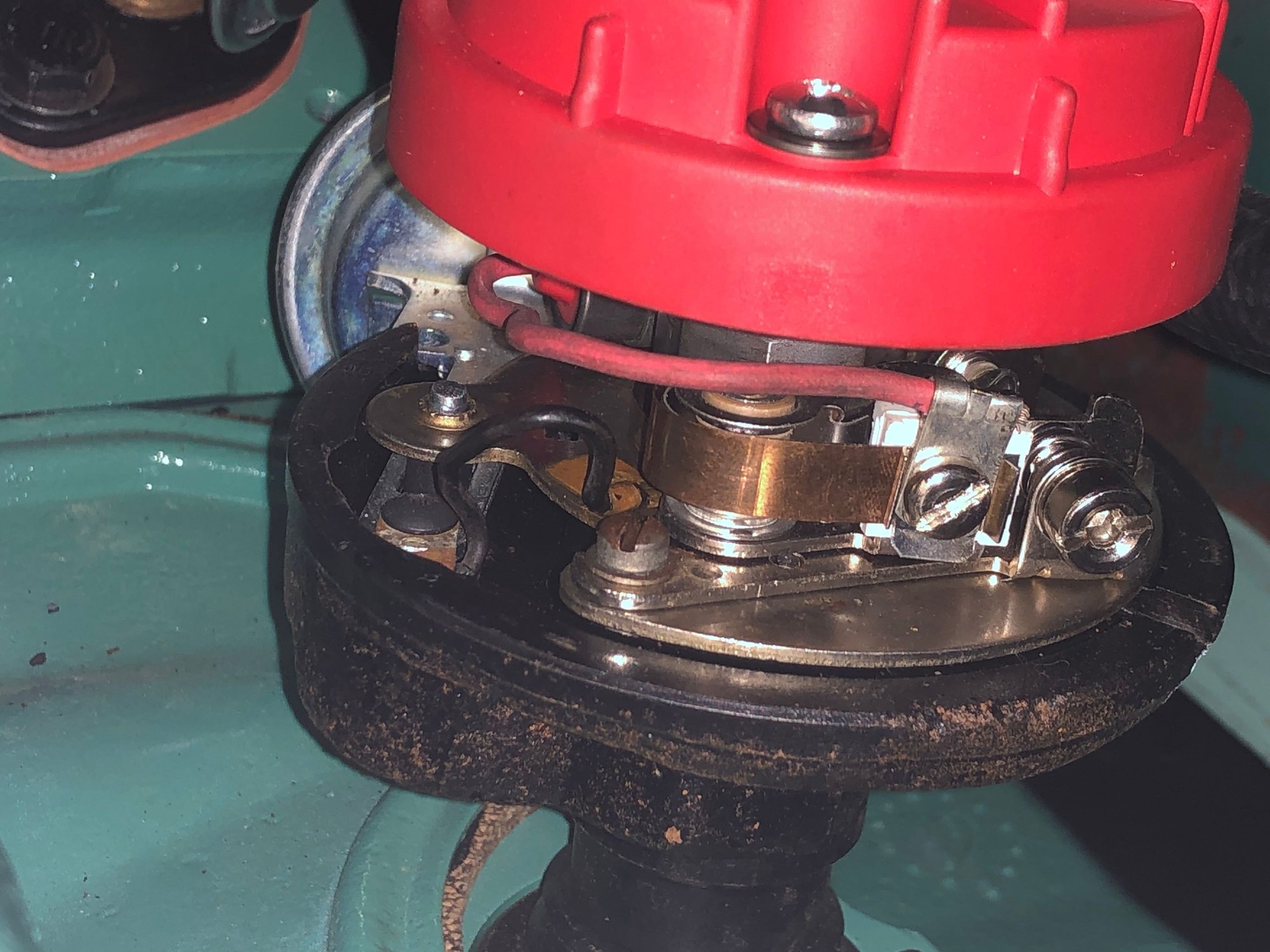

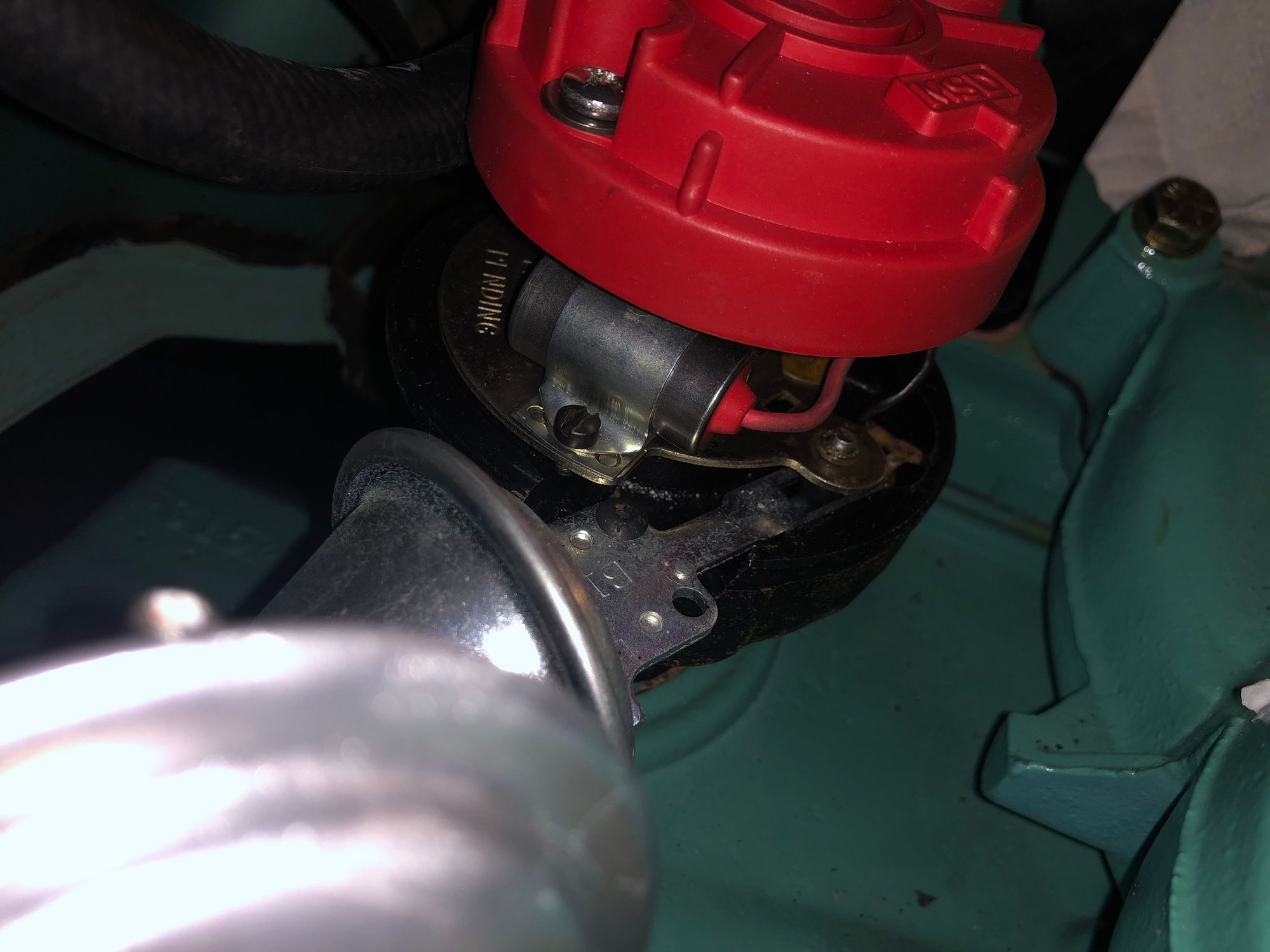

I see a points and condenser.
Pat

It is not an electronic ignition. It's a points style distributor with some aftermarket MSD brand parts added.

Some folks have used the points type distributors to trigger an electronic ignition amplifier which would most probably (but not always) be located somewhere in the engine compartment.
Thanks for that, yes I saw the MSD top thought it was electronic.
that’s interesting to know, I will look into that.
