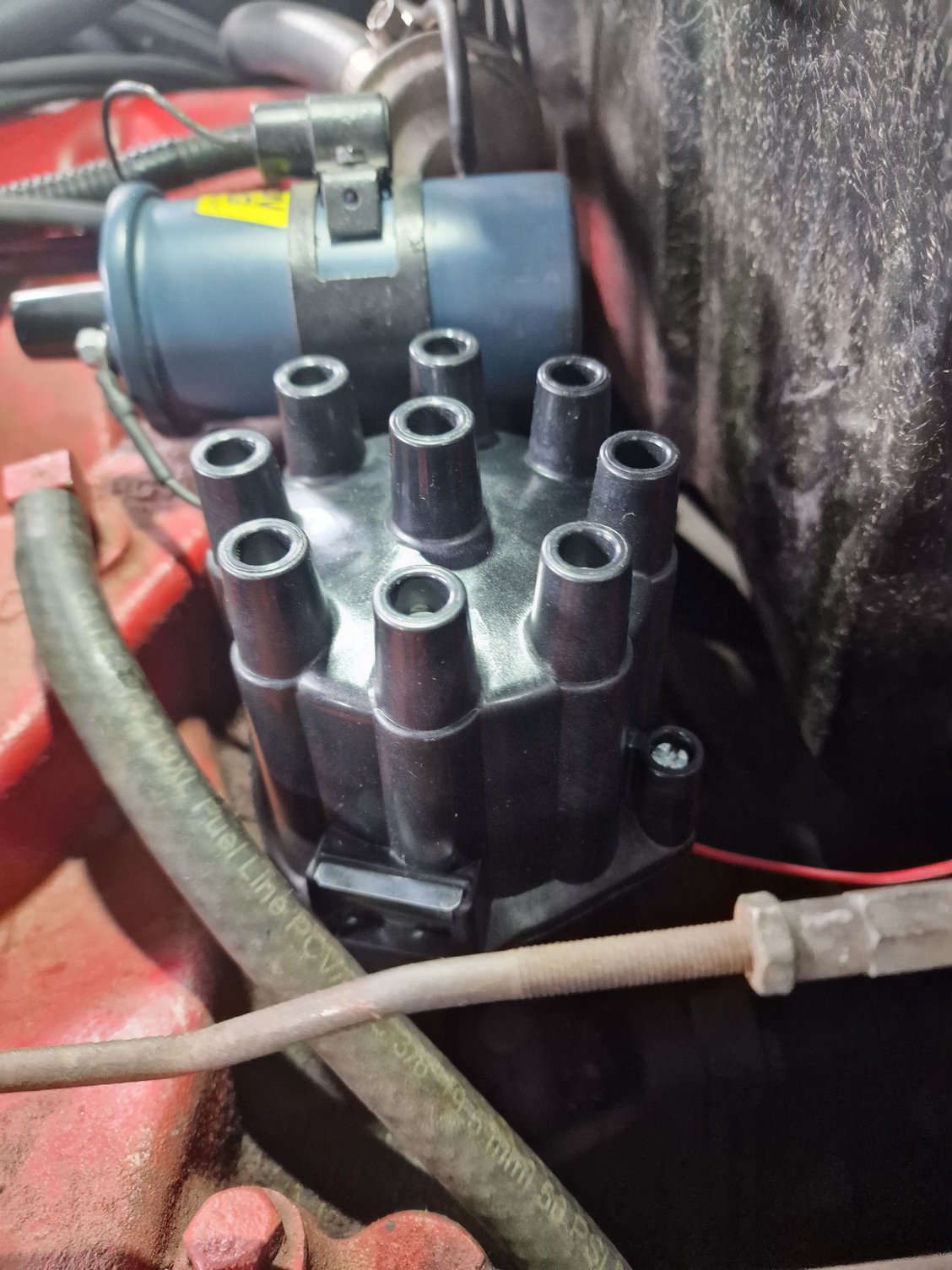

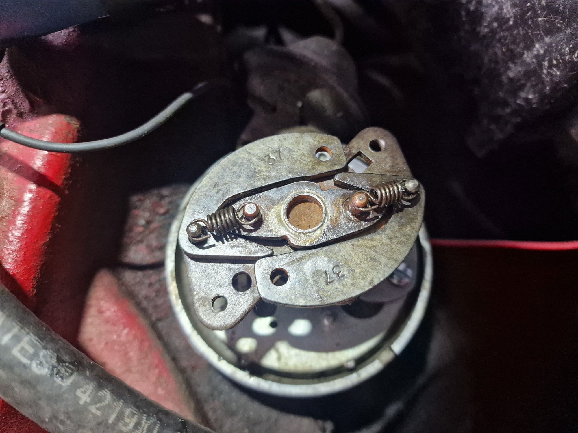

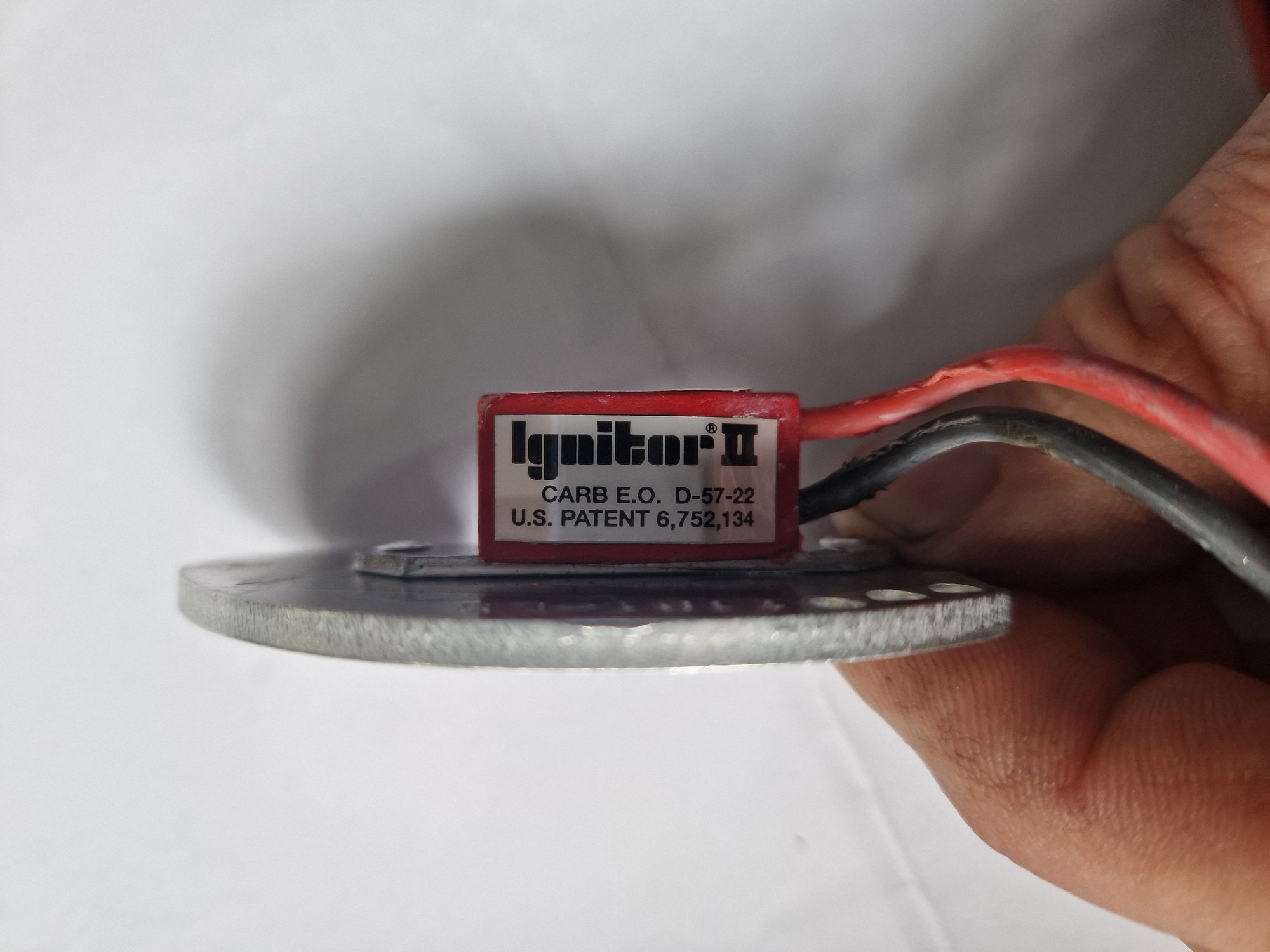

Hi guys,
wanted to share some great experience I made by having replaced the stock contact breaker ignition with an electronic one. Checking the different options, I decided to go for the Pertronix Ignitor II in the LS version. Advantage of the LS version is that you don't need to take out the distributor and unmount the gear.
With this device, you:
  1. can keep the distributor in the engine
  2. just remove distributor cover and rotor
  3. take out the original contact breaker
  4. mount the Ignitor
  5. Hookup the two wires to coil and ignition terminal (caution: the Ignitor must not be hooked up to a resistance wire but direct ignition voltage, but this is the same for all electronic ignitions)
  6. reinstall distributor rotor and cover
  7. and then you are ready to check/tune ignition timing
I was amazed how easy this worked and how reliable the ignition works since then (3.5k mls on the road during this summer). Okay, price is not cheap, but it was super easy to install, looks completely original, works like a charm and requires no checking/service/regular replacement at all. It really brings hassle-free driving to a better level.
I add some pics for illustration below.
Cheers, Steffen

Pertronix module
Pertronix module
side view
side view
Module mounted in distributor, no distributor removal or magnet ring installation needed (it uses the contact cam lobes for ignition timing)

Mounted cap (after rotor installation, no pic of that step)
Installation completed
