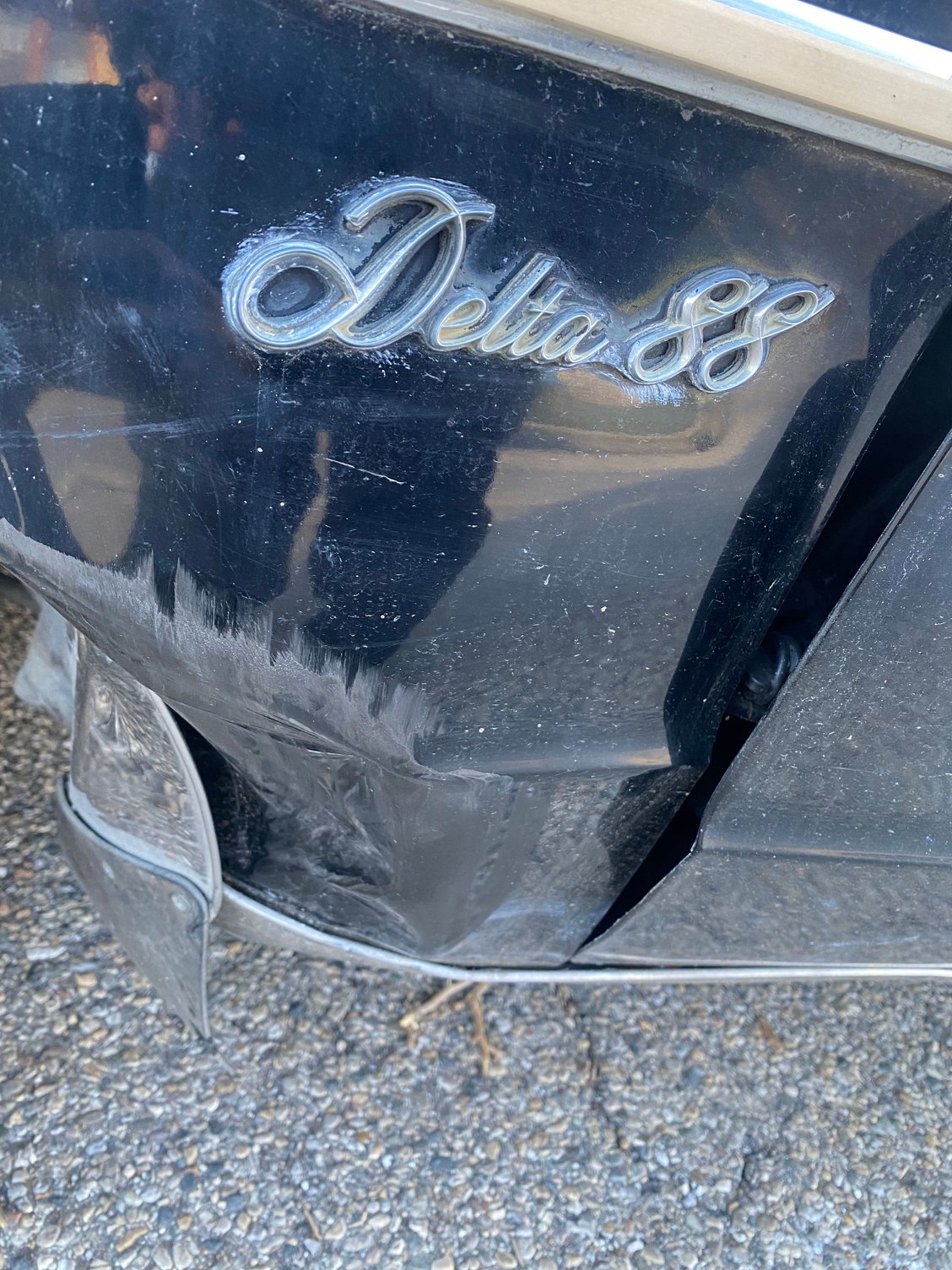

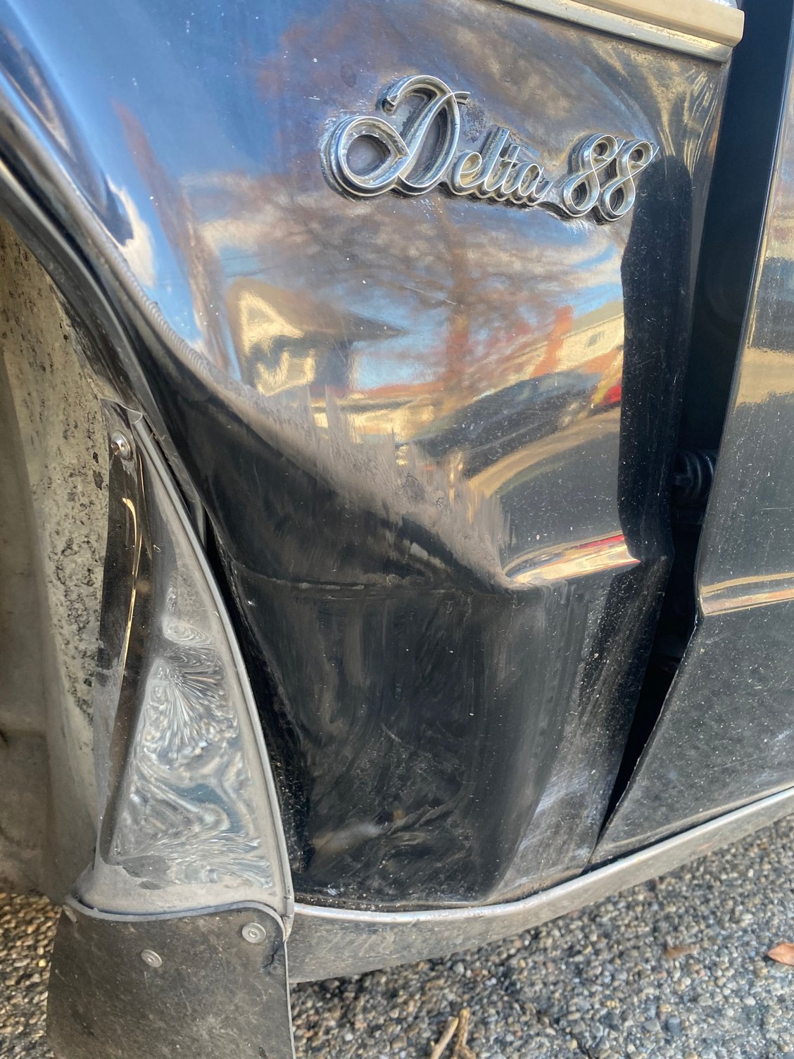

I put some 14” cutlass rims on my delta. There to small and it caused a rim to fall off. Do I am now looking for what the exact tire I need to use.
ouch thats sucks
if the rims fit on the studs then the bolt pattern is correct 5x4.75 as joe mentioned above (Standard equipment used a 5 x 4.75" bolt pattern with 7/16" studs.)
the rim may have fell off due to the wrong lug nuts, the lug nut needs to fit the stud hole taper to prevent it loosening up.
The overall tire diameter may have been smaller than typical but thats not why the rim fell off.
