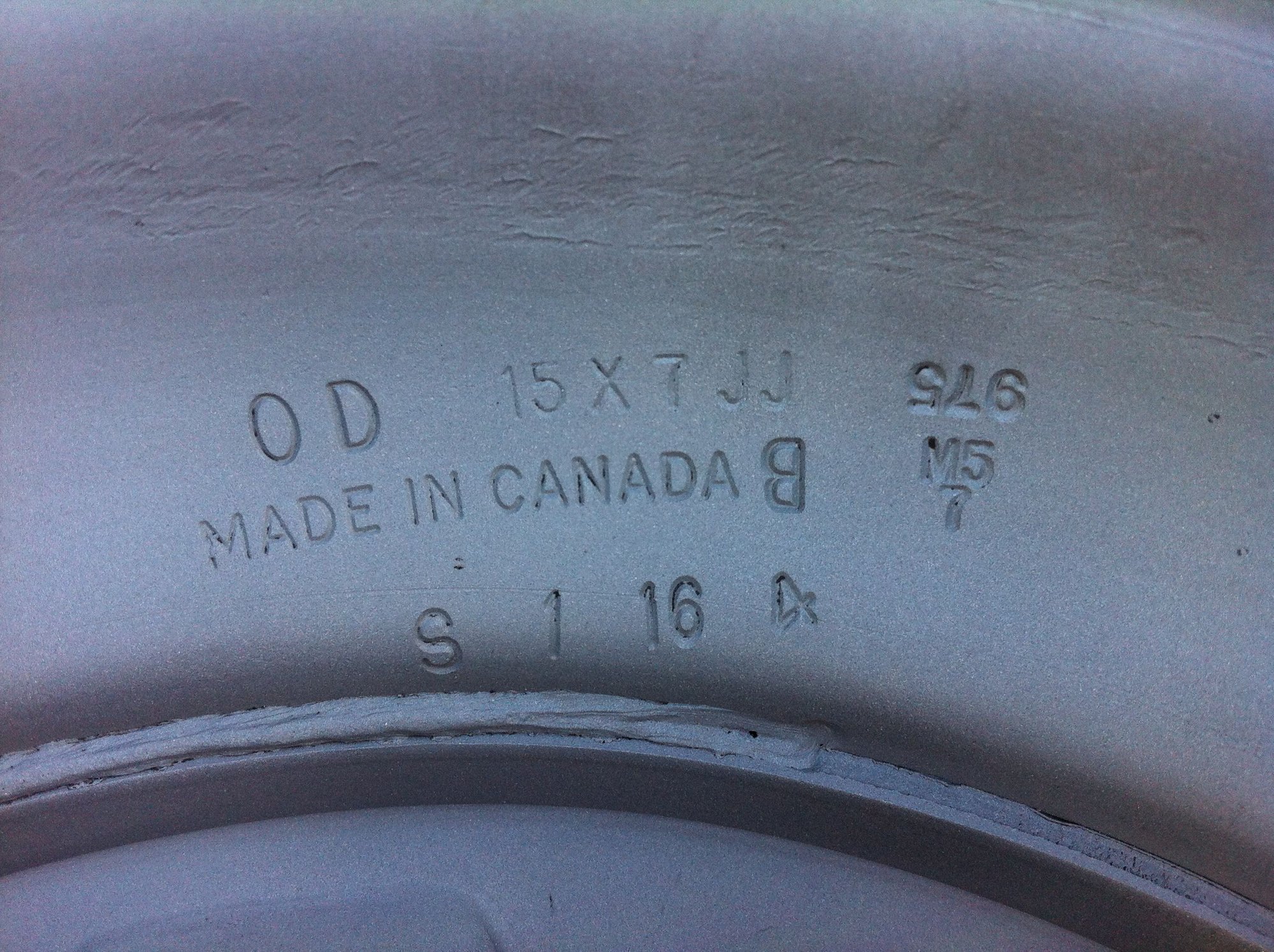

Here's the code stampings on one of my 15x7 wheels.
