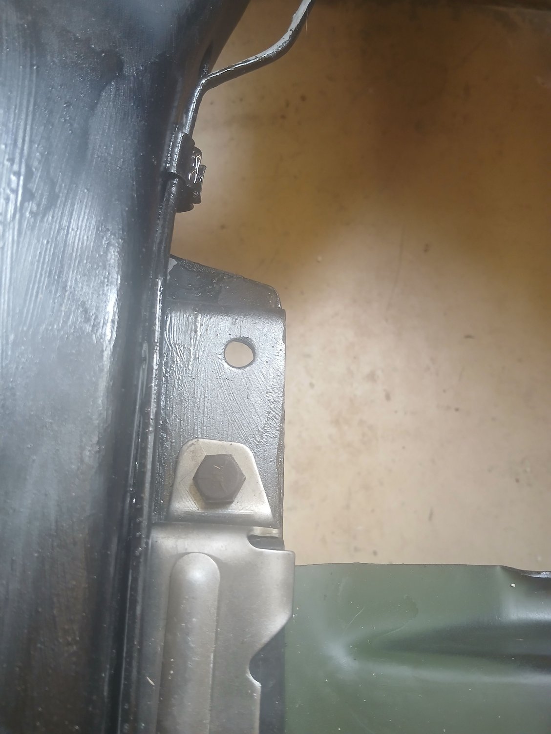

Also since mine is convertible have to move cross member back and weld in brackets further back to bolt the cross member brackets to, which I haven't done yet, see photos.

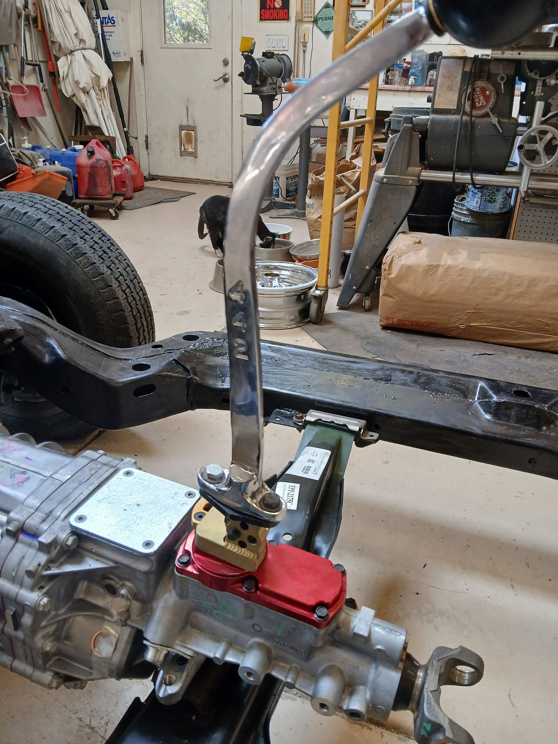

I'm posting this picture here for an awareness on what the proper TKX shifter location and setup should be for the 1964-1972 Oldsmobile. Having the shifter body on center with a 2-1/2" left offset handle receiver will not work very well in your tunnel or a console.

That is true for the 1964-69 cars, but for the 1970-72 cars with console you want the centered position for the stick. The non-console cars still use the offset stick.
Did you mean "will work very well"? That's what it seamed like you meant I may be off though
I was referring to the username "RAG" that his shifter setup on center will not work very well.
My 2-1/2" off center shifter setup "will work very well"!

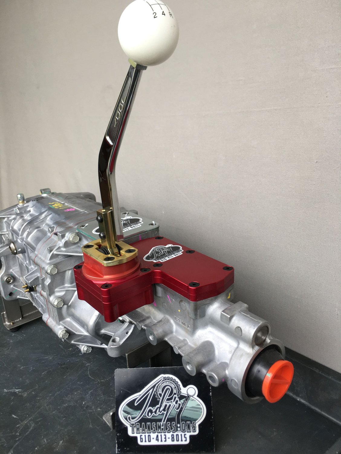

Joe,
These pics are just you and the 1970-1972 Oldsmobile crowd.
I was involved with the Legend LGT700 S07 (2-1/2" left Chevelle) and the S09 (1970-1972 Olds) models and shift postions.
Here is my offering for a TKX bolt on shifter for the 1970-1972 Oldsmobile to fit the Hurst 4 speed tunnel hump.
