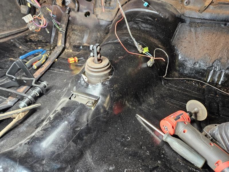

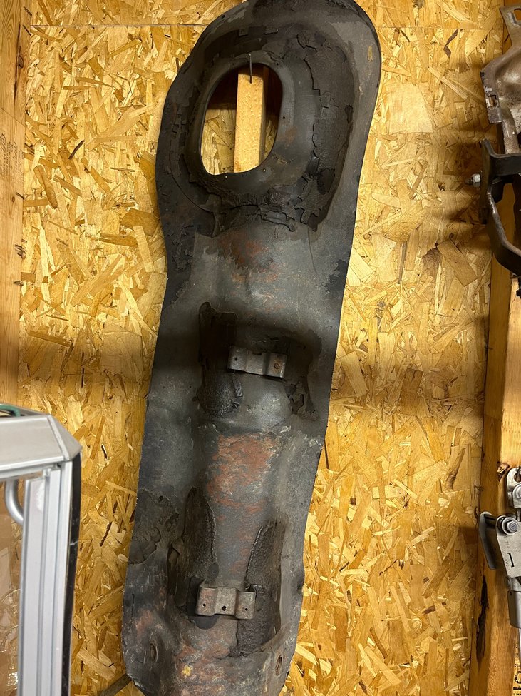

I installed a TKX in my '70 Cutlass and had to cut a hole to provide clearance for the back of the top plate, although mine didn't protrude quite as high as yours seems to. But my top plate is a different style and my car had been an automatic.
I called tech support at my retailer (Silver Sport) and he said it's not uncommon to have to do that. Ultimately that surgery is nothing compared to what's needed to fit a TKO from what I understand!
FWIW, you don't have a factory 4 speed hump in there, that's why you had to cut it.
The opening UNDER the 4spd hump is large enough for both sides of the shifter plate to fit w/o additional cutting.

You are so correct, adding the simple missing shifter hump could have saved the day here.
Not in this case, although the initial hole would have been bigger. Mine was a column shift to manual conversion and the transmission as received from Silver Sport had the shifter stub centered on the transmission. (This was before I was aware of offset options.) I tried fitting an aftermarket hump before cutting the full hole opening, but the stub location interfered with the hump and would obviously not work with my setup.
I converted an automatic shift console to the 4 speed version using the aftermarket saddle and boot, and the stub appeared to be positioned decently. The shifter handle SST supplied was my only beef - it was round and obviously wouldn't fit through the square chrome trim of the stock style boot. I initially used a Hurst 5387236 shift stick but found it too tall, not enough lean back or offset for comfort but it was usable. Switching to a Hurst 5387436 handle addressed my issues and I'm happy with the setup now.
I'd imagine an offset adapter like Jody's would facilitate a more stockish appearing installation, work well with a hump and work better with an original shifter handle.
Oh, and now I have an aftermarket hump for sale :-D
