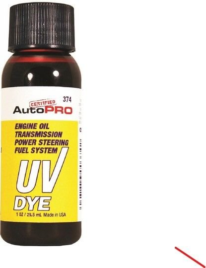

Try to identify source/location of leak. Add a little fluorescent dye to the ATF, take for a ride then visualize w/ a (UV) black light. Most automotive parts/supplies stores sell both the dye & a small pen light flashlight. A small 30mL bottle is ~$8.00 - $9.00. Ensure it's dark outdoors/indoors when visualizing with a UV light source. Tell-tale traces of dye will show up at the leak source.
I bought and added some of the UV die last week but it drained so much ATF that it didn't help.
