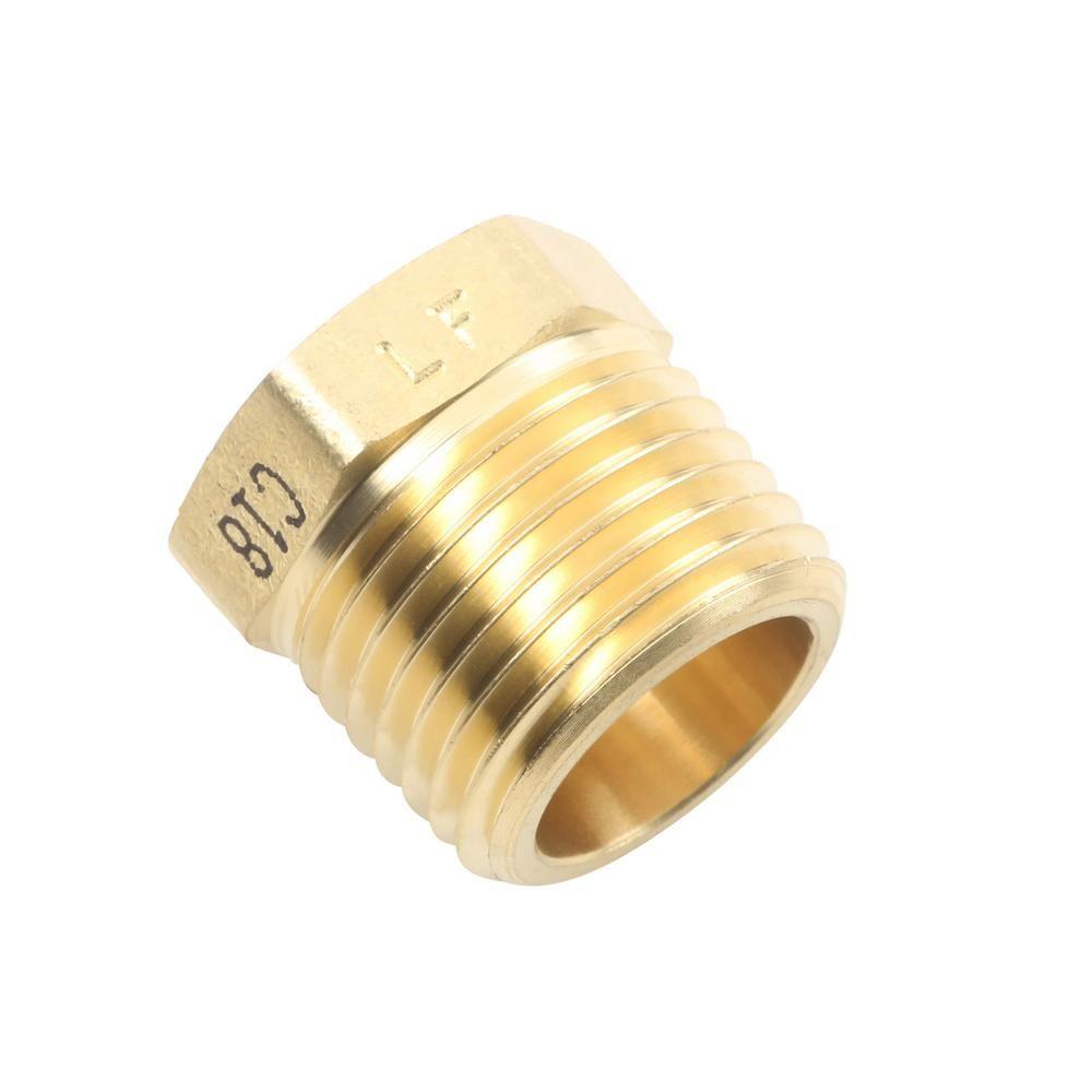

The sensor on the trans should be 1/8 pipe thread. You won’t lose very much fluid when you remove the switch.

This may help. I removed my DVCS ('71 CS 350) - Standard Pipe Fitting (you can get it at Ace Hardware).

Thanks everyone! For some reason I didn't get notifications of the replies. I have the 1/8" plug (brass was all I could find) so I will get that done and hopefully stop the leak. I will get the rest removed soon too.
