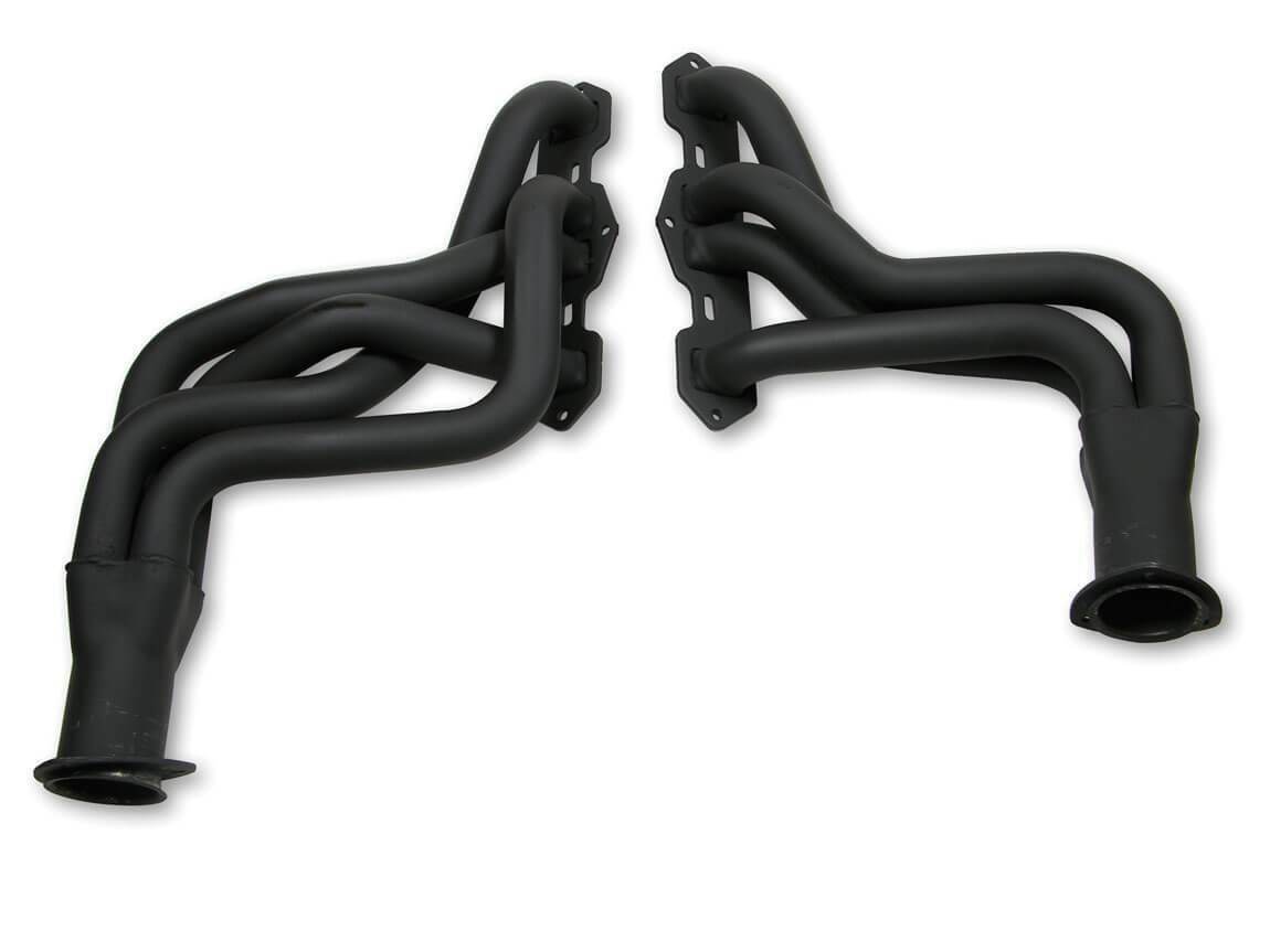

I think you are optimistic. "Good" exhaust shops are few and far between these days, and the parts-changers who work there are unlikely to have the first clue about how to fabricate headers. The few exhaust shops who still bend their own tubes do not typically have mandrel benders, and the traditional crimped bends used for exhaust systems will not be suitable for headers, and are unlikely to even be small enough radius. I also doubt they would have the first clue about selecting tube diameter and length to flow properly, or the skill to route primary tubes with near equal length. Heck, most actual header manufacturers don't have that skill, as evidenced by the commercial headers that use obviously unequal primary tube lengths.
These Flowtech headers are possibly the worst "full length" headers I've ever seen as far as non-matching primary tubes (and you know not to get me started on shortie headers... )
