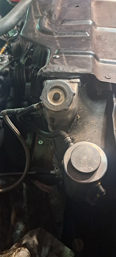

Pretty much everything I can do till push rods show up, is done. Lower rad hose is tight, rad, electric fans in place along with trans cooler lines.

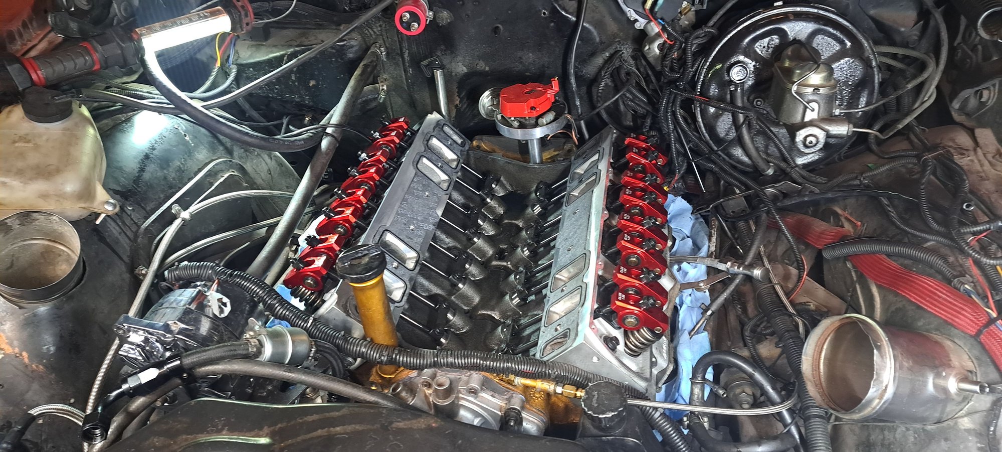

I removed all the spark plugs with the intake off, I installed the push rods and rocker arms. I did a quick bare hand tighten to the rocker arms and started doing a compression test. Kept tightening any loose rocker arms lightly as I cranked it over. I was very happy with the numbers vs the non advanced Performer flat tappet cam despite a slightly lower compression and higher duration hydraulic roller cam. It goes as follows #1-180, #3-180, #5-170, #7-180, then #2-180, #4-180, #6-175 and #8-170. It is a nice improvement, was actually expecting a slight drop considering I am at 9.28 to 1 according to the Diamond compression calculator. I was at 9.6 to 1. Here are the old numbers, gained everywhere but number 8 which was the second highest, now the lowest cylinder, tied with #5. Will crank it over some more, check lash, then do it few times, then lock the rocker arms in place and put it all back together.

It’s not lash you’re setting, it’s preload. I’ve never seen preload set like that. you’ll have no idea where each lifter is preloaded at now.
didn’t we explain how to set proper preload on those comp hyd rollers a while ago that you were in on?
I give up
Yes, I have just eliminated so the plunger isn't depressed but I can spin the pushrod without moving it up or down with the lifters off lift. I should have not said I was done and ready to put back together. I have the dial indicator and base. So I measure one to .040" plunger down with the cam off lift(TDC) and turn the rest the same amount as the first one actually measured? The 40 on here correct?

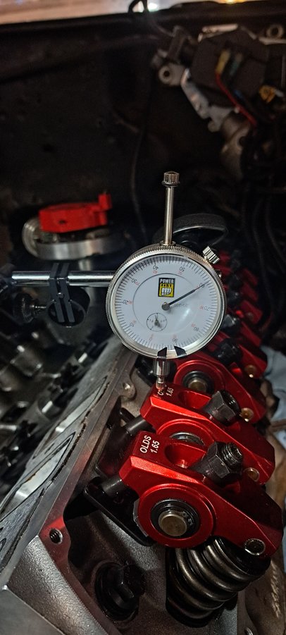

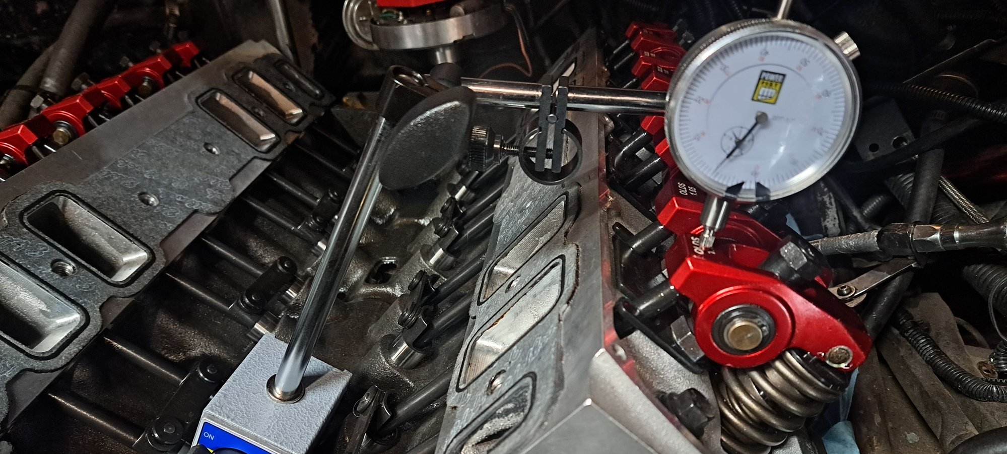

I quote Dale here. they should also never be run at zero lash..they are very specific about the preload range, .040” is ideal
do the preload by using a dial indicator at the tip of the rocker on the pushrod side in-line with the pushrod. figure out how much rotation of the adjuster is need to compress the lifter .040” from zero lash. then do all the others by the same rotation of the adjust after zero lash at TDC firing. you only have to use the dial indicator on one to figure out the turn/depression set up for yours
there are way to many rocker ratios and stud thread combinations to get the .040” preload by using the common turns past lash set up….even though in the latest instructions they tell you to go 3/4 turn for 7/16 20 and 1 turn for 3/8 24 studs.
Old Apr 21, 2026 | 11:16 AM
  #211
olds 307 and 403's Avatar
Out of Line, Everytime😉
Posts: 10,110
From: Melville, Saskatchewan
It ended up being around one turn in from zero lash. I set them all the same amount, valves should be set. Now it will start to go back together. Thanks Mark and Dale for the help.

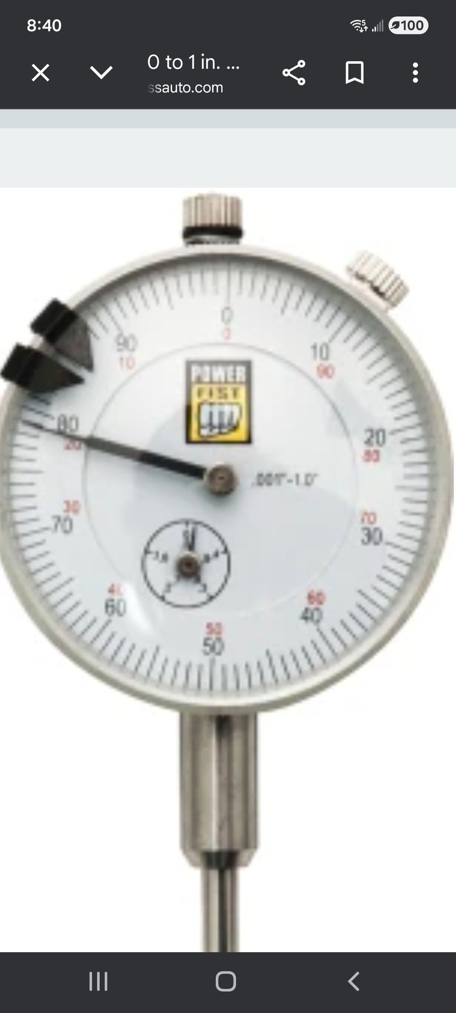

I've never done this before so this may be a dumb question, but shouldn't the dial indicator plunger be in-line with the pushrod to get an accurate reading of the pushrod movement?
Good question, see if any of the engine builder's respond.
I would think so.
You posted Dales recommendation....
"they should also never be run at zero lash..they are very specific about the preload range, .040” is ideal
do the preload by using a dial indicator at the tip of the rocker on the pushrod side in-line with the pushrod"

Well it didn't matter, the rocker arms were binding on the studs, not an accurate reading. I had a brand new set of BBC ARP 7/16" rocker studs. A bit shorter and less abrupt stud base. I got the valves lashed. Fired up right away, sounds good. I had antifreeze leaks in all the weird places. I finally got the water pump sealed, it helps tightening the bolts, had to do it multiple times to seal. It also leaked at both of the pipe plugs and the sensor in the AMC thermostat housing in the new 7111 intake. I actually may skip the vacuum advance or have to dial it way back, this canister has about 30 degrees. I thought I pre adjusted it, didn't like 53 degrees at idle, had some pinging. Plugged it off, I have the base timing set at 17 degrees at 1000 rpm, 14 at 750 at 750 rpm. I revved it to 2500 to 4000 grand, most I saw was 40, locked it in there. I have mid-high 13's AFR at idle. It isn't charging, I see a wire pulled out of the the little plug in regulator. Snow and mucky out, not in a hurry to take it for a drive. Once I fix the charging, may take it for a rip.
