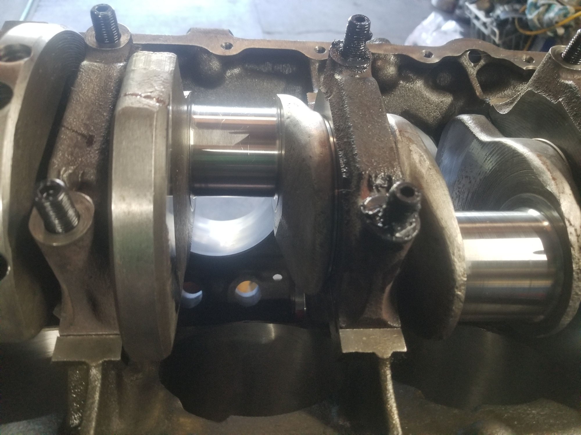

As I mentioned in my 1970S thread, I measured a couple of rod and main bearing clearances. Using snap gauges and a 2" to 3" micrometer, I calculated .0026" rods and .0028" mains. At the high end of Cutlassefi's recommendations, much better than too tight, it should provide good oil pressure with 10W30. It was another busy week with an emergency heater fuel fill yesterday, I finally got back at measuring and filing cylinder #1 ring gaps. The compression rings were both .006" out of box. The oil rails and corrugated ring was around .025", so no issue. I went slightly more generous on top ring gap at .023" and .025" for the second gap. This is incase the maybe 400 HP/400+ Ft/lbs of torque isn't enough and I want to add something like a torque storm down the line. I am not assembling this until after the spring melt and the humidity goes down. This ring filer was easy to use, just took my time, filed then measure and repeat. I need to buy some more small files to remove the sharp edges, my new set has gone missing. I also picked up a new feeler gauge to replace my worn 25 year old one. More to come over the next few weeks and months. Like may of us, waiting on Edelbrock to release their new SBO head for this build.

I have never felt comfortable using snap gauges for bearing clearances. I dont think you can get closer than .001" with them but I might be wrong. Just for grins when you start assembling try the method show below with a .002 and a .003 feeler gauge. Put the feeler gauge in and torque the cap. If your measurement is right you should be able to pull the .002 out easily and the .003 should be pretty tight. You can only do it on the #1 main but it is a good quick check for guys that dont have bore gauges.
I agree Bill, it is tough to get an accurate measurement. I did it multiple times, it liked to unlock, was kind of a PIA. I will definitely try that, thanks.

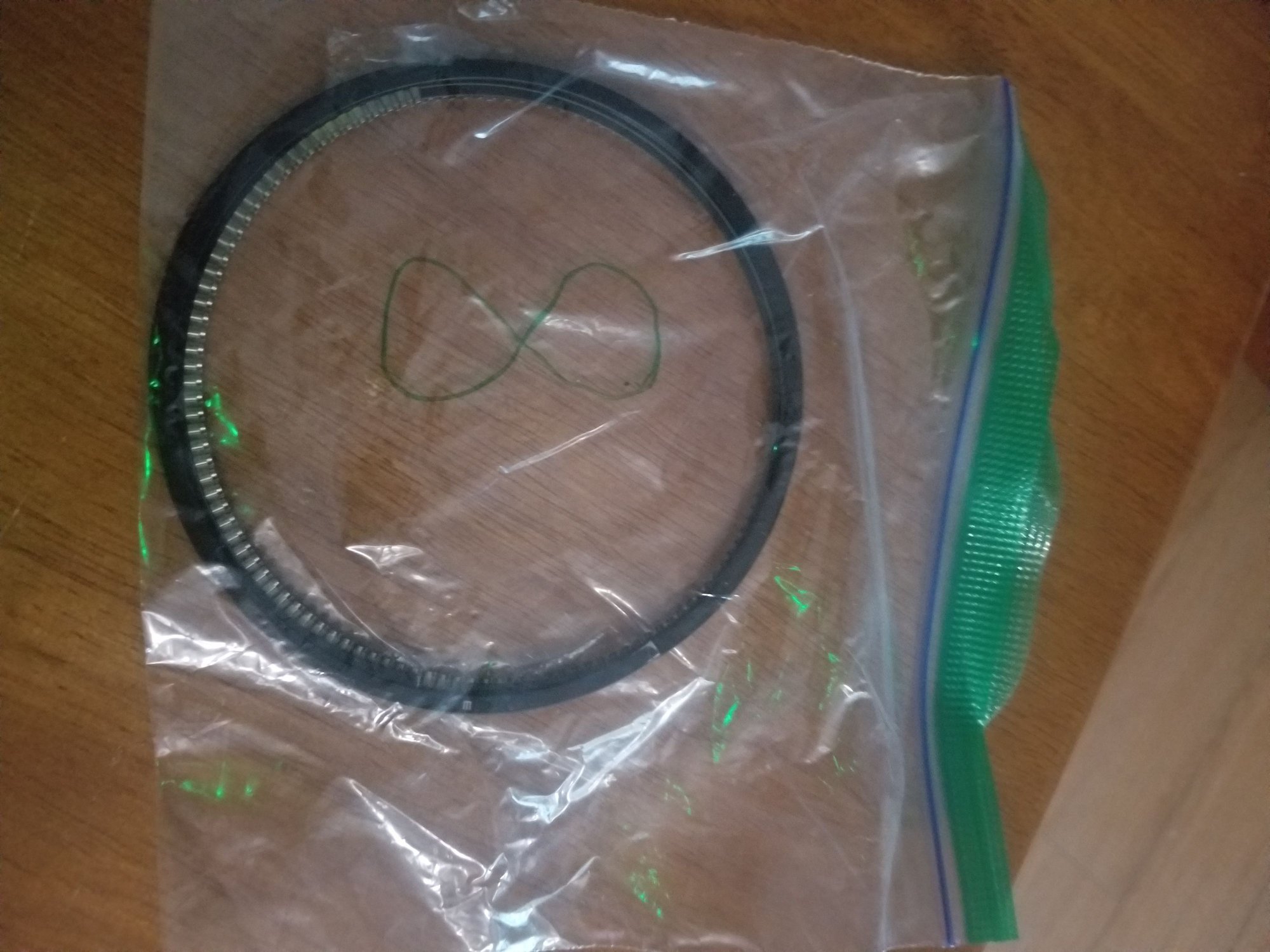

So I painted the non Stainless 3/8" flange on the full length Chinese Stainless full length headers with VHT high temp aluminum paint to go on this motor.
I also finished filing the rings for the rest of the cylinders. We got close to another foot of snow. When that melts and humidity drops, I will start assembling the short block.

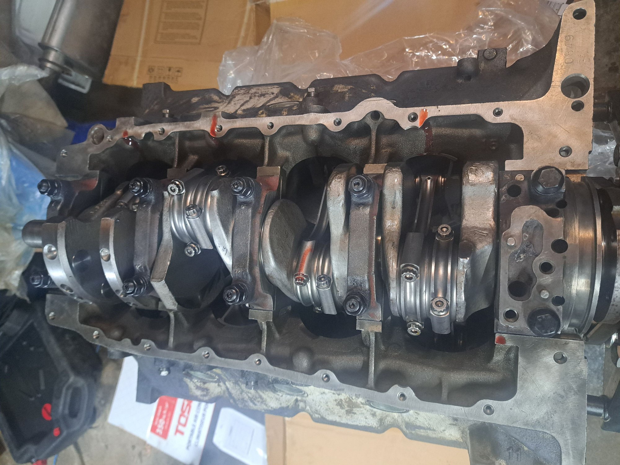

All surfaces cleaned and main bearings are in the block with Permatex Ultra slick applied before carefully placing the 330 crank in place. The bearings are also in the align honed main upper caps.
Old Jul 15, 2022 | 07:43 AM
olds 307 and 403's Avatar
Out of Line, Everytime😉
Posts: 10,101
From: Melville, Saskatchewan
Ok so I lubed the tops of the bearing caps the same way with Permatex Ultraslick. I tapped the caps all into place. I trimmed off the ears on the AMC 258 main seal, lubed with ATF installed with the groove towards the motor and two small dabs of The Right Stuff. I set the thrust bearing by tightening down the center main bolts with a ratchet then backing off to finger tight. I then spun by the crank by hand tapping back, then foward with my plastic 2 pound dead blow hammer. I then torqued #3 to 80 ft/lbs with ARP lube on both sides of the washer and threads, along with all the mains. I then torqued the rest of the mains to ARP torque specs. The crank spins very easily by hand. I measured .008" for thrust clearance. .007" is loose and .009" is tight.

The crank spins very easily by hand. The way it should be! Nice!
