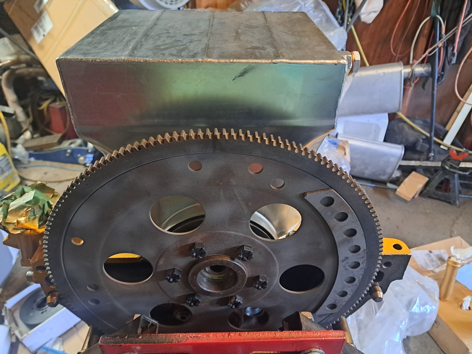

Yes, Mark correct on bearings. Painted the block VHT Metallic Gold, installed the blasted flex plate and bolts finger tight for now. I will be using the pan mounted dipstick option on the Canton.

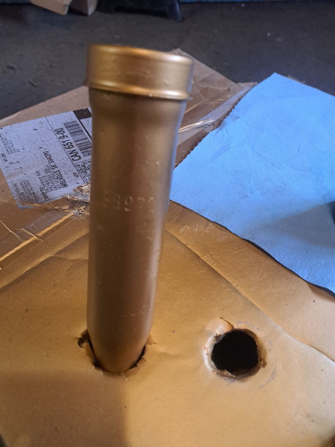

Old Aug 27, 2023 | 05:04 PM
  #56
olds 307 and 403's Avatar
Out of Line, Everytime😉
Posts: 10,104
From: Melville, Saskatchewan
