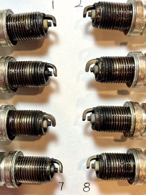

Thanks for the suggestions. I pulled the spark plugs back in January and cylinder#3 looked a bit fouled. Cylinder 3 is on the LH bank which has the hard exhaust pulse. What's the best way to check for a misfire? Bad plug wire? what else should I look for? Here's a pic of the plugs from January. I cleaned and reinstalled the plugs with a new O2 sensor and the car ran better but still not right.

Old May 27, 2025 | 06:52 PM
Sugar Bear's Avatar
Posts: 4,110
Do a compression test.
