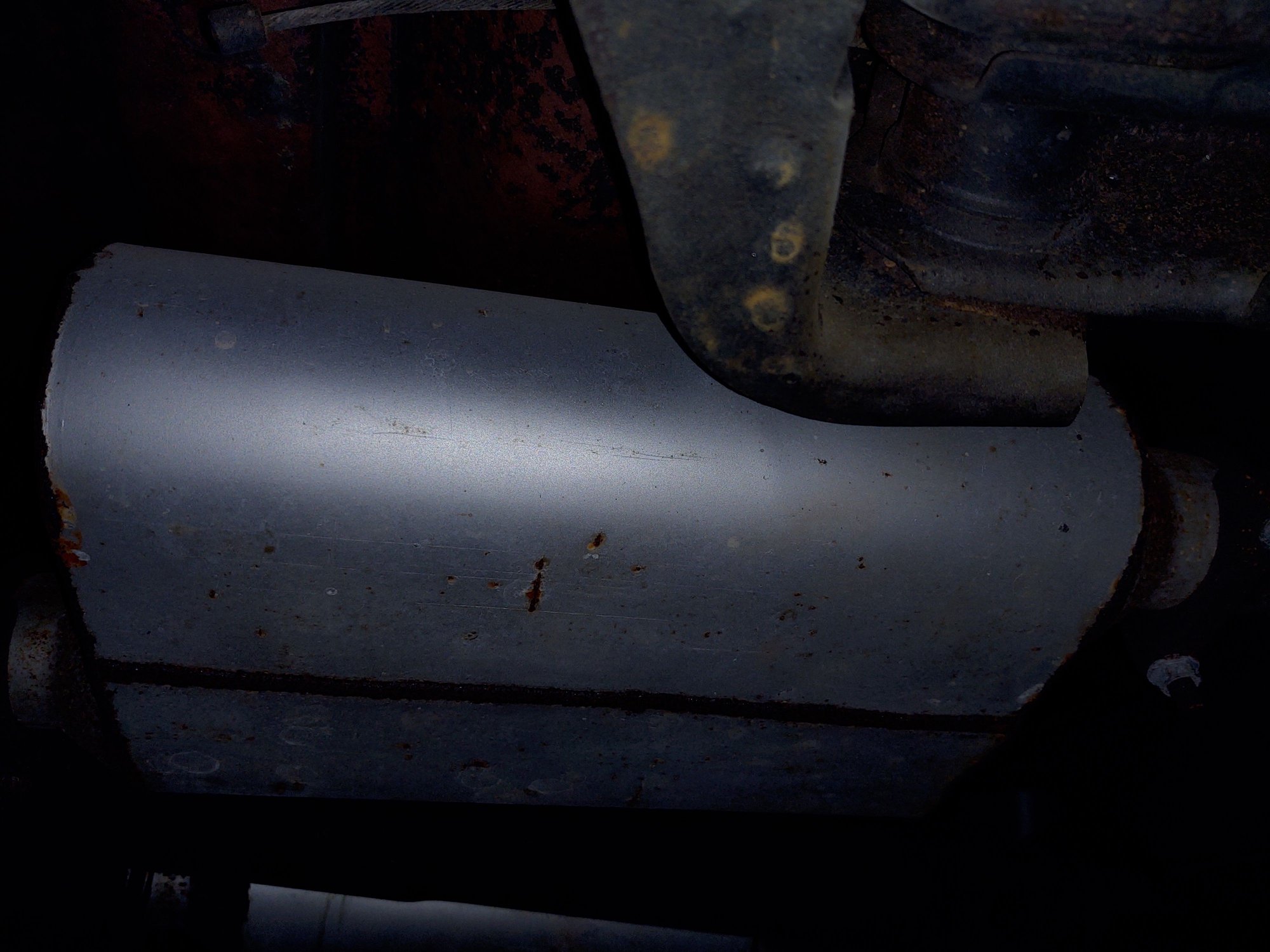

Just out of curiosity, can anyone ID these mufflers? They are on my other 71 442. The one I am second and fourth owner of. The third owner put these on while he had it. Originally I put the Walker muffler for OAI 442s on it and really liked the sound of those, but I've been unable to find the part number for those to even start looking for them again. The mufflers in the pictures are approximately 14" long, sorry didn't have a tape measure handy. Thanks again for all the help!
